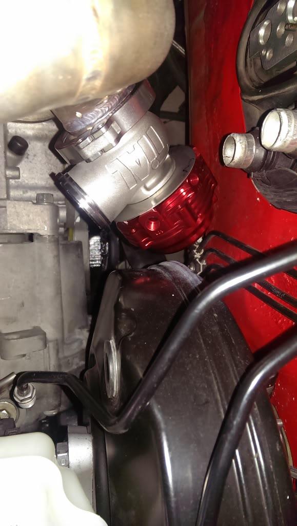

Your project is above and beyond normal car enthusiasts territory, but i'm a bit puzzled as to why you would fit a forge DV?
OEM works better and doesn't need to be maintained  :happy2:
Over the top mod list ;o)
You got me there  :confused: It's the first time to hear that the OEM is better  :smiley:

oem is loads better.... sorry to say..
fantastic build though, you are a master  :rolleye:

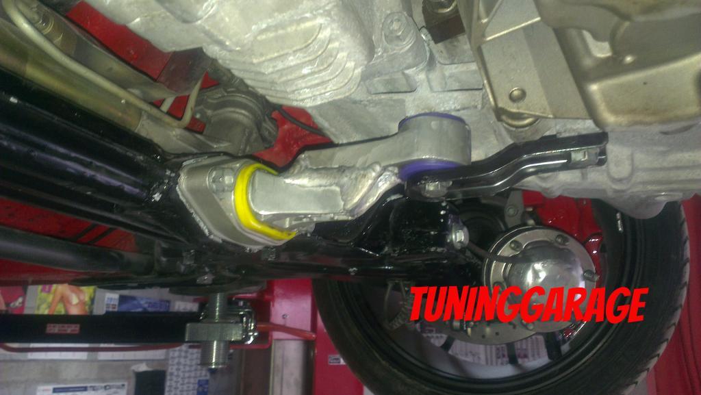

When looking at the pictures of the engine after the new mounts i notice that it's tilted quite a lot backwards, have you had any considerations as to the function of the oilpickup? Hopefully you won't get oilstarvation  :confused:
Offline 2fast4you
  • Posts: 153
  • Some drive to work... I work to drive!
Re: Golf Rallye 2.0 TFSI + Haldex 2gen
« Reply #201 on: May 31, 2013, 10:50:39 am »
The lower engine mount is not attached  :smiley:

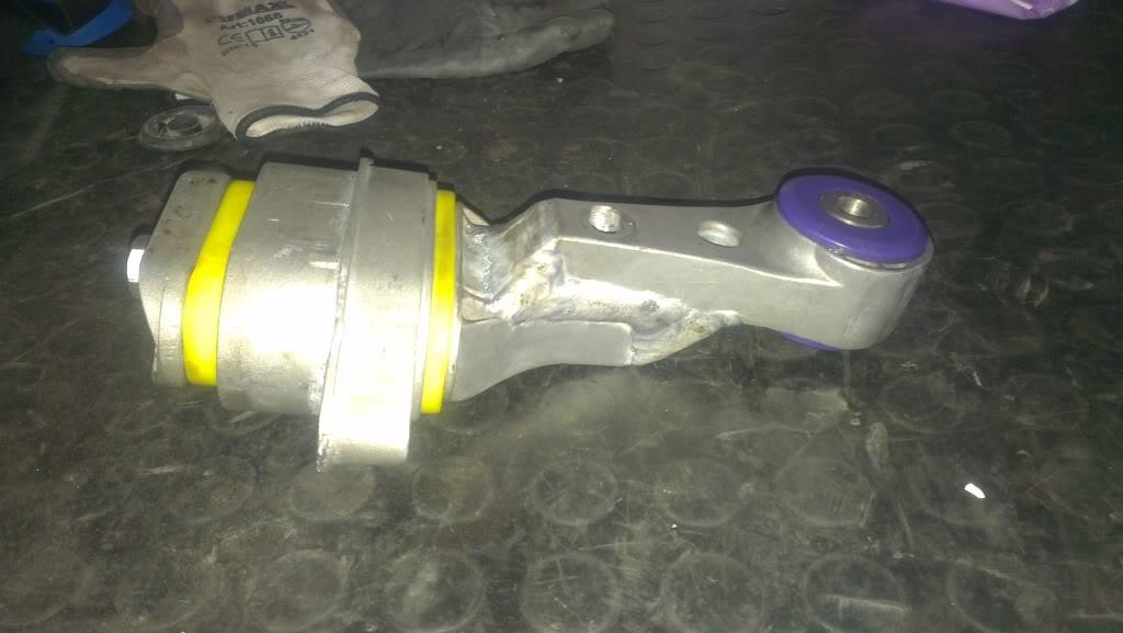

It needs to be shortened and it needs to go up a bit. Because I'm using the MK4 lower mount and it comes in two pieces, I want to take the Arm piece and design it how I need it to be, than take it to be made on CNC (one strong piece) Just tired of welding  :innocent:

Instead of CNC I decided to try the cheaper way  :P
a friend who welded this sad it would newer breack ...but we shall see  :drinking:

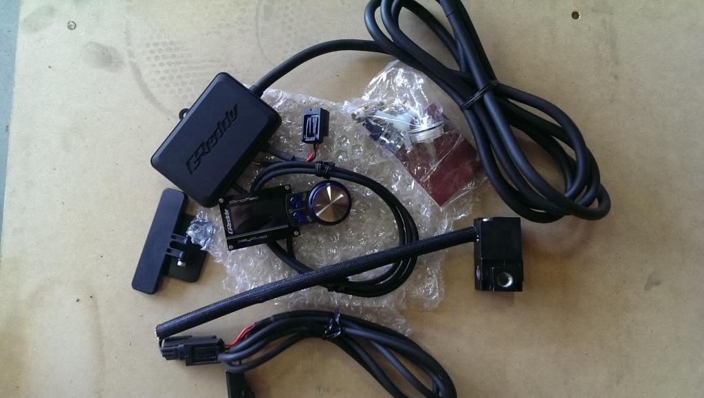

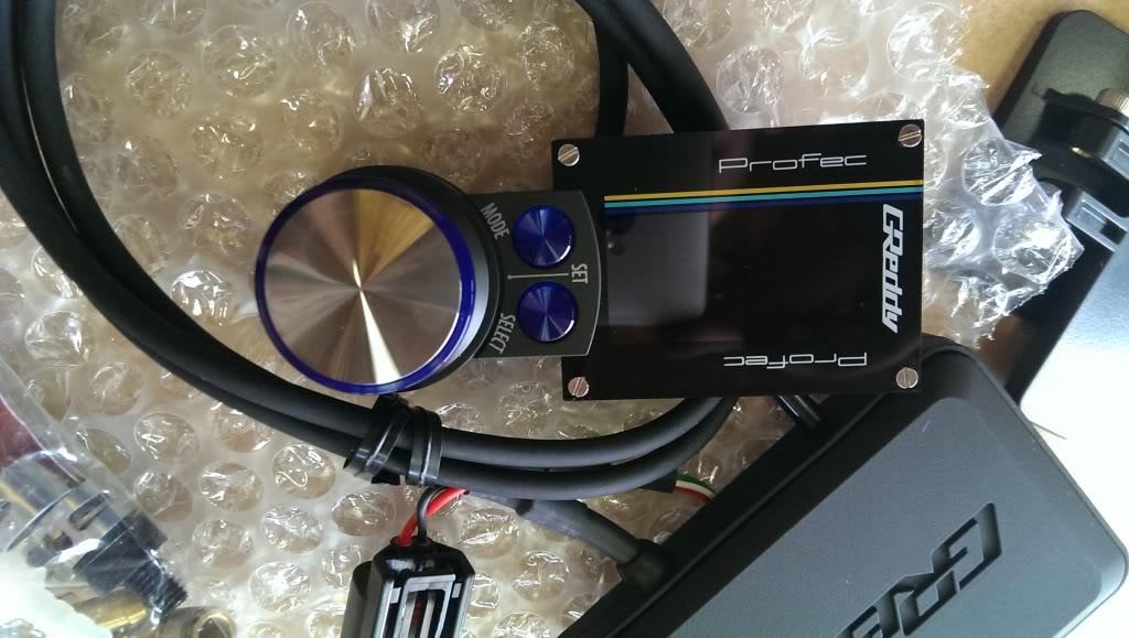

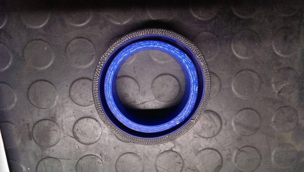

Greddy Profec Boost controller

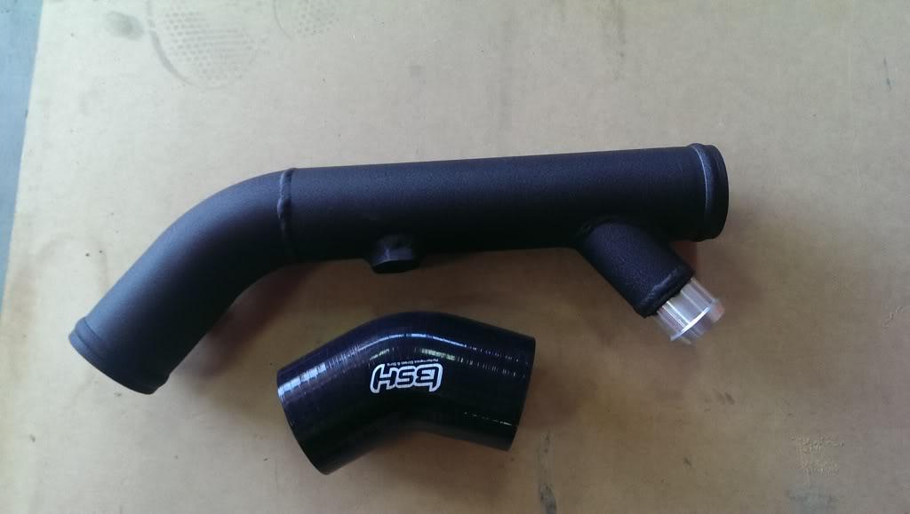

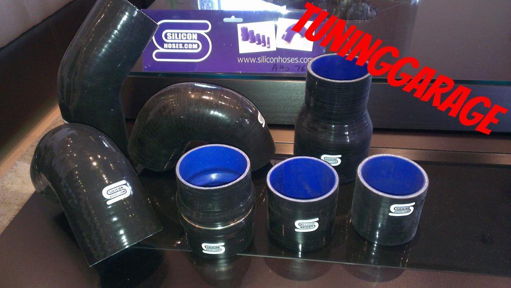

the return pipe from the IC to the TB is a f63 but i decided to make an F70 one because the exit from the IC is F70, and in the future I plan on getting an F70 TB so...

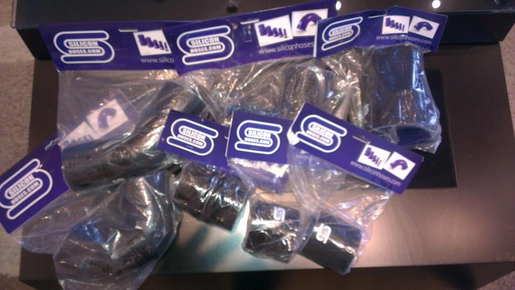

Siliconhoses parts

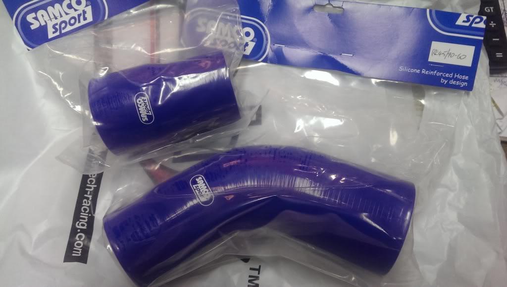

I also ordered some parts from Samco that this firm did not produce

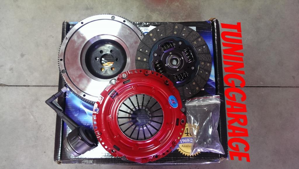

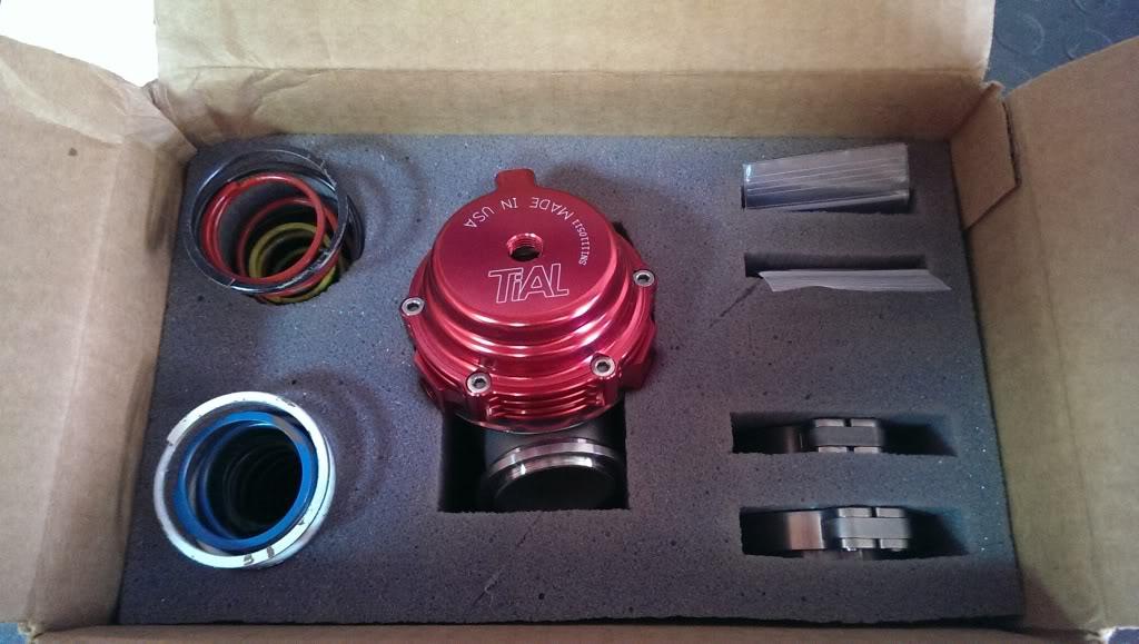

and finally the clutch and the 38mm wastegate are here in my hands
and I cant believe the quality difference between Samco (blue) and SiliconHoses (black)
the pipe from the turbo to the IC fixed

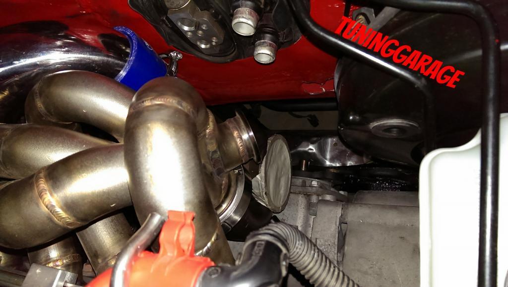

and the thing bothering me for so long :banghead:

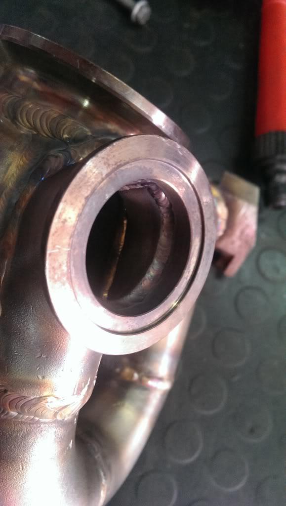

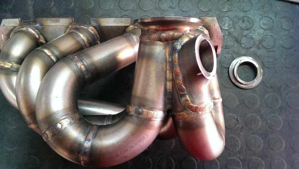

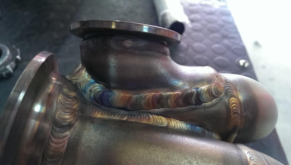

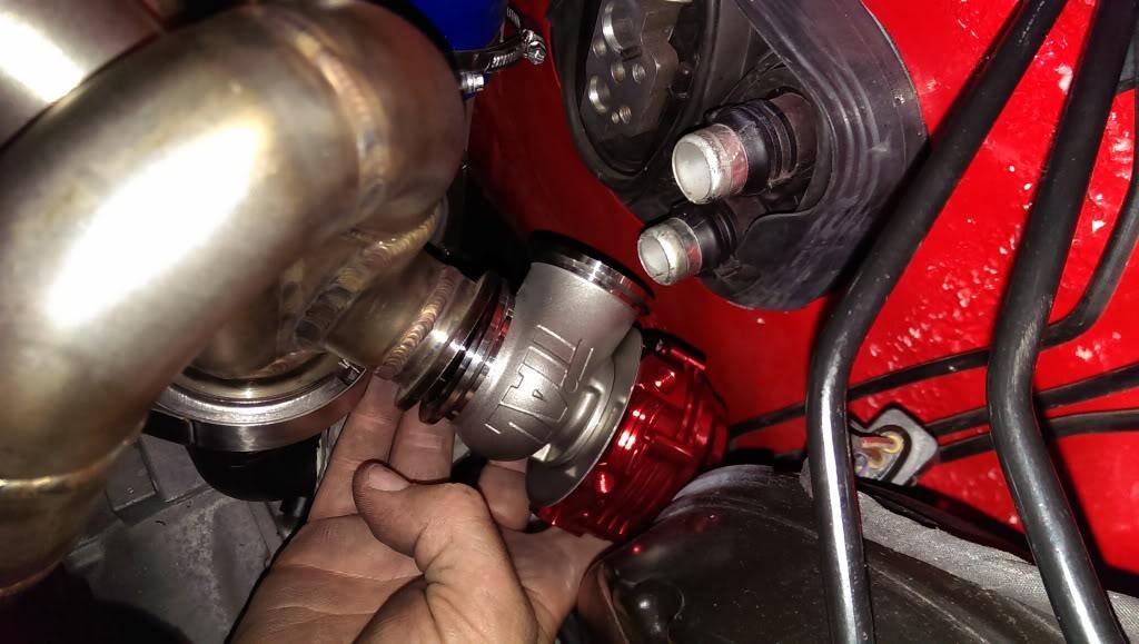

no room for the wastegate but i put in a smaller brake booster (golf mk5 R32) and now there is a bit more space.

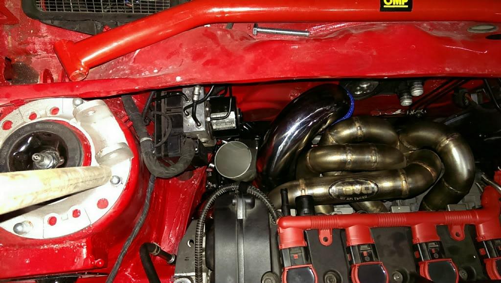

but I still had to redo the manifold:
and welded
and:

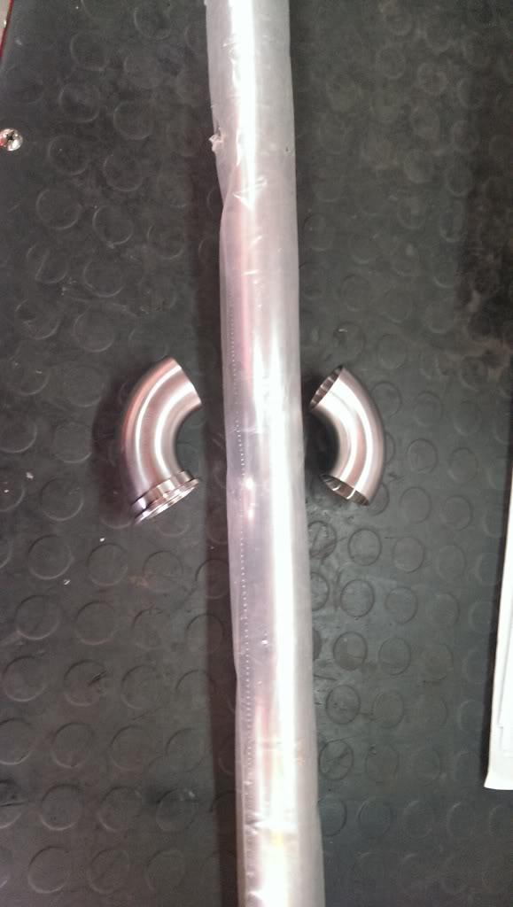

also bought parts for the scream pipe
so we'll see what happens  :jumpmove:
