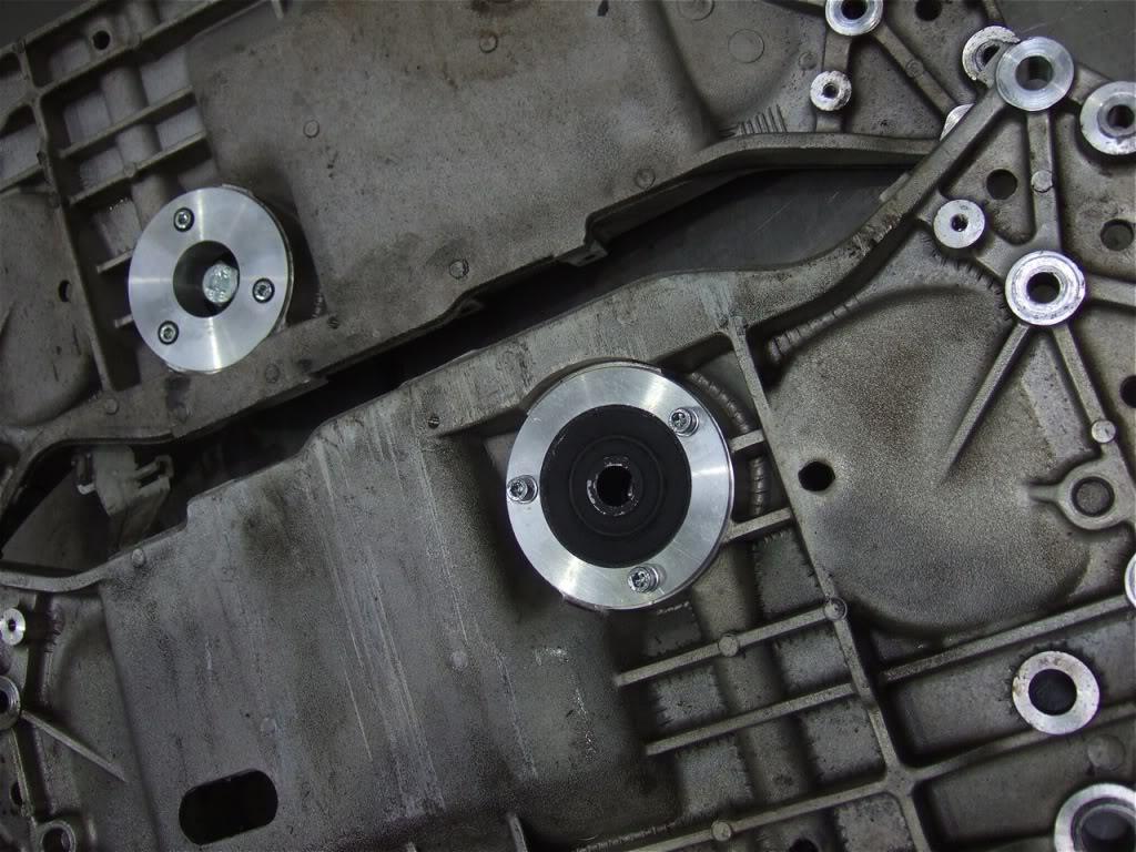

Subframe is the giant bit of metal it fits into, you've shown a pic of a subframe off the car above.
Sounds like its working well, has it passed the acid test for wheel hop??
Sideways yo!
  • -Given: 380
  • -Receive: 442
  • Posts: 16628
Re: VWR Dogbone 'Fast Road' Engine Mount - Review....
« Reply #8 on: May 29, 2009, 12:10:18 pm »
This is my subframe on the bench : -
Plus one Simon was working on for one of the race cars. You could be forgiven for thinking this shot is of the underside of an alien spaceship.
