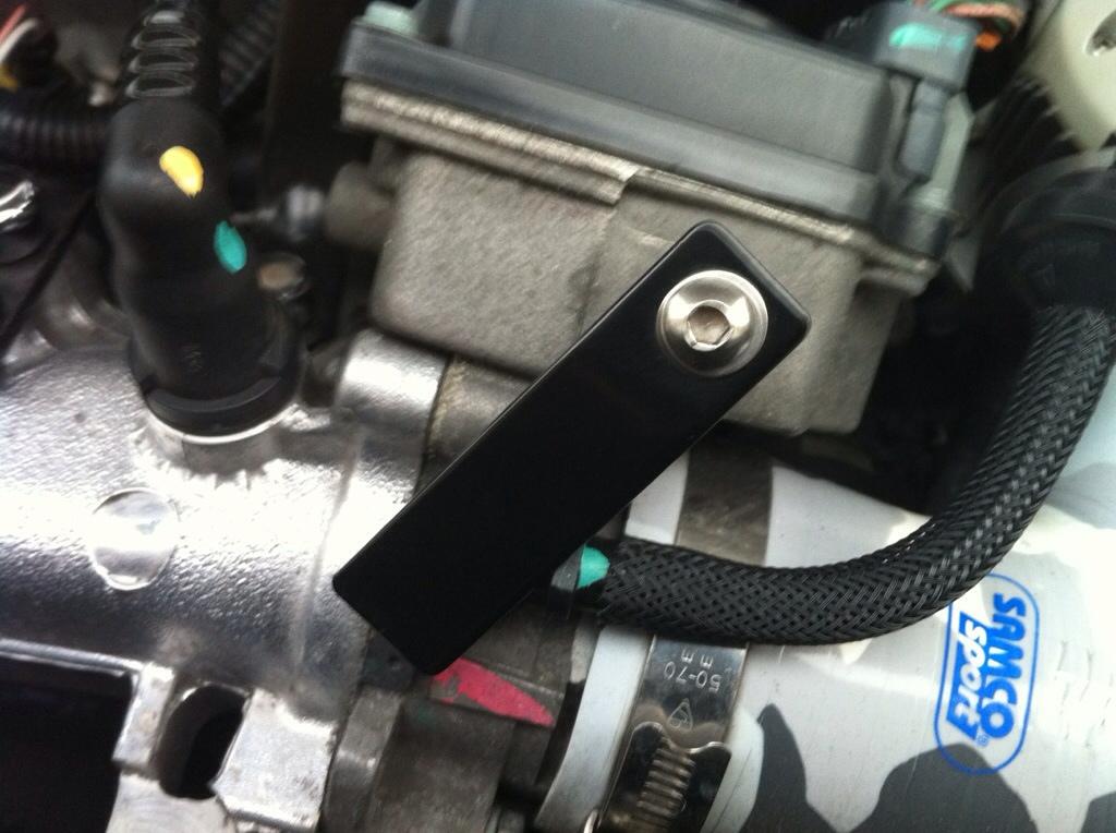

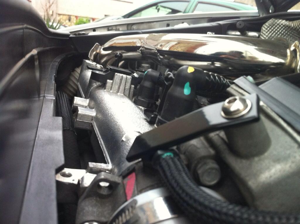

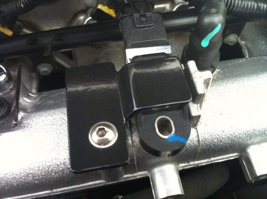

mods to come - boost brackets
The purpose of them is to stop the boost sensors lifting when under load and possibly leaking air therefore loosing power. These brackets keep the sensors firmly in place stopping this potential issue completely. A few people on the forum have experienced this problem especially when running higher boost after remaps.
so some pics

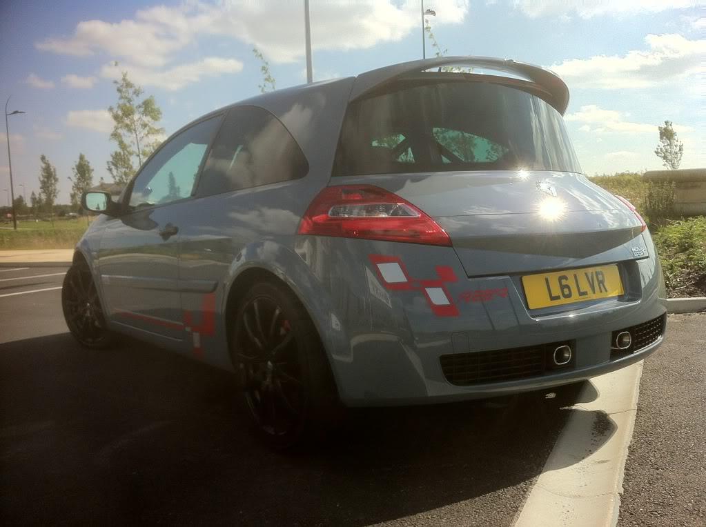

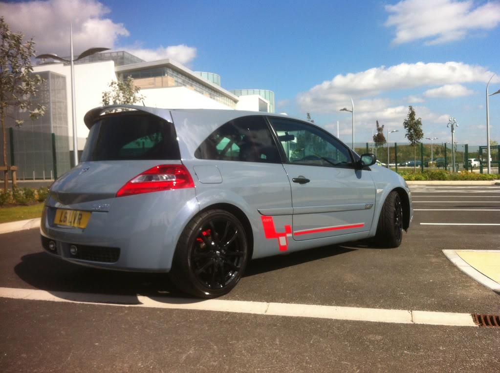

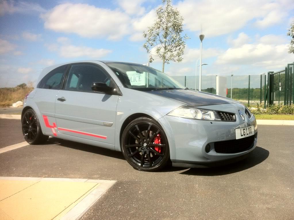

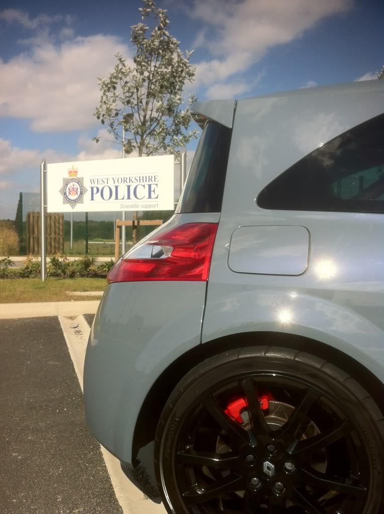

here are some pics from a couple of weeks ago, keeping up with maintenance of it

All looking very good. And a great image for all carbon fetishists:
 :congrats: :congrats: :congrats: :congrats:

Deffo the best colour.  Worked on a few of these over the years. Fitted hybrids, downpipes, coilovers, bigger brakes etc.  It's still to see how a car with so little negative camber at the front can handle so well and still have even tyre wear.
Best mod is the floating disc upgrade.  Seen loads of stock discs with 3mm cracks appear after track days.  I've got some lightly used rs29 rear pads if you want them?

Quote
those rear brakes look really big, what diameter?
