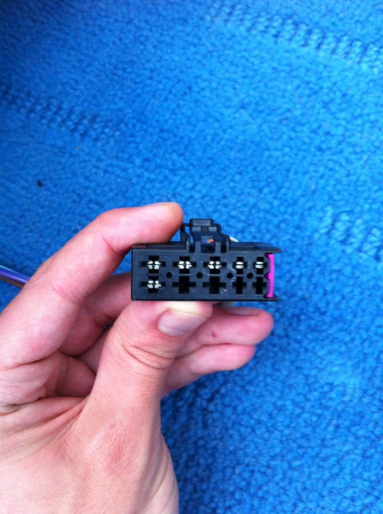

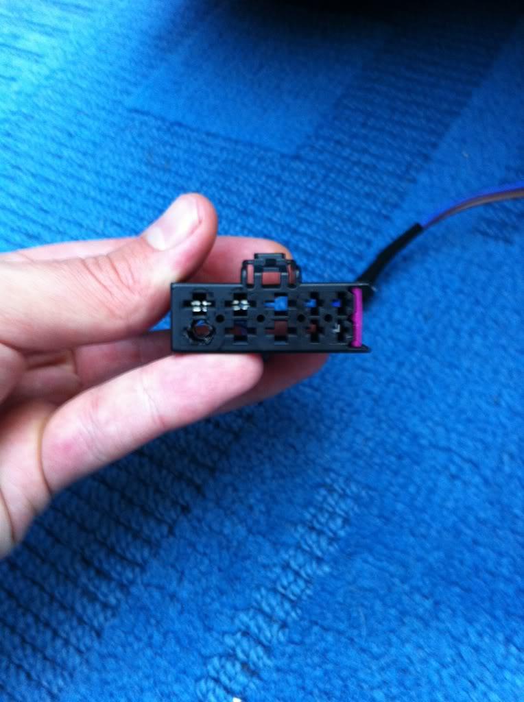

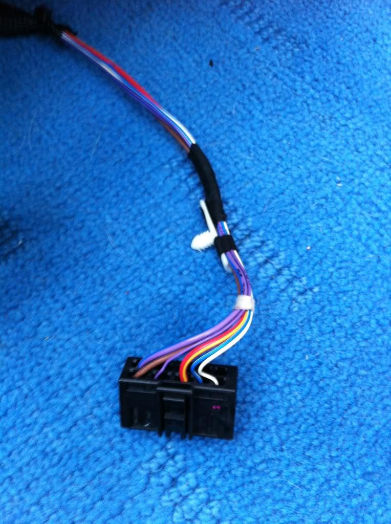

So iv picked my new seats up. They are OEM and not aftermarkets which is good. The plugs connected look like this...
Drivers side
Passengers Side

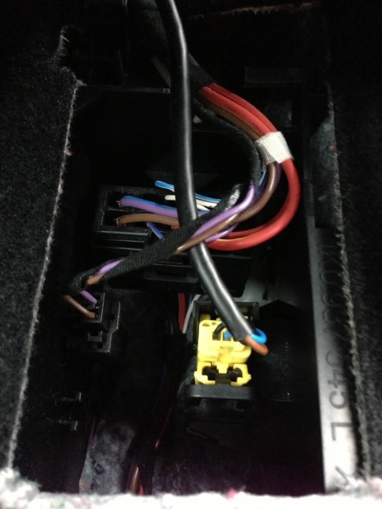

And my current seats which are heated and electric
Does anyone have a wiring diagram so i work out if these new ones are heated aswell? They are definitely not electric lumbar or have airbags but i am unsure on the heating side of things

So I've had a further look at the wiring and here are my findings...
New Seat - Drivers
2
3
4 - Black blue thin
5 - Brown thick
6
7
8
9
10 - Purple blue thick
New Seat - Passengers
1 - White thin
2 - Blue white thin
3 - Red yellow thick
4 - Purple blue thin
5 - Brown thick
6
7
8
9
Old Seat - Drivers
2
3
4 - Black blue thin
5 - Brown thick
6
7
8 - Red black thick
9
Old Seat - Passengers
1 - White thin
2 - Blue white thin
5 - Brown thick
6
7
8 - Red black thick
9

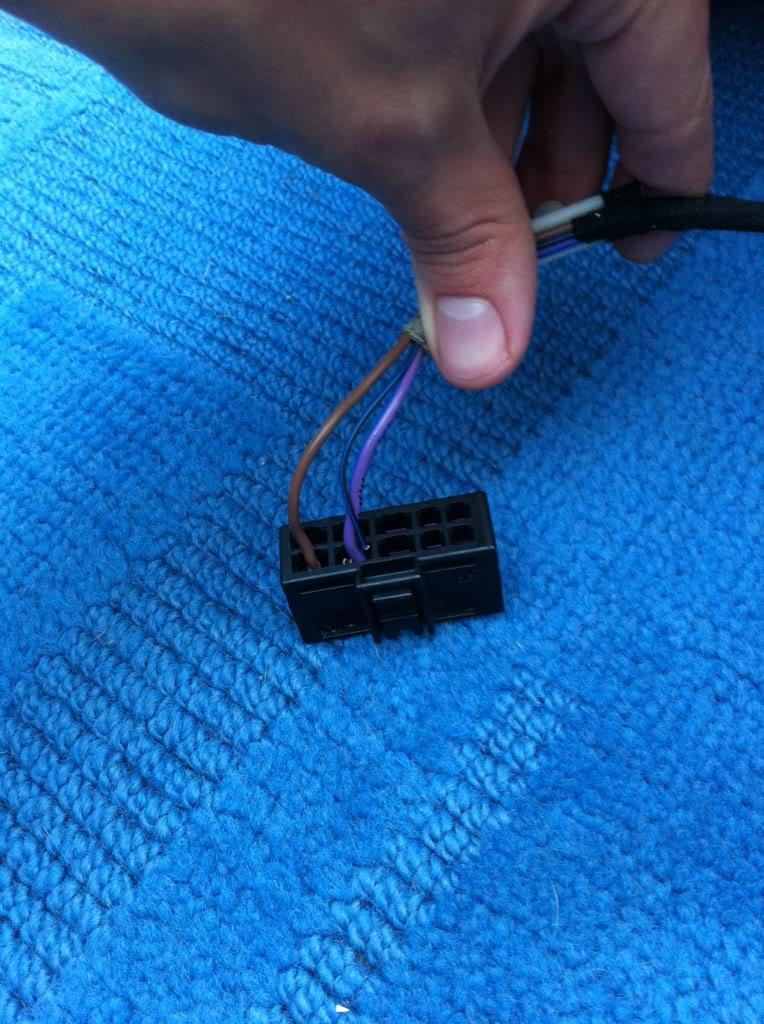

With my old seats I also have the airbag and a smaller plug with a brown thin / purple thin wire in on each side.
So does anyone know what the red black thick wire is in 8?
What does the smaller plug do on my current seat?

the smaller plug is for the seatbelt warning light mate  :happy2:

« Reply #14 on: October 10, 2012, 08:52:56 pm »
So i got my new underseat plug and airbag resistors. Does anyone know the part numbers for the metal connector pieces that sit inside the actual seat plug as in the above pictures? I thought the new plug would have them in but it didnt!
