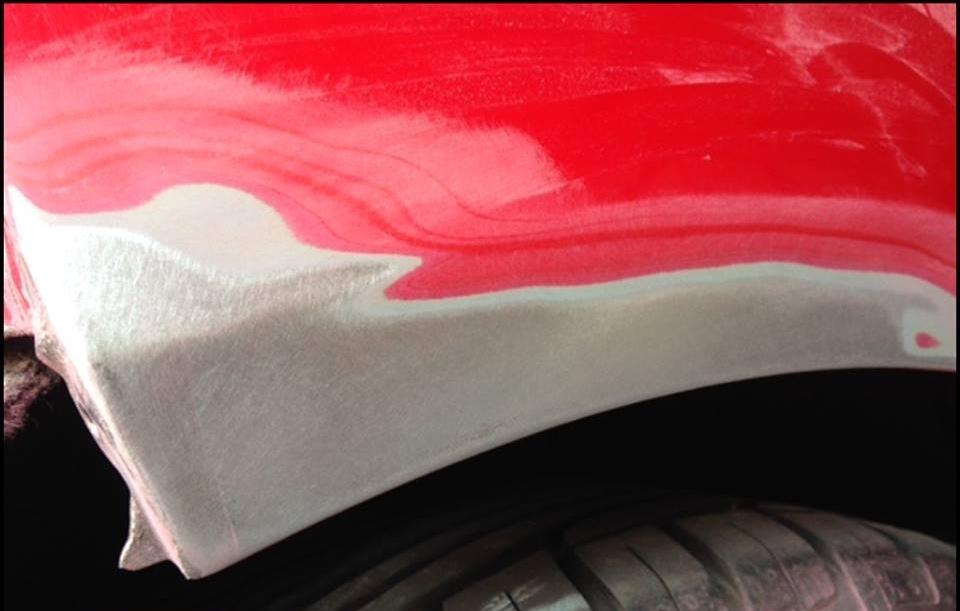

Had a young fella lightly rear end the car.  We sorted it out and he wasn't too keen on involving the insurance.  The damage was only light scuffing but i wanted it all as it was before.  I also had some additional work done while it was it, my rear end is a beaut now  :smiley:  Couple of shots of the work as it was in progress.

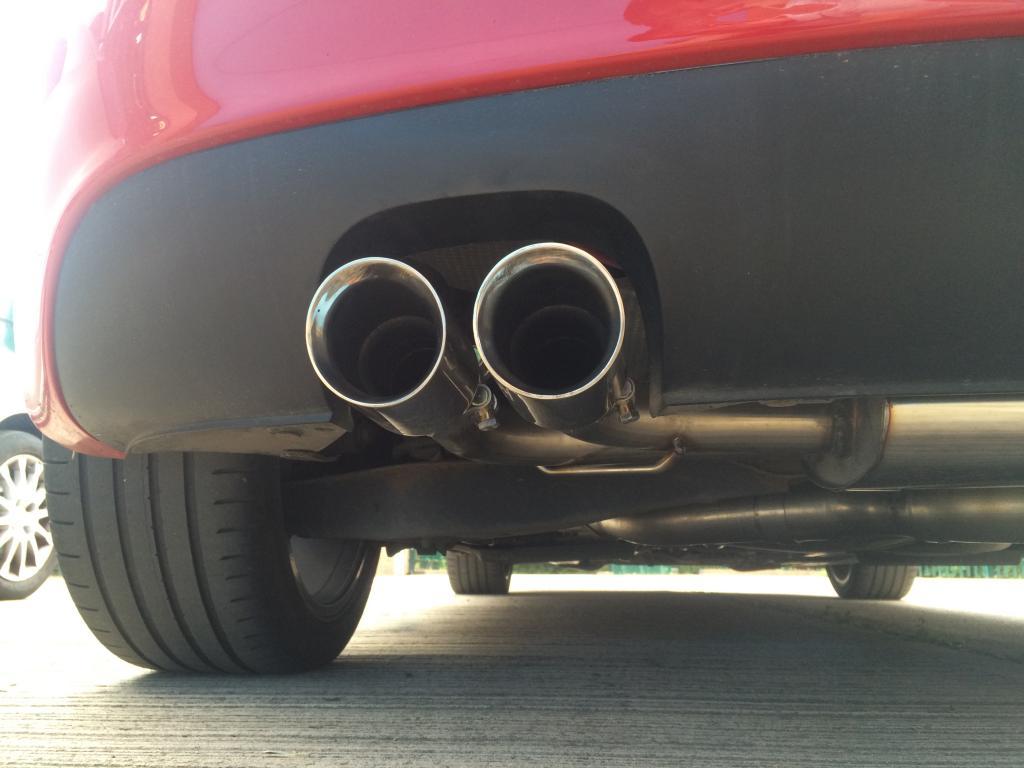

Milltek on.  Non res' Edition version with shallow back box.  Sounds fantastic  :happy2:  Not the best decision I ever made was fitting on axle stands, complete PITA.  Main issue being the downpipe needs a reasonably steep angle to be taken off and the new one put in.  Did it to save fitting costs which it did but the air was blue during the install    :grin:
Used high temp silicon for the the exhaust joints and its worked a treat.
