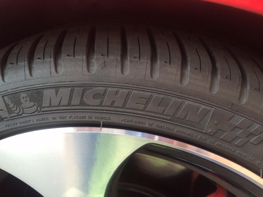

Also bought a set of Michelin PS3's all round, excellent bit of kit, compliments the LSD really well.

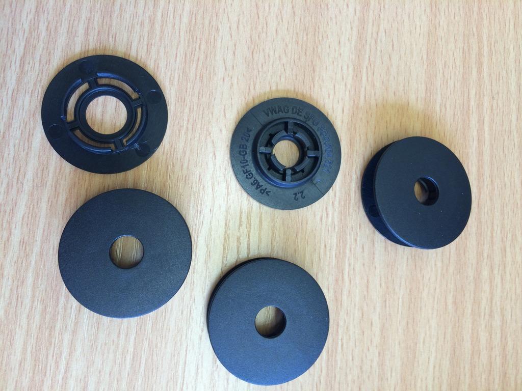

Was looking for some new decent OEM floor mats for mine but being an early MK5 I have the cam retaining clips rather than the circular later style, it seems a bit limiting on styles for the early ones.  Had a bit of a nose on the web and it was easy just pop the circular clips off the mats and pop your original cam style ones in on the later style mats.  Used a large flat blade screwdriver either side and just gently pries apart and they pop out, piece of cake   :happy2:
Mats ordered were 2007 onward and MK6 versions 1K2 061 22 5G 41E
Ignore the dirt, it needs a good clean  :smiley:
