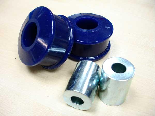

Aftermarket replacement suspension component bushes made of tough polyurethane instead of the OEM rubber and with specifically engineered steel crush tubes where appropriate. But because this is one of those mods which you cannot see and which takes time and hence costs you more to fit, are poly bushes something you need?
SuperPro Bush features: http://www.superpro.eu.com/whysuperpro/features.aspx
^ Product quality is beyond question - They inspire confidence in their durability and retention.
POLYURETHANE vs RUBBER
The OEM suspension bushes are made from a hard rubber substance which over time will deteriorate and will almost certainly need replacing one day on a high mileage car. Also, the OEM bushes are less resilient, increase their hardness (durometer) when compressed, losing elasticity, and so lower their ability to perform well with other aftermarket suspension mods. This doesn't mean that OEM bushes are rubbish but that they are designed for the unmodified car and to be production cost efficient in the car's lowest common denominator marketplace.
SuperPro polyurethane is manufactured using cold pour/thermo setting processes and will return to and retain its original shape. It is also resistant to oil, petrol, salt, and other airborne contaminants which a car is subjected to. Rubber isn't.

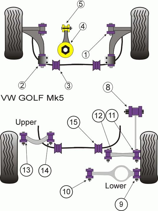

The illustration below shows all the suspension bushes on a Mk5 Golf. You can doubtless appreciate that changing all the bushes is labour intensive and especially when some of the high mileage OEM bushes become difficult to remove, as is very often the case. Pass me the lump hammer!
Therefore it is the same in labour costs to replace them with polyurethane bushes and gain their advantages and longer life, as it is to replace them with OEM rubber bushes.

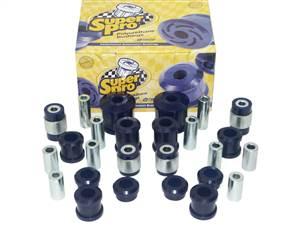

^ Full SuperPro kit for Leon Cupra [Tsfi_Mike]

Similar poly bushes are offered by PolyBush and by Powerflex and I have their Front Wishbone Bushes (number 1 on the illustration).
^ The purple bush is by Powerflex and fitted by VWR to balance my WALK. The WALK consoles have yellow polyurethane bushes.
^ Powerflex bushes (Front Wishbone).

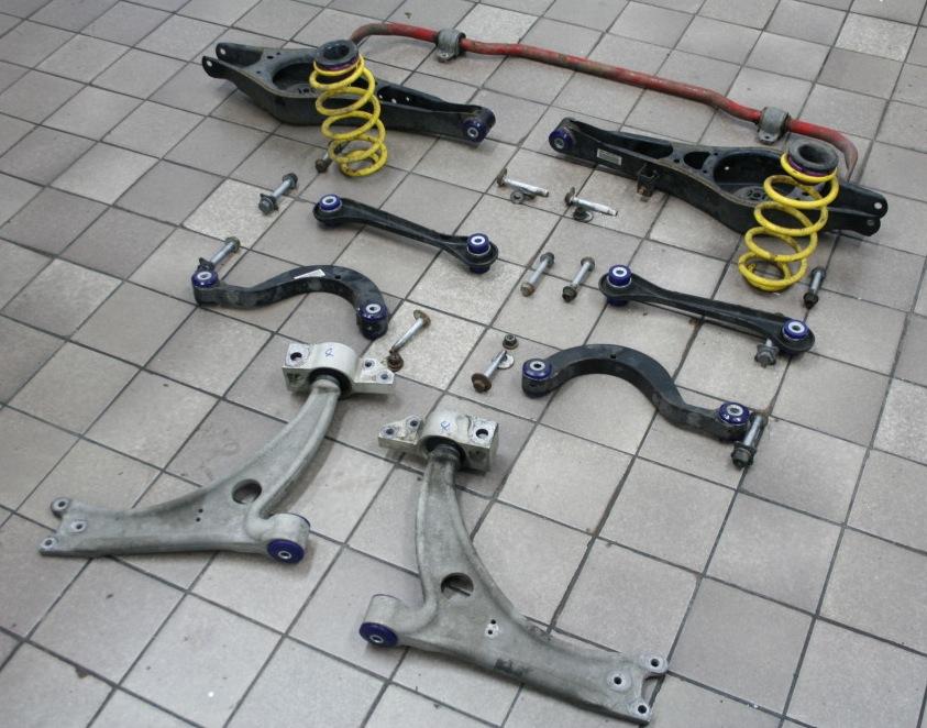

INSTALLATION:
Being very methodical and applying patience is the key in all workshop practices. I don't own the tools, workshop, or have the expertise to do mechanics etc myself so I went to JKM who I regularly use and trust implicitly. To allow enough time for any tricky OEM bush removals and to have my car properly aligned afterwards, JKM asked for one and a half days and were able to lend me a new Volkswagen Polo.

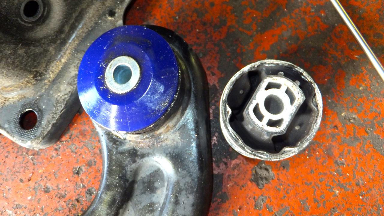

^ Typical removed OEM bushes [photo courtesy of Alex @ AKS]
^ Rear Trailing Arm - Bush number 8 on the Golf Mk5 illustration.
You can see how the OEM bush designs compare badly with the SuperPro poly bush designs.
