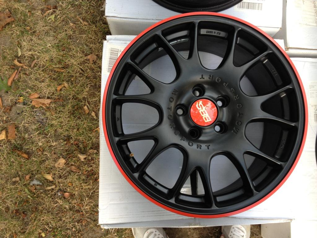

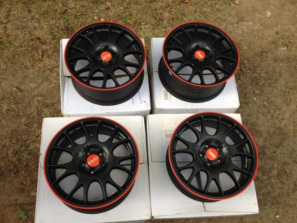

Please, before I commit to buying these can anyone tell me if they are genuine BBS? They will come in white boxes with red BBS logos on.
Here are images to help:
Thanks
Thanks
Unless they have been repainted then no. BBS never did black with red.
What model number are they? (Should be stamped on the outside face between 2 of the spokes and will be like CH026 or CH029 etc)
Also what PCD and offset are they and size. (they look 18")

« Reply #3 on: September 19, 2012, 10:12:41 am »
I've seen boxes and they are BBS boxes. The rims have BBS markings on, also "8J x 18H2", "CH 025", 01 and also some JL looking mark.

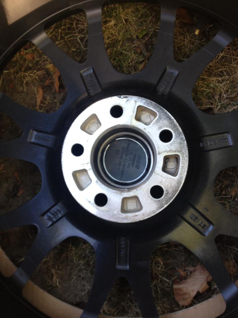

I'd say they are fake as all aftermarket CH needed a centre bore adapter spigot ring to bring the centre bore down to the correct size for VAG sizes. The wheels you posted do not have this.
Depending on the price though there is nothing wrong with running replicas. Just dont pay genuine money for them.

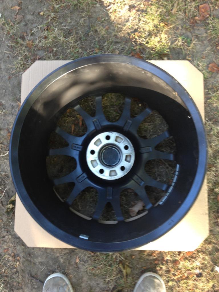

this is the inside of a genuine CH

« Reply #7 on: September 19, 2012, 10:29:49 am »
Based on Jedi's pics the others look like rep's, as rear face is completely different.

« Reply #8 on: September 19, 2012, 10:32:24 am »
I would say definately reps, some years ago I nearly bought a set of these off eBay, illyun bought a set for his Ed30.

« Reply #9 on: September 19, 2012, 10:32:42 am »
He wanted £500 but I have got him to £400, (no tyres) problem is replicas new go for around this. He thinks they are genuine which he says cost £1275 a couple of years back, only run for 250 odd miles and sat in shed since.
I just want to make sure before commiting all that money.

« Reply #10 on: September 19, 2012, 10:49:20 am »
for 18s id not really go more than £300 for a set of reps.
Im 95% sure they are reps and not genuine.

« Reply #12 on: September 19, 2012, 10:52:45 am »
also ask if he has had them painted of if he bought them that colour as bbs never made them in that colour.
They were made in that colour scheme as I nearly bought a set, definately not genuine.
He may well have paid £1275 for the set but they are not worth anywhere near that.
