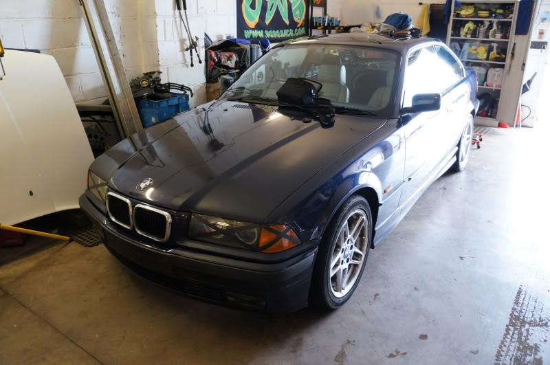

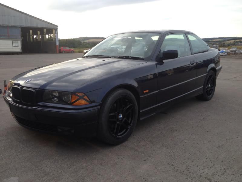

Bought this a wee while ago for a total bargain with no mot or tax. Since having it we have completely stripped out the interior (still to tackle the dash properly) painted the wheels black and welded the diff. Goes pretty well so far :hihi
Any reasonably cheap mods recommended?
Here she is

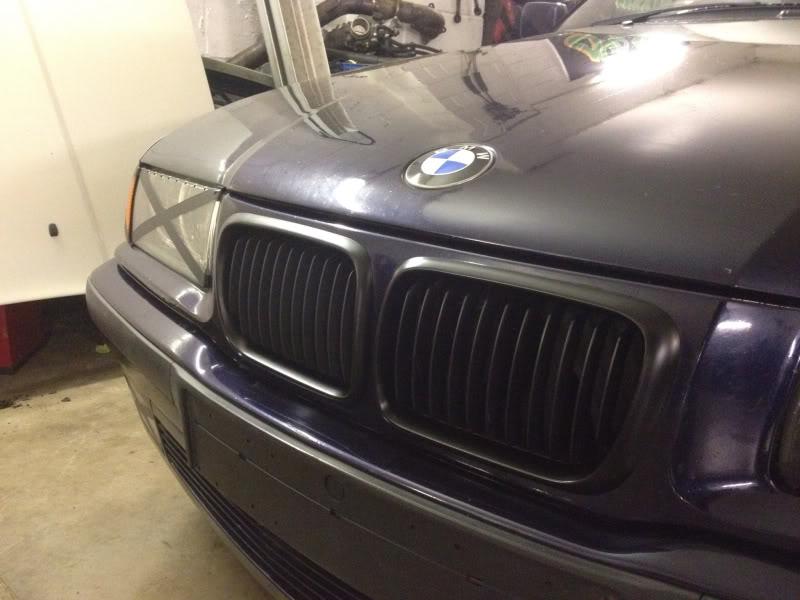

Grills painted
Wheels painted

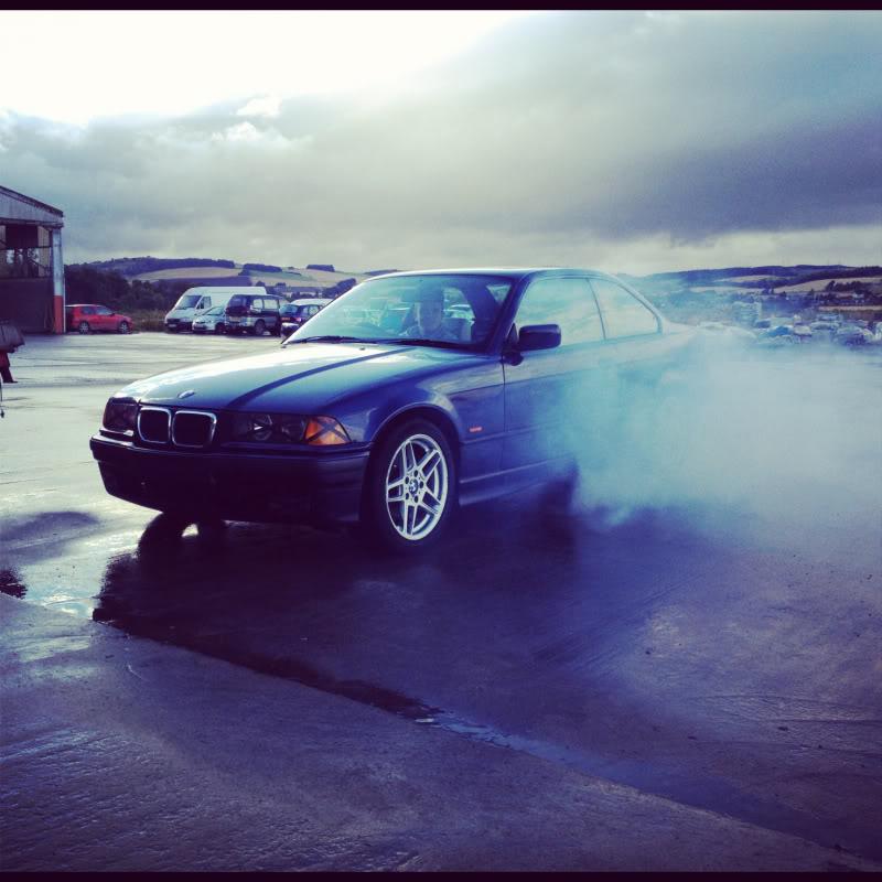

Little spot playing about  :laugh:

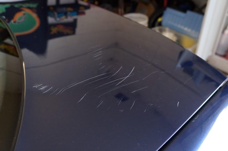

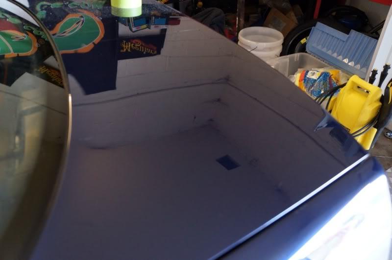

So being a detailer part time I decided to remove some scratches. Process was to measure paint depth, was an average of around 124 microns, use 2000 grade paper to flatten scratch, use a 3m wool pad and megs #105, then a 3m yellow pad with megs #105 then #205 on a different pad. Then glazed using clearkote red moose via da with chemical guys finishing pad.
Before
After
Some light marks still visible to the eye close up but a good improvement.
More to come soon hopefully as there is more scratches and bird etching.
