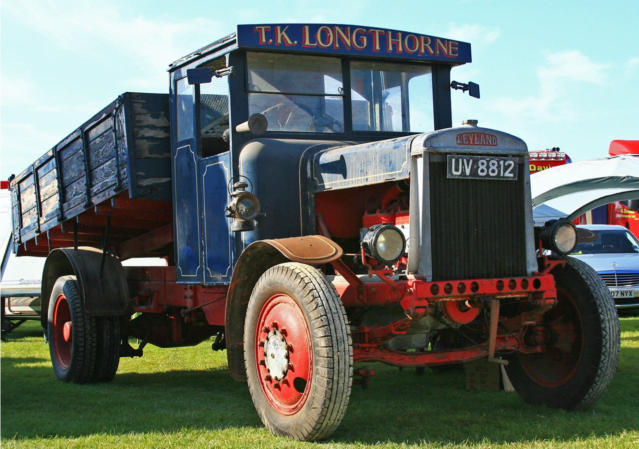

^ Vehicles officially registered as vintage like this fine Leyland truck are allowed to only have a klaxon or their original horn. [photo: djmhughes]

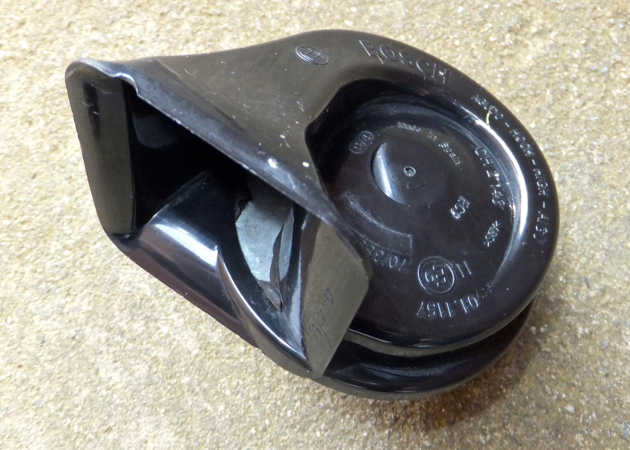

Primarily because the Mk5 GTI OEM horn sounds weak and any horn should strongly urge that immediate movement out of the area is advised - You might say that it's a hint to others in the vicinity to get themselves off and multiply or eff off! A horn is a valuable safety mechanism and all road vehicles are obliged by law to have them in working condition. Another reason to change is because the Golf's OEM horn sounds boring and its lack of tonal richness is a sound more associated with a cheaper car rather than one which is more venerable. Have you noticed that more expensive limousines have grander sounding horns? A single "beep" doesn't really cut the mustard and sounds puny.
^ OEM Mk5 GTI horn made by Bosch.

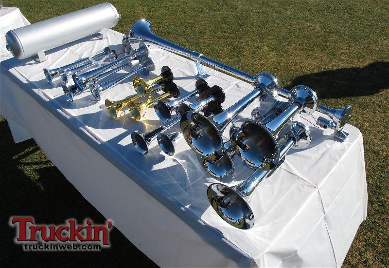

^ A selection of truck air horns, usually mounted as eye-candy where they can be seen as well as heard.

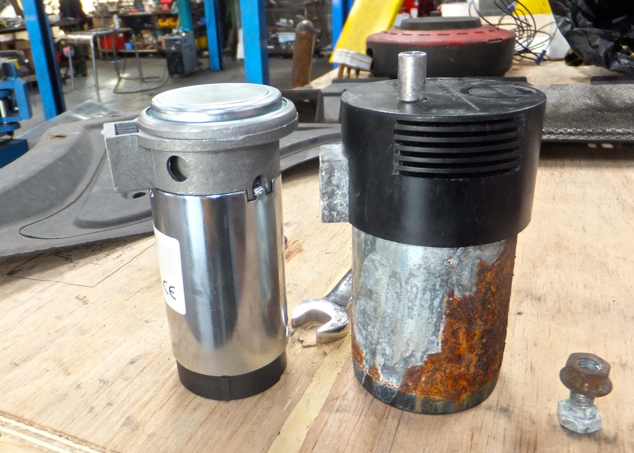

^ New compressor on the left. Failed compressor on the right.
The failed compressor had been wrapped in plastic to help protect it from the elements. However, the auto electrician advised me that that was a bad idea and had very likely contributed to its failure - They need to 'breathe'. Hence you can see the corrosion mine had suffered.

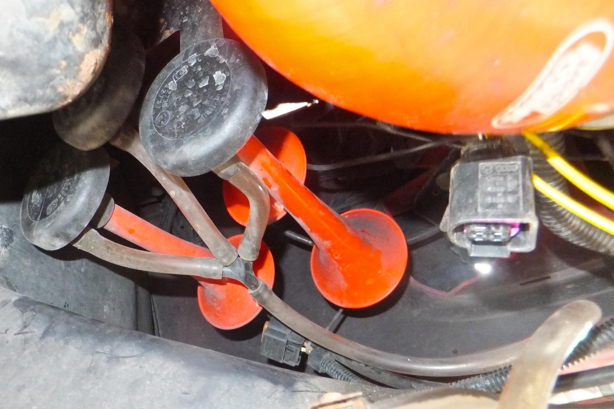

^ The mounted trumpets with compressor removed.
^ The completed installation with shortened air hoses and cable protection. Shorter air lines helps the sound attack.
