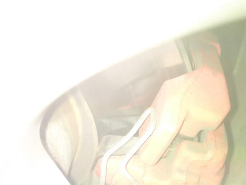

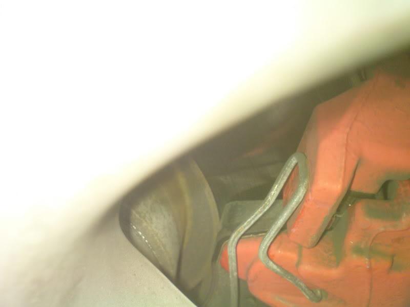

The brakes squeak ever so slightly when applying firm braking, about 60% of the brake pedal but nothing terrible. Presumed this means the front pads probably are on the metal or there about and when checking, I discovered it appears they don't look to sit flat against the disc. Perhaps this is something I should know, or maybe its just the fact that the pad has completely worn out, giving the appearance it doesn't sit flat purely because that's how the pad canopy is shaped? I did a search, but found nothing in case it was a 'must know' ;).
See pics below to compliment my description. Sorry for the crap quality.
You can see the shadow from where there's a gap.
Normal, or need replacing?

that's normal.
the pad is "tapered" so its angled at both ends (middle section is fatter than outer sections)
nothing to worry about.
when you've bed it in and worn down the pad a bit you'll start seeing more of the whole pad sit against the disc.

Yep - they look like practically new pads, although if they dont feel sharp then maybe take it back to the supplying dealer have them give them a good bleed and maybe bleed the master cylinder in addition - on a newish car it should bring the pedal back.
They'll also stop better in a few hundred miles when the "chamfer" dissapears, they make them that way so that when replacing discs and pads together - they are not squealy
