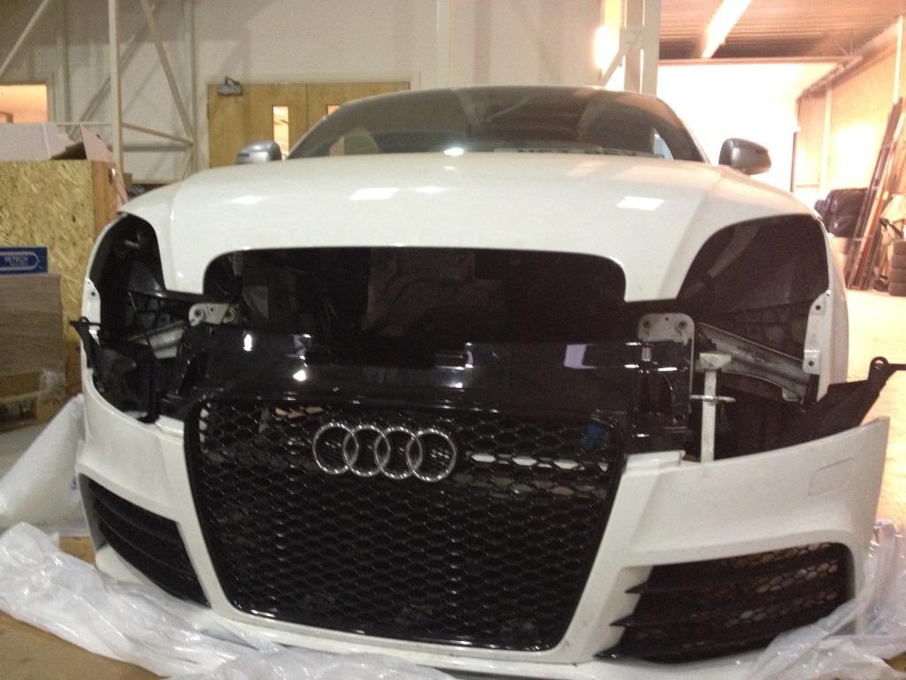

« Reply #45 on: November 14, 2012, 03:50:34 pm »
Lets hope that you get that crach bar back on it  :scared:
Looks good tho  :happy2: cant wait to see it stage 4  :driver:

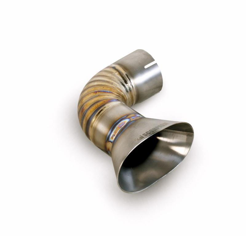

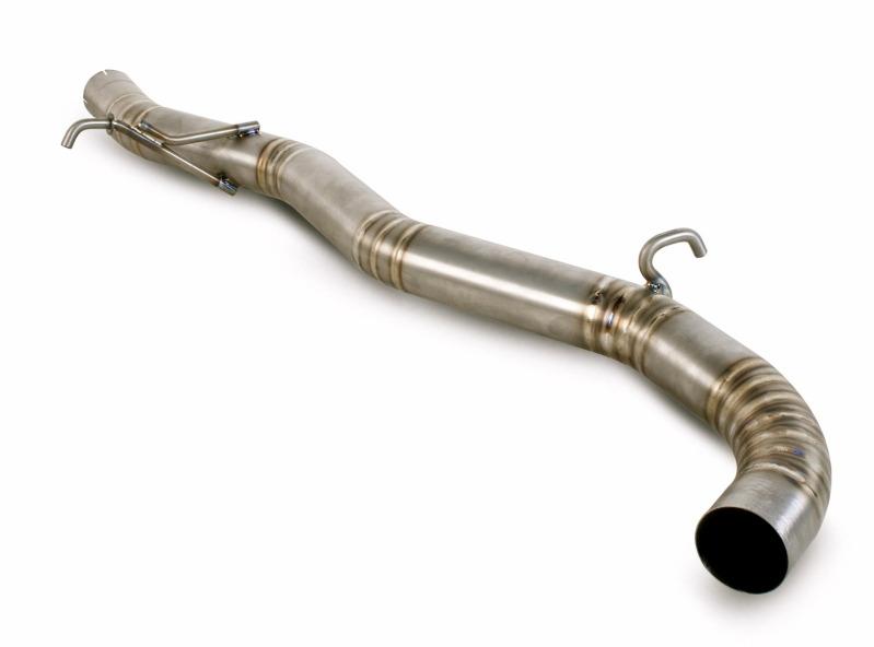

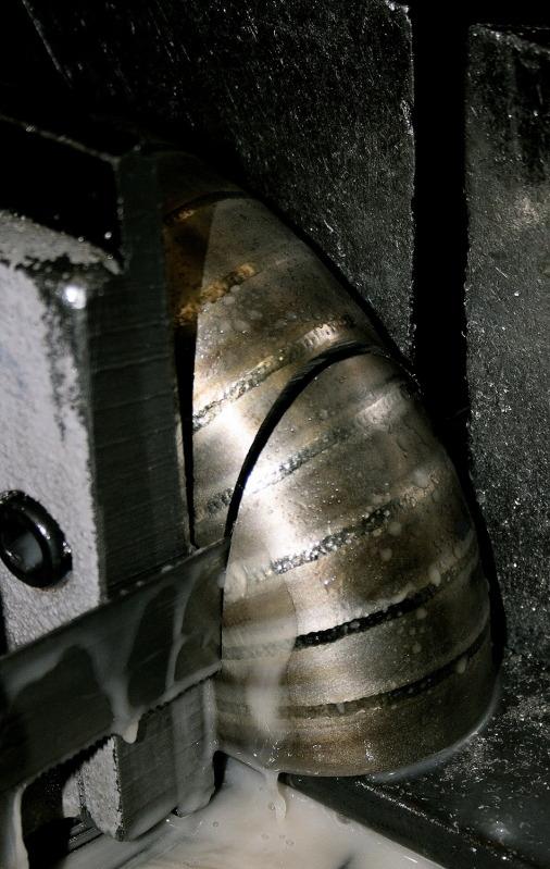

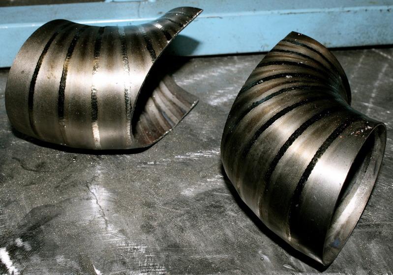

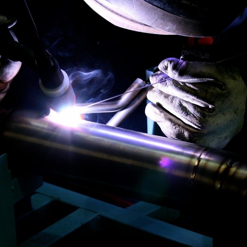

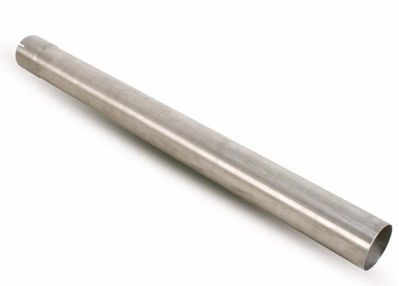

Some more exhaust porn. Gotta give massive props to Forge Motorsport/scorpion exhaust for making a Ti exhaust for the TTRS! Aero Space Grade 1 Titanium with 1mm thickness!

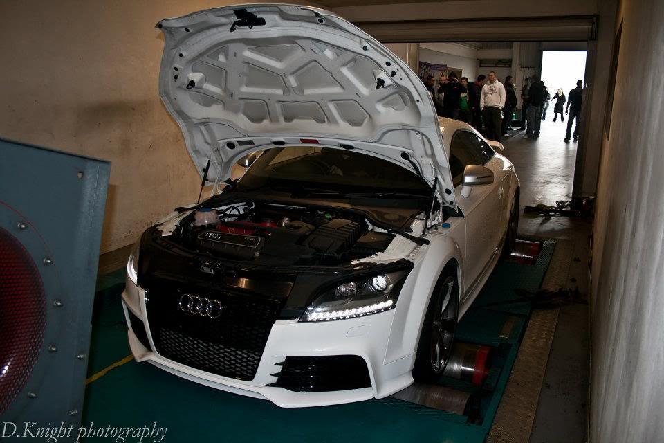

At this point I decided that I would move away from Revo software, and paid a visit to APR.
They wrote a stage 2 map for the car, I was hoping for great things after having tested their new 2.0TFSI software and I wasnt dissapointed. The power holding that the map provided at high rpm map was just crazy. Its pulls and pulls all the way to the redline. The way the power doesnt drop off and it keeps on just pulling leaves you smiling from ear to ear.
Now after the forge intercooler was installed, the car was dynoed at 420hp at revo stage 2 and  about 400lbft of torque, I cant remember the exact figure.
I decided I wanted to dyno this new map to see what the car was making now.
The APR map gave me a nice gain, 430hp and 450lbft! The power curve is just beautiful aswell!
So now we are at 430hp and just about reaching the limits of the stock turbo with the limited size intercooler and no WMI.
However, still hungry for greater power, so on I plod.

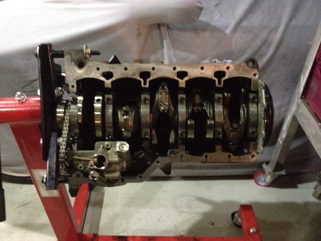

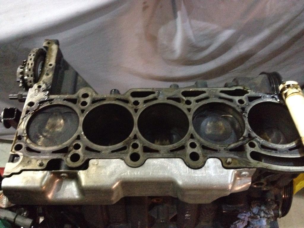

Anyway earlier this year I was at the pod, was struggling all day trying to get the gear into third on every run, as was shown in the results of all my runs being slower than stock at times. One run too many as I attempted my usual ninja shifting into third, but selected 1st gear instead  :scared: :scared: :scared:
Quick scan with vagcom showed the engine revved to 8800rpm, the engine still ran, but didnt sound too healthy. So off it got towed to nearby APR in milton keynes.
It was a weird feeling having just broke your engine. I took it better than I thought I would, albeit all I was thinking at the time was of the possibility of a 15k bill for a new motor.  :scared:
The car sat at APR for a while as I was away on holiday, which gave me 2 weeks to think about which steps I wanted to take next, and gave APR a chance to strip down the engine to see what damage there was.
Turns out a few of the valves kissed 2-3 pistons, but other than that the motor was fine, so about 1-1.5k to put right. However as I had ambitions for big power and the engine being out already I decided that I might aswell build the engine.

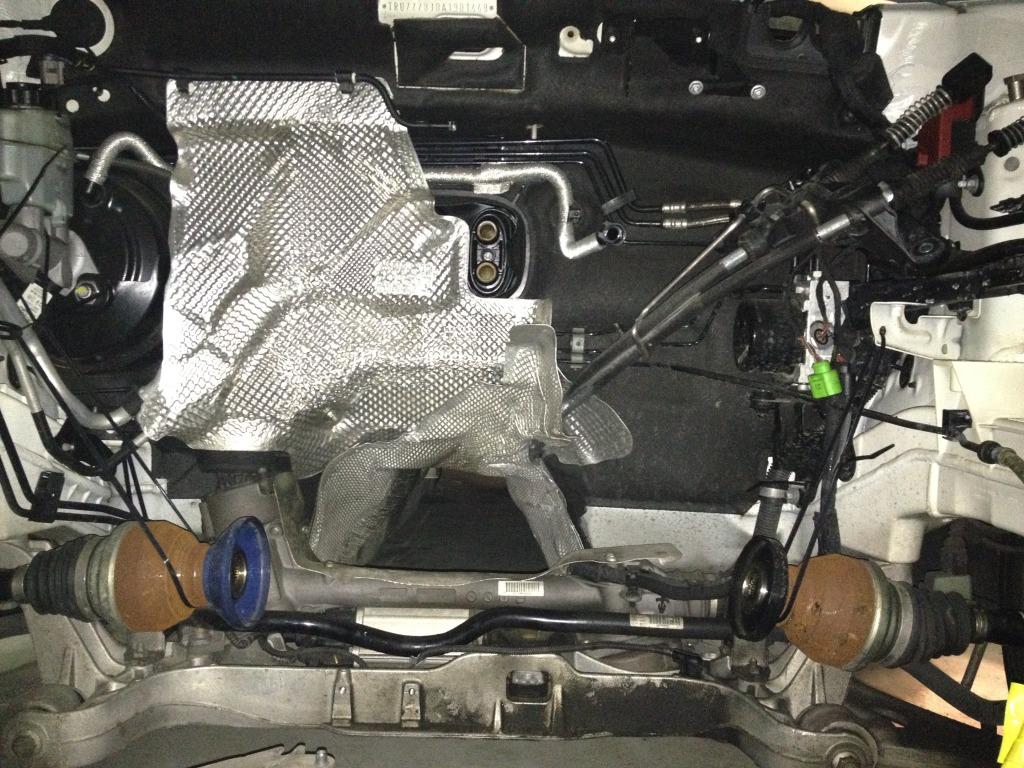

Engines out!
So after asking around for recommended engine builders I chose Race Developments to spec and build the engine. These are the guys who built the skoda bonneville record holding 700hp 2.0TSI, time attack evo cars and race engines for british superbike racers to name a few.
And so the engine build begins!
How it looked partially stripped down
And some progress pics.

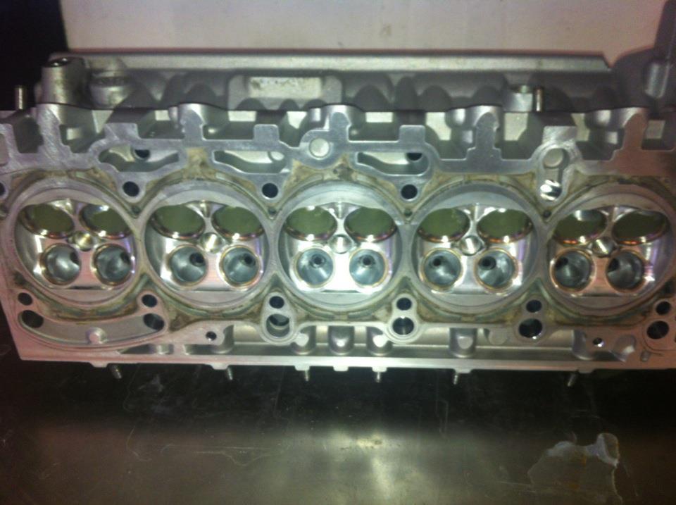

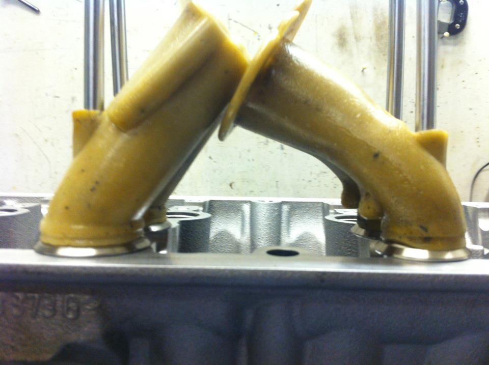

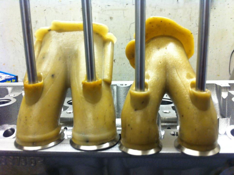

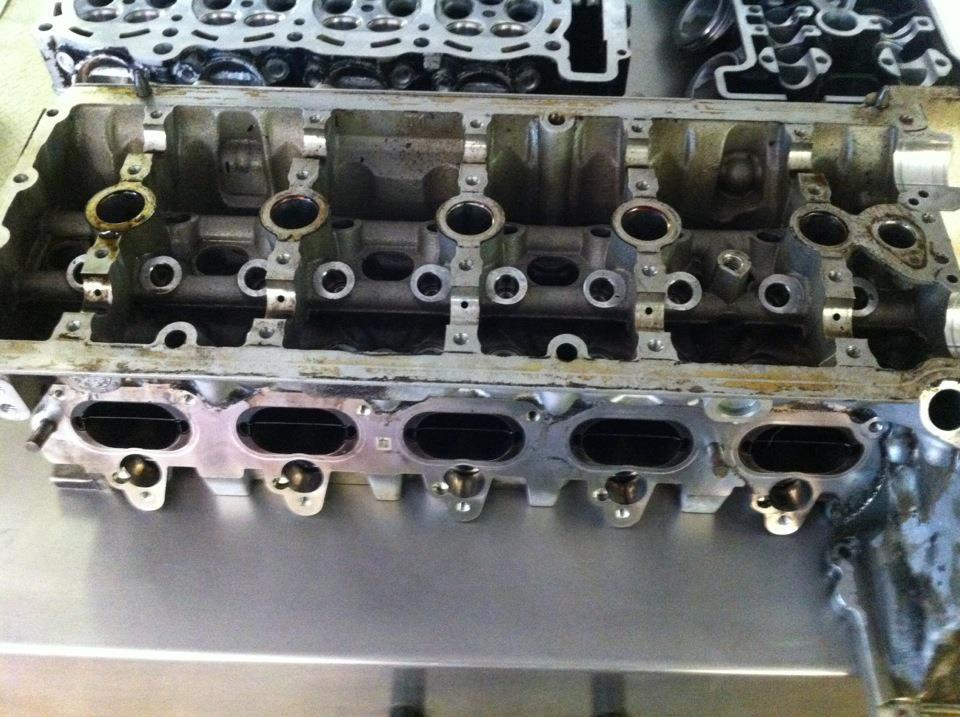

Stripped down head
Port moulds and the ferrea valevtrain

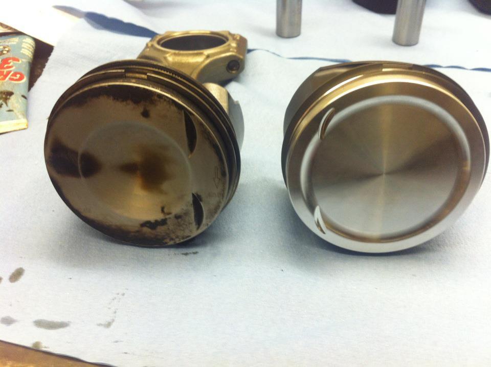

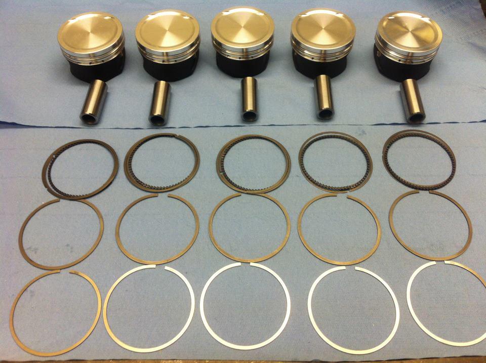

]Rings gapped, parts balanced, ready for assembly. High temp, low friction thermal coating.
Old VS new
The cylinder head getting race developments renowned expertise applied to it

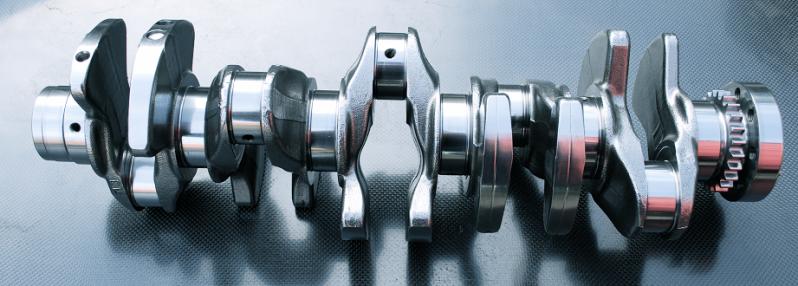

Superfinished Crank

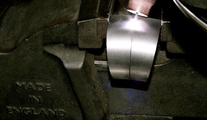

More isotropic superfinishing treatment.
What is superfinishing?
Isotropic Superfinishing increases horsepower by reducing friction in the engine, gearbox and drive train components. Testing has shown this process increases the functional life of motor and gearbox components by an amazing 300%!
Isotropic Superfinishing is not a coating, polish, oil treatment or additive of any sort. This technology is dyno tested and track proven. It gives the added advantage every competitor is looking for. It is effective on all metal components involved in the production and delivery of horsepower.
Manufacturing cannot make a perfectly smooth surface. All new surfaces, even when coated, have surface asperities (micro peaks). When metal cutting begins, these asperities are producing friction and affecting the life and performance of the product. In a closed system, as metal components mate and shear, every component in the oil/coolant stream is exposed to these particles carried in the lubricating fluid.
Isotropic Superfinishing creates a surface with low surface roughness (skew). Bearing properties improve, heat from friction is reduced and engine/gearbox life is extended. Most importantly, performance is improved! It is used extensively in F1!
Gearbox internals before:
Internals after

It's custom JE pistons and IE rods. I don't have the final compression ratio to hand, but during the spec o the build it was decided to keep the CR as close to stock as possible. What features are you going for on your pistons?
Cyro was talked about but I dont think it was specced in the end.
