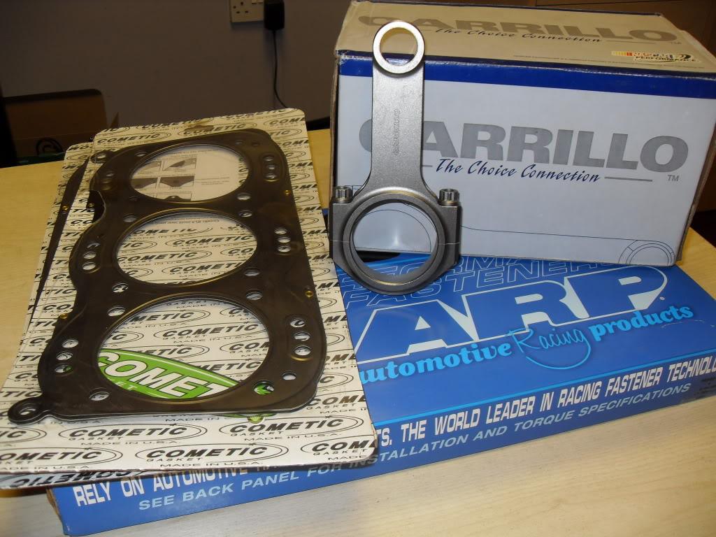

Back to the tfsi's we're going to run both at lower comp than stock but not by a mile, both will have WON kits fitted as they are pure sprint not road cars
We've gone for Loba spec Mahle  Pistons with Arrow custom rods and custom rod bolts
Piston coating specs are a little secret but for a brief run down:
Coated bearing surfaces (piston sleeves) for better running-in characteristics and reserves under maximum load and deficient lubrication e.g. cold starting, washed off lubricating film in case of failure of the spark plug, Moreover, our coating allows less piston to bore clearance despite the pistons complex shape reducing engine noise.
We've had problems with JE's knocking in the past (slap) and triggering the knock sensors early but that was a good few years ago maybe they are a lot better now.

Engine Spec:-
Full race engine build
Balanced and blueprinted
Superfinished crankshaft
Gasflowed race spec cylinder head with valve seat modifications
Bore block
I-beam Rods
Custom oversized pistons, high temp low friction coating
Full Ferrea valvetrain
ARP bolts

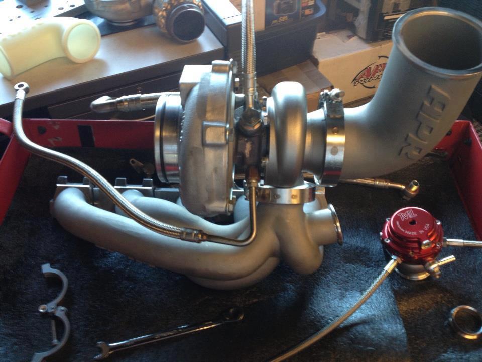

What size turbo is that, Jas? 3071?
3076  :happy2:

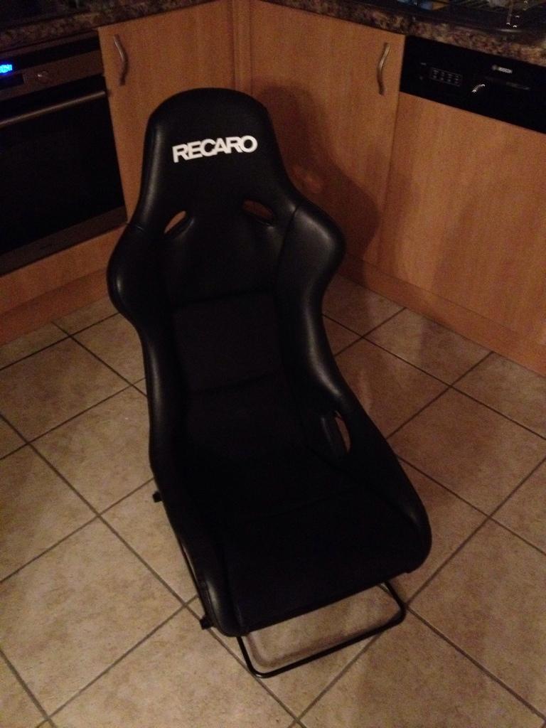

Ive made some extra progress on the weight saving. These recaros are 13kg with sidemounts and runners. The OEM seats are about 34kg, so a saving of 21kg per seat.
The titanium exhaust saves 26kg over OEM.
So thats a 68kg saving so far. I have a few more weight saving ideas in my head, so should be able to reduce the weight by about 100kg over stock. Will make the car weigh roughly 1360kg with a quarter tank.
At last weigh in the car weighed 1453kg with a quarter tank and milltek exhaust. So with these bits not a millions miles off the target weight.

With the stage 3 turbo kit the aim is 600hp from what I've been told. Some argue the turbo can't flow that much, but APR have their own theories. We will soon see. Once stage 3 is wrapped up and signed off stage 4 will come next.
650hp/650lbft is my final aim on vpower.
