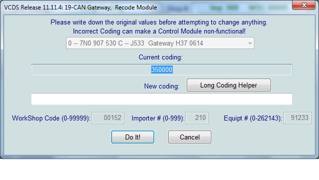

« Reply #30 on: November 23, 2012, 10:33:54 pm »
change 350000 to 350001
Cluster and Key coding
Location Great Yarmouth
Offline scopes
  • -Given: 131
  • -Receive: 116
  • Posts: 2283
  • Wolfsburg Edition
    • My GTI
Re: HELP required Please with Canbus change over
« Reply #31 on: November 23, 2012, 10:41:19 pm »
Sorry guys for all the Q's!
A BIG THANKS FOR YOUR HELP   :happy2:
How do i change the code?
Silver is the way !
Offline Eddie-NL
  • Trader - 2014
  • -Receive: 298
  • Posts: 2639
« Reply #32 on: November 23, 2012, 10:44:38 pm »
address 19 > coding > long coding . scroll through the bytes and tick RHD
or just enter the code when in coding
« Reply #33 on: November 23, 2012, 10:48:18 pm »
Just waiting on it scanning here!
« Reply #35 on: November 23, 2012, 10:57:55 pm »
Like Ed said just change the value from 350000 to 350001 then click Do It.
