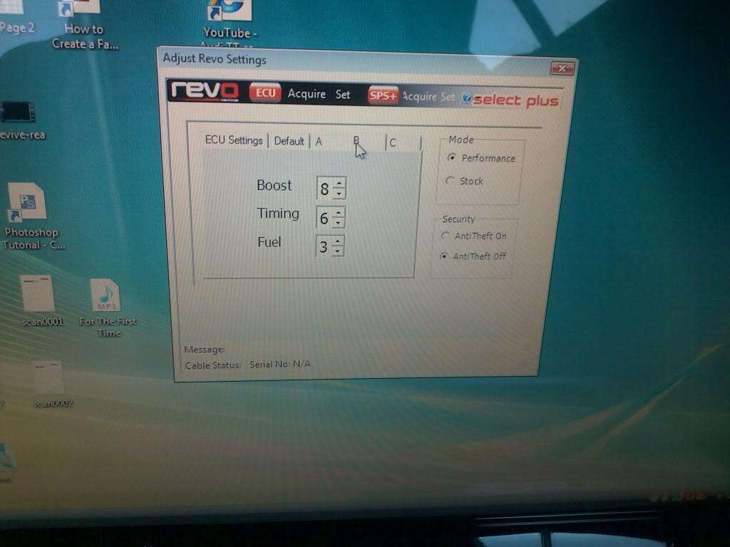

What setting does the sps need to be on is it 0 ?
And once the numbers pop up on the screen if you hit B does that save it on the B setting ?
Thanks mate
Thanks mate
Yes set it to 0
Youll have to set up the A B C settings yourself with the up/down arrows

« Reply #8 on: January 13, 2013, 08:44:18 pm »
Ah right so just write down the numbers go to a b or c and input the written down figures !
Thanks again
