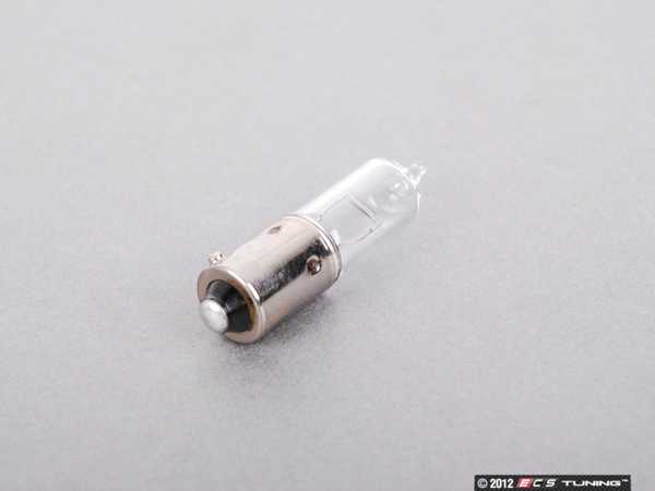

Anybody know how to change the indicator bulbs and what bulbs they are? Pulled one out and it fell into the headlight  :fighting: not sure how it seats back in or what bulb. Very annoying! Also is there a bumper removal guide.....haha

Just google "mk5 bumper removal" and you'll get many great DIY.
What indicator bulbs have yours fitted?
Mine are like this:
They're easier to remove than my sidelights were when I replaced them for LED lights.

Yea most likely them....i found them easy to get out, was just the bulb didnt come out with it haha. Do they just push back in or twist? Found a bumper guide yea so will do that next week.

They twist a bit, not like the sidelights that just need a good pull.
