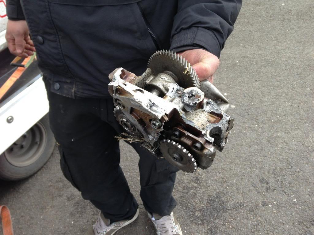

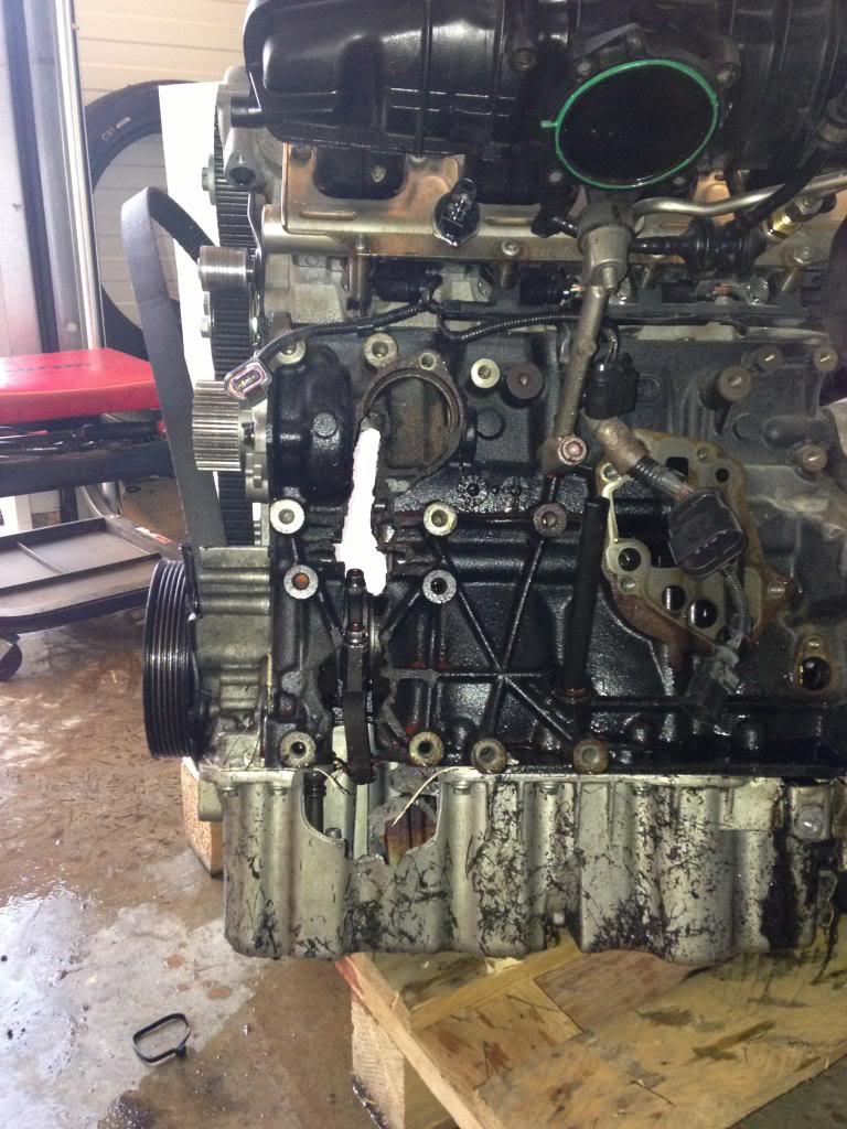

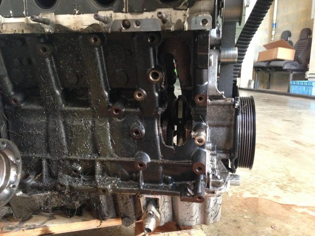

Here's the remains of the old engine
And I am sure the oil pump is meant to stay inside the engine not end up 150 foot away from the car after being ejected through the sump  :sick:
