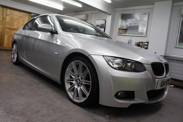

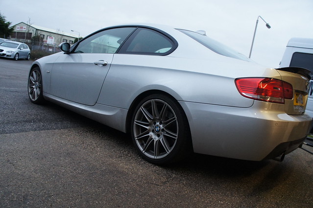

The 'test subject' was one of MCC's very own cars - this silver BMW 335D.  This 335D is standard styling wise aside from the genuine BMW Carbon Spoiler (which had recently been bonded on and would need removing!) but has been tuned to 'Stage 2' which is 355BHP and 520lbft - a beast of a car!  The interior is red leather which clashes with the cars new colour but this will be recoloured in the coming week on the back of our training session with LTT a few months back.
Here's the 335D before we started:
DSC04901 by RussZS, on Flickr

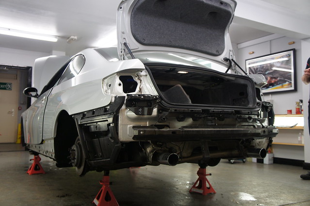

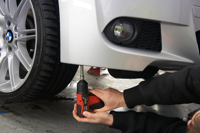

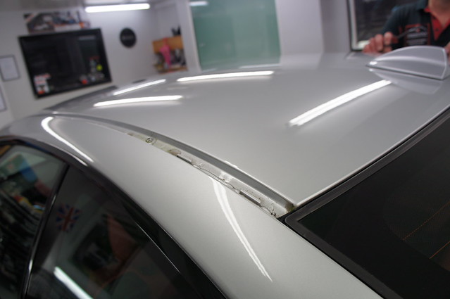

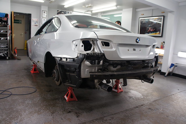

The next part was to begin removing parts of the car which would hinder the wrapping process and also obstruct our ability to wrap the car as thoroughly as possible.
Roof rails removed:
DSC04907 by RussZS, on Flickr

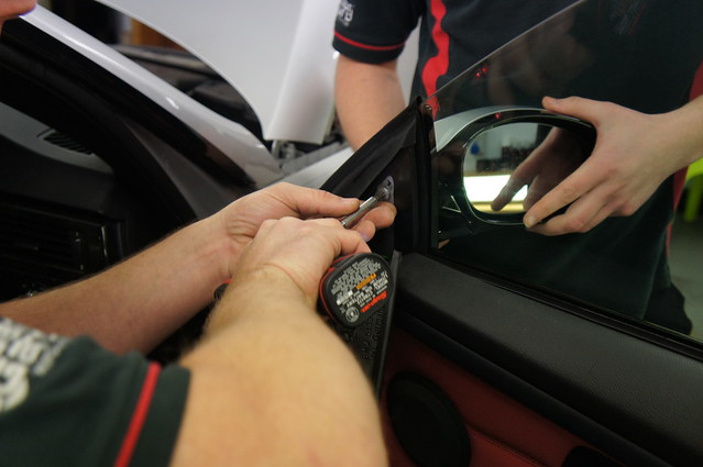

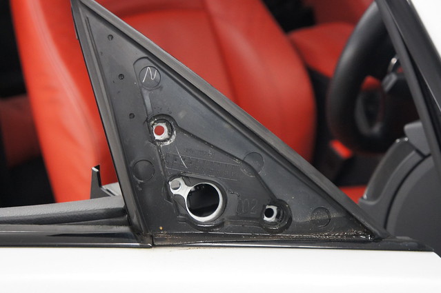

Wing mirrors:
DSC04909 by RussZS, on Flickr
DSC04912 by RussZS, on Flickr
Front bumper:
DSC04914 by RussZS, on Flickr
Side repeaters:
DSC04915 by RussZS, on Flickr
Side skirts:
DSC04918 by RussZS, on Flickr

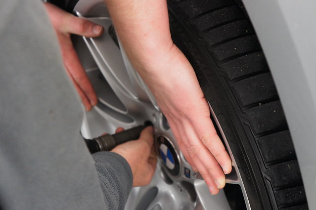

Alloy wheels:
DSC04919 by RussZS, on Flickr
Those hubs need a painting!
DSC04920 by RussZS, on Flickr

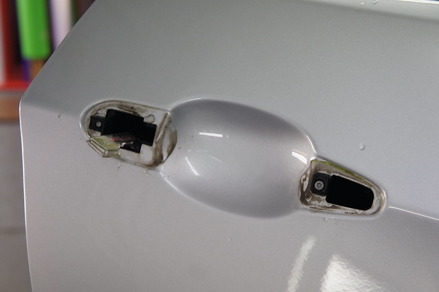

Door handles:
DSC04926 by RussZS, on Flickr
Petrol cap:
DSC04940 by RussZS, on Flickr
Fully stripped:
DSC04941 by RussZS, on Flickr
The car was also debadged and the bonded spoiler was safely removed and the residue removed too:
DSC04948 by RussZS, on Flickr
DSC04950 by RussZS, on Flickr
Next the bumpers and skirts were cleaned outside to ensure the rear of them were all clean so that when we're handling the panels later on, no dirt is transferred from the rear of them:

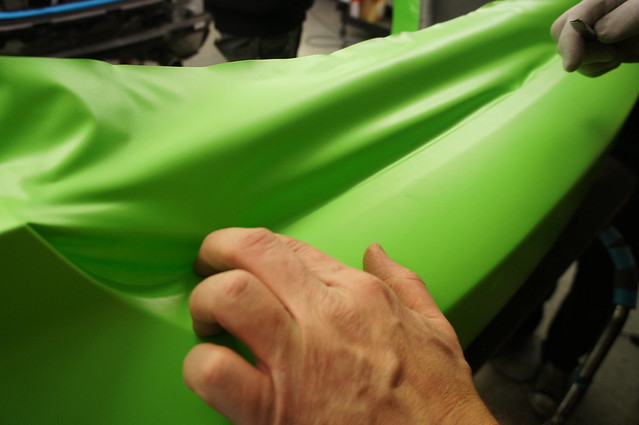

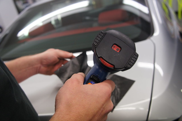

Next we began to get to understand the various vinyl films available, the technology behind them and the importance of using the respective preparation products to ensure a perfect bond between the film and its surface.

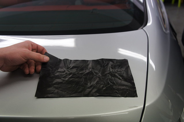

We started off with an APA satin black film and shown just how mouldable it was and how it can be restored with a bit of heat:
DSC04957 by RussZS, on Flickr
DSC04958 by RussZS, on Flickr
DSC04959 by RussZS, on Flickr
Impressive stuff!

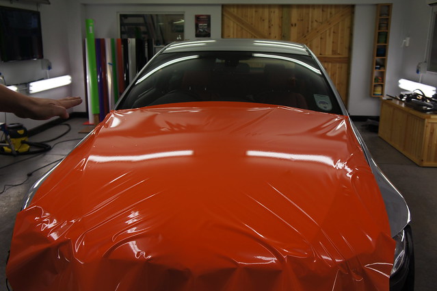

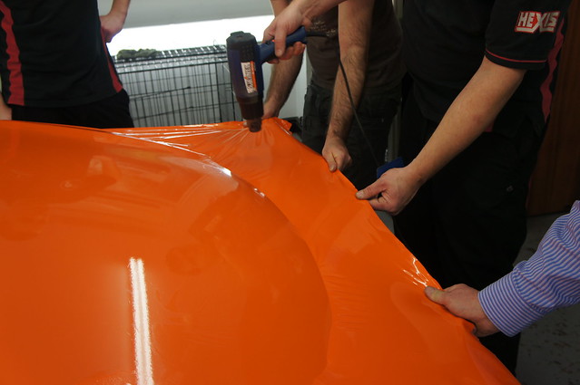

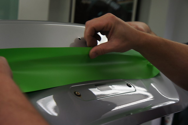

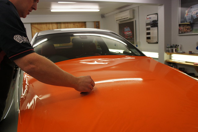

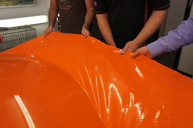

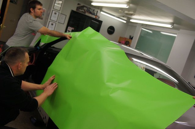

Next up we had a look at applying film to a panel and the best way to do this to ensure a clean install - we started with this test piece of gloss orange film:
DSC04965 by RussZS, on Flickr
DSC04969 by RussZS, on Flickr
DSC04970 by RussZS, on Flickr
DSC04973 by RussZS, on Flickr
DSC04974 by RussZS, on Flickr
DSC04975 by RussZS, on Flickr
DSC04976 by RussZS, on Flickr

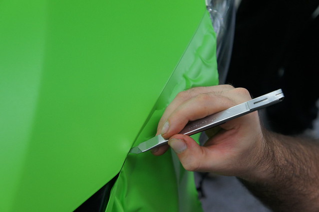

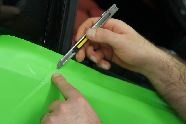

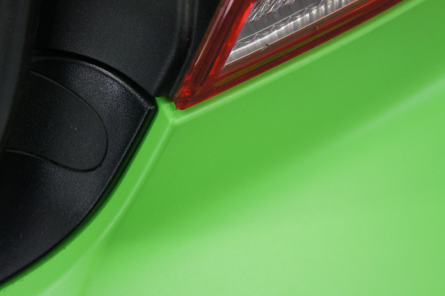

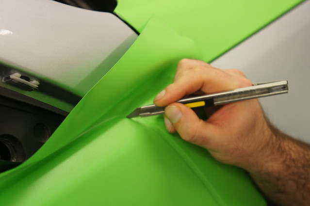

We then practiced cutting along panel edges safely and removing the correct amount to ensure the original paint colour is not showing.

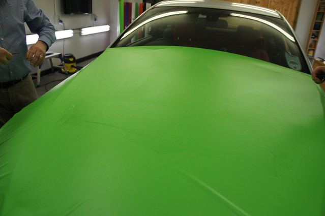

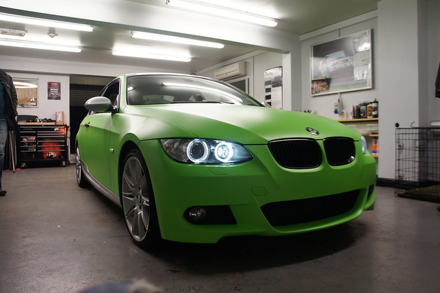

After this, we moved onto the installation of the Hexis 30000 Kiwi Green film which had been selected for our 335D.  This stuff isn't cheap at nearly £25 per metre.
DSC04977 by RussZS, on Flickr
DSC04979 by RussZS, on Flickr
DSC04982 by RussZS, on Flickr
DSC04985 by RussZS, on Flickr

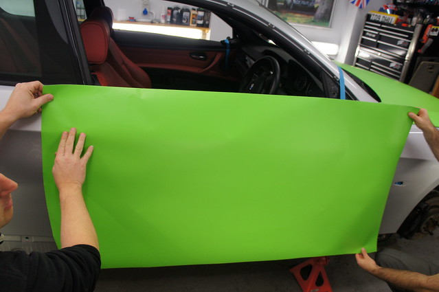

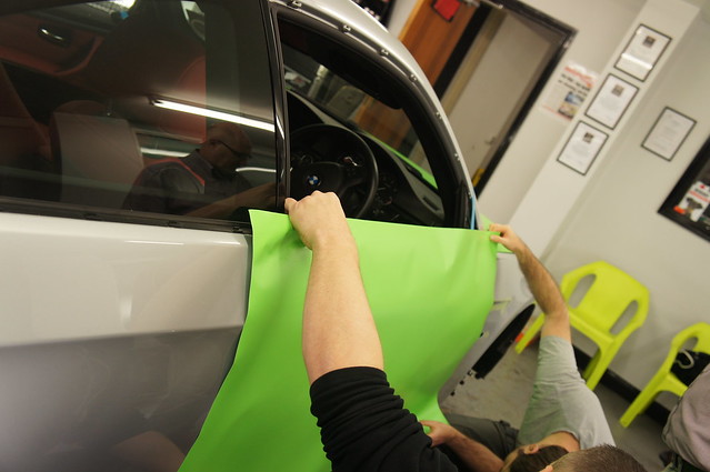

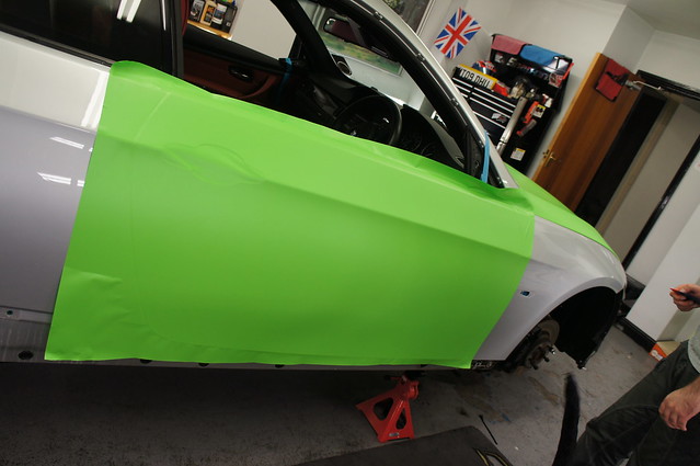

After the bonnet was completed, we moved onto the door:
DSC04991 by RussZS, on Flickr
Test fitting after measuring up:
DSC04992 by RussZS, on Flickr
Preparing the panel:
DSC04993 by RussZS, on Flickr
DSC04994 by RussZS, on Flickr
DSC04997 by RussZS, on Flickr
DSC05000 by RussZS, on Flickr
DSC05001 by RussZS, on Flickr
DSC05003 by RussZS, on Flickr
DSC05006 by RussZS, on Flickr

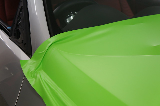

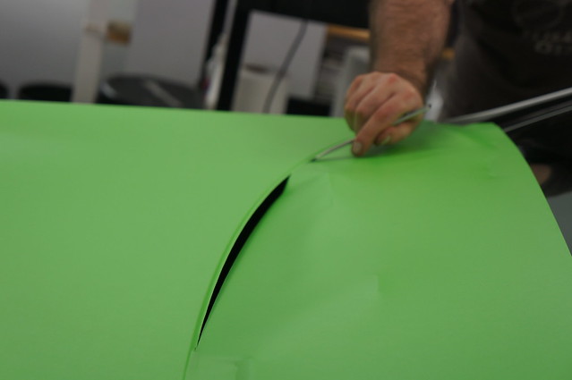

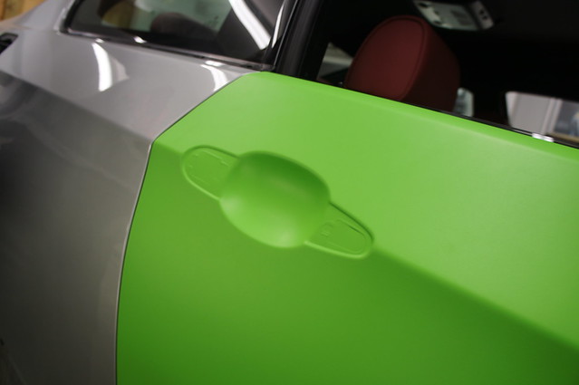

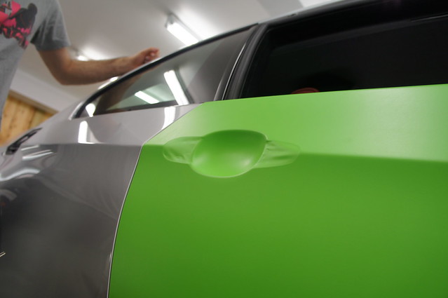

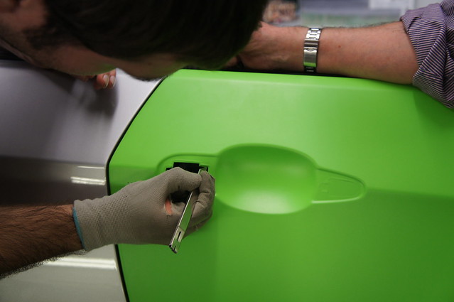

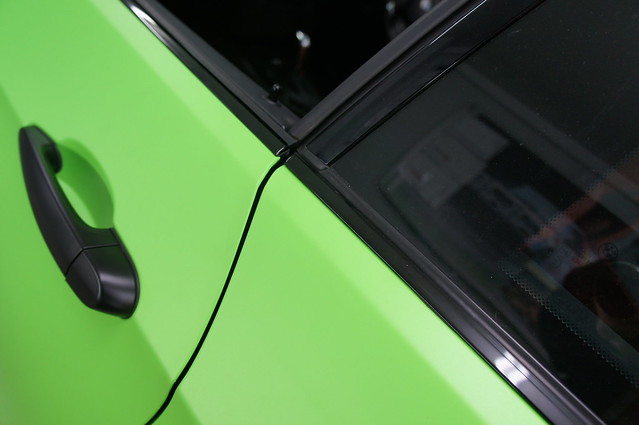

Next the door handle recesses were moulded:
DSC05008 by RussZS, on Flickr
Centre first:
DSC05009 by RussZS, on Flickr
DSC05010 by RussZS, on Flickr

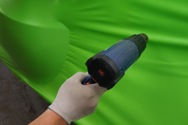

The film was then heated up to 90 degrees to reset its 'memory' to ensure it doesn't pop back out at a later date:
DSC05012 by RussZS, on Flickr
DSC05014 by RussZS, on Flickr

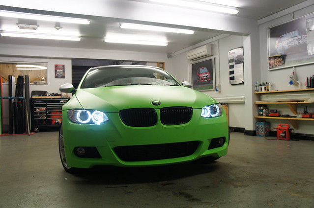

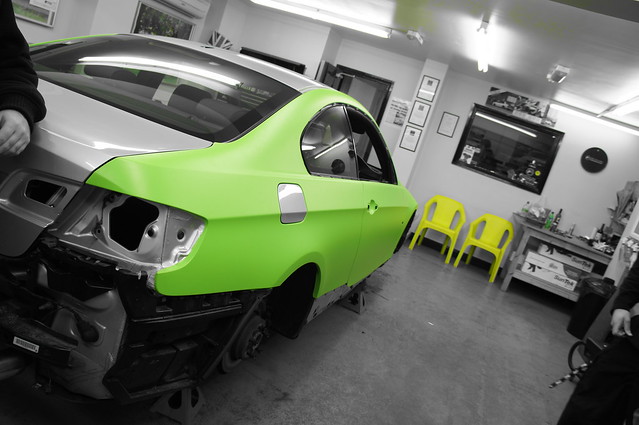

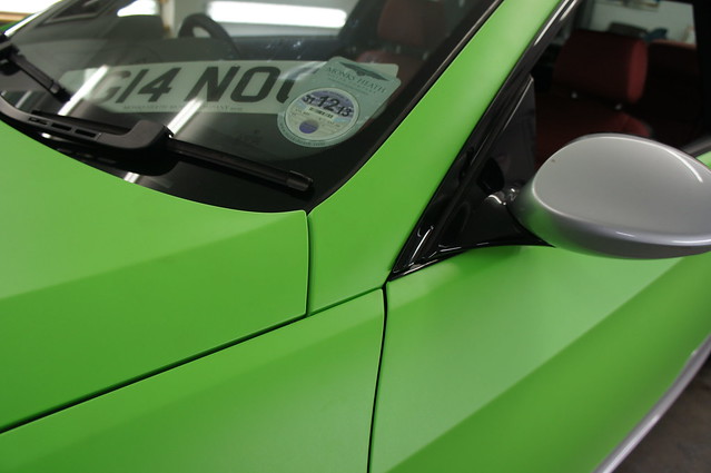

The following pics are from the rest of the installation process:
It's very green!
DSC05027 by RussZS, on Flickr
DSC05025 by RussZS, on Flickr

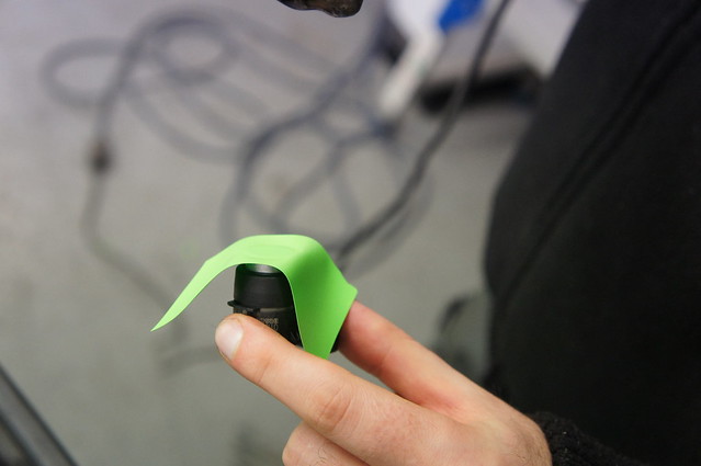

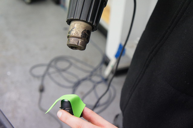

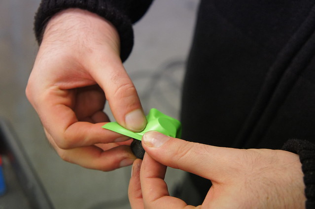

Rear parking sensors removed and wrapped individually (this is not the case for every sensor as some will not work correctly!)
DSC05030 by RussZS, on Flickr
DSC05031 by RussZS, on Flickr
DSC05033 by RussZS, on Flickr
DSC05037 by RussZS, on Flickr

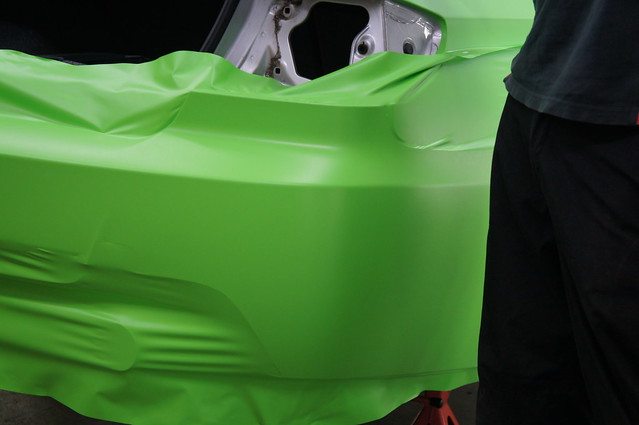

Rear bumper:
DSC05039 by RussZS, on Flickr
DSC05040 by RussZS, on Flickr
DSC05044 by RussZS, on Flickr

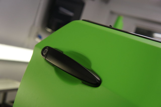

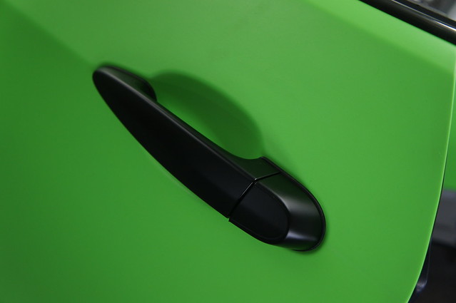

Door handles wrapped in APA Satin Black:
DSC05056 by RussZS, on Flickr

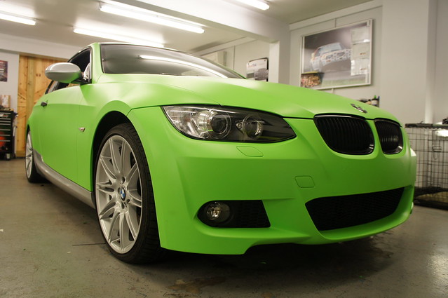

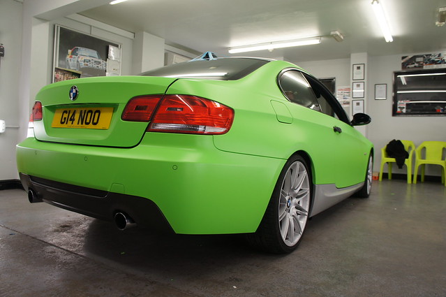

Unfortunately we ran out of time by the end of the third day with the roof, skirts and wing mirrors still to complete - which we will do in the next few days.
We also have a set of CSL wheels which will be fitted to the car and we need to refit the carbon spoiler soon too.
We're still debating what colour to wrap the roof, wing mirrors and what colour to recolour the wheels, so any suggestions would be most welcome :)
Some 'finished for now' shots:
DSC05061 by RussZS, on Flickr
DSC05062 by RussZS, on Flickr
DSC05065 by RussZS, on Flickr
DSC05066 by RussZS, on Flickr
DSC05068 by RussZS, on Flickr
DSC05069 by RussZS, on Flickr
DSC05070 by RussZS, on Flickr
DSC05071 by RussZS, on Flickr
DSC05072 by RussZS, on Flickr
DSC05073 by RussZS, on Flickr
DSC05077 by RussZS, on Flickr
DSC05079 by RussZS, on Flickr
So in summary I felt that we have achieved our objective of starting off on a very strong position and am extremely happy with the quality of this overall wrap, despite it being our first attempt.  We will now follow with another 5-6 cars quite quickly which will also be full strip down colour change wraps, including my own Edition 30 before I sell it.
