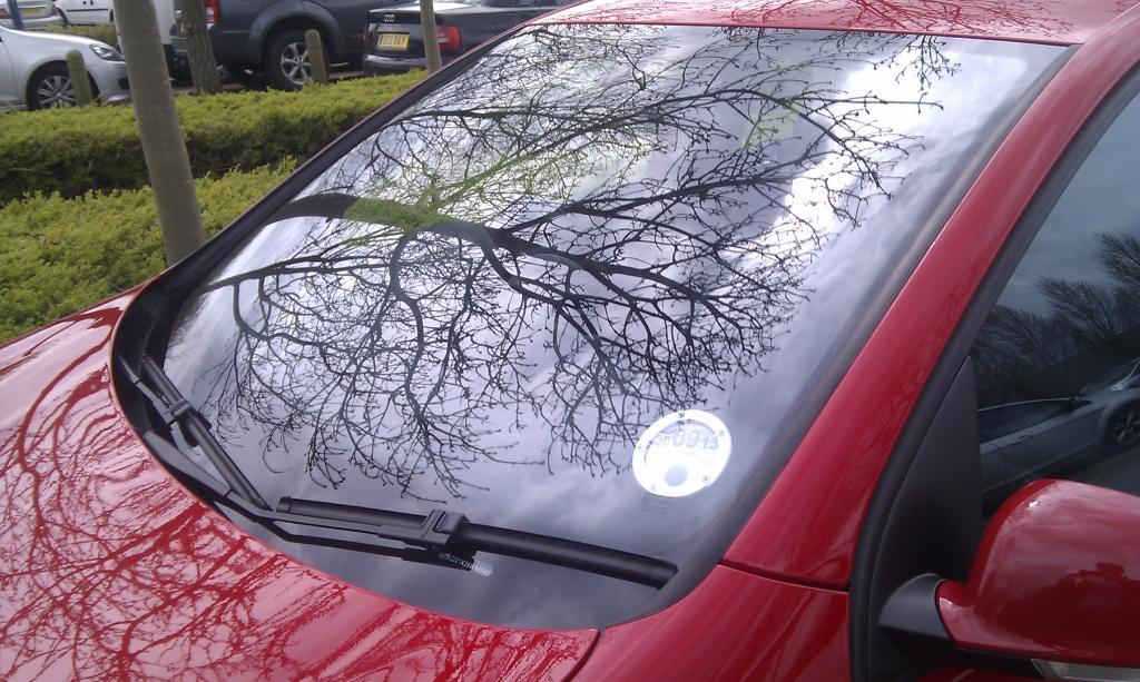

Got a new blue tint front screen fitted today as old one have a few big chips and lots of marks etc.
Clive at All Glass Winscreens fitted, top guy and great fitting skills, does all VW main dealer glass. If need any glass fitting give him a call on: 07885968551
Very pleased with the results, nothing beat fresh clean smear/crack free glass!

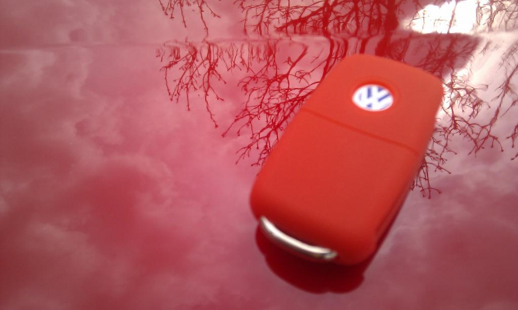

Also my silicon red fob cover arrived:
Nice match for the TR paintwork:

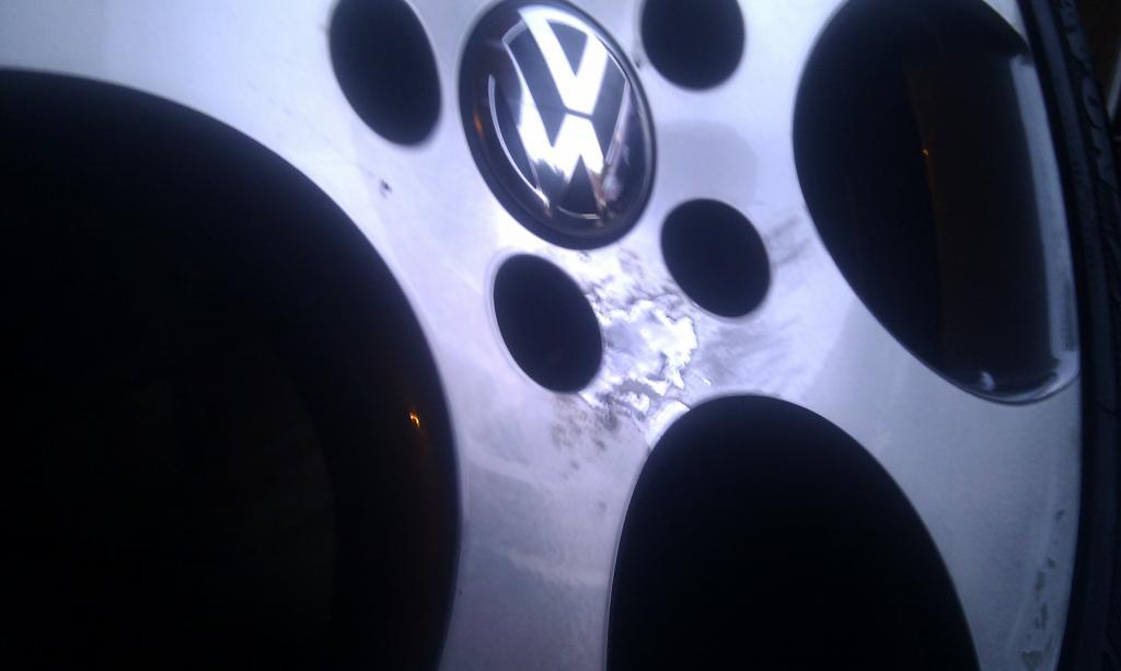

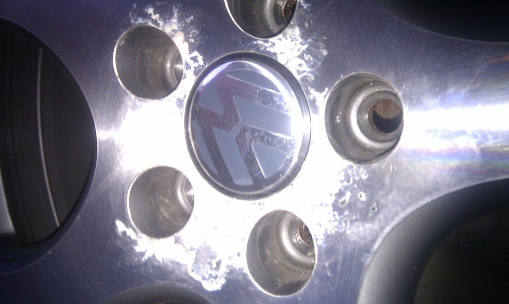

So started to refurb the Monzas.
Condition was ok, just the usual whiteworm and a few curb marks.
Jacked the car up and removed the wheels:
Gave them a quick wash:

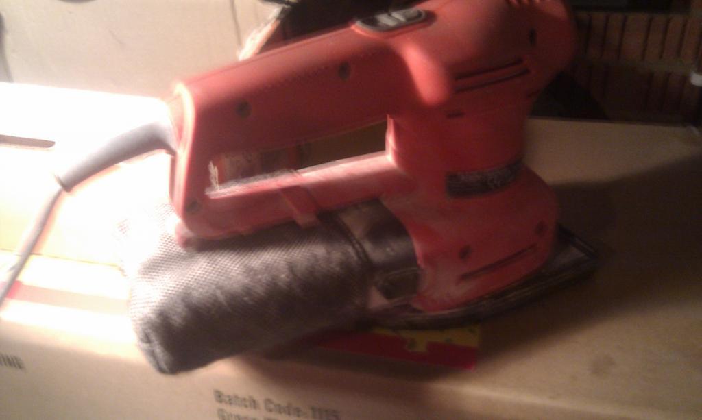

Started off by rubbing them down with a power sander to get the worst off:

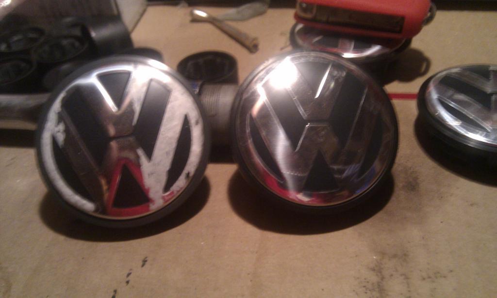

Picked up some new VW centre caps:
After sanding:

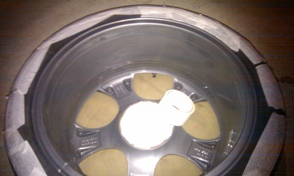

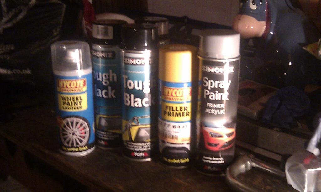

Then sanded by hand with 600, 400, 240. Paints I am using:

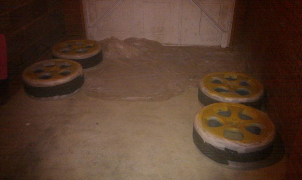

Started to mask the wheels up:

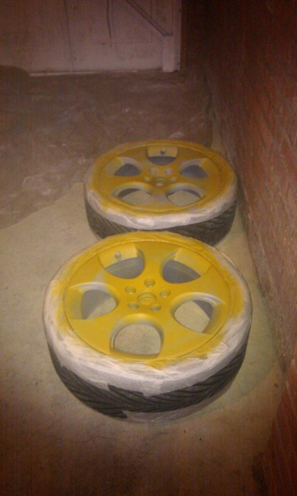

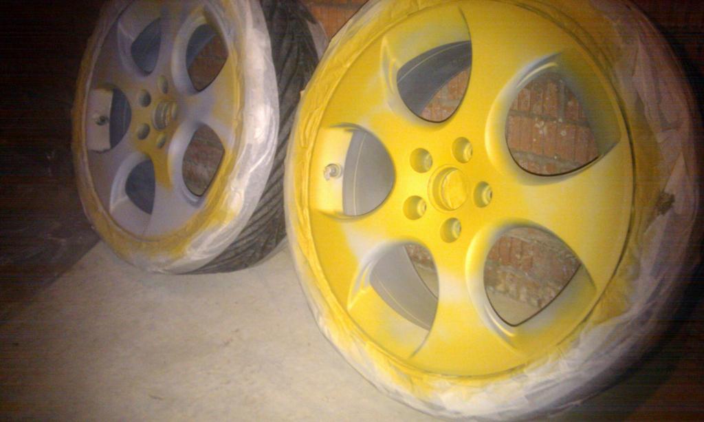

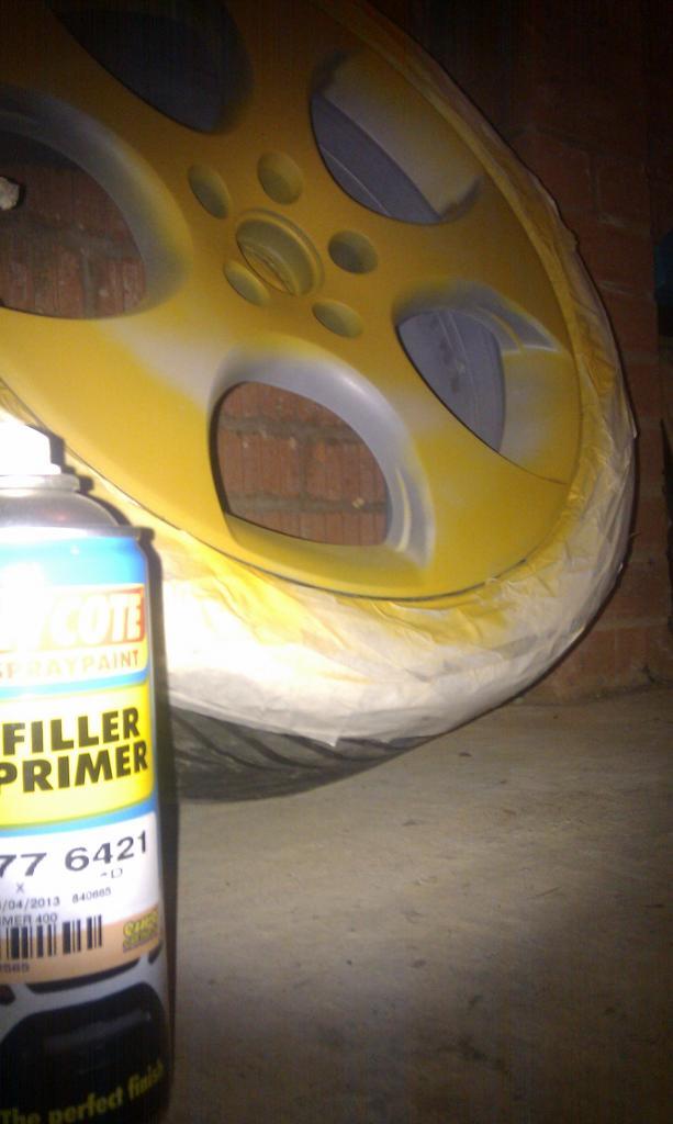

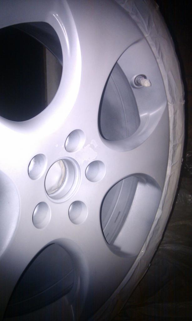

First coats of primer and filler primer:
How they stand at the moment:
Letting them drive for 24hrs, will then wet sand tonight and see if need anymore filler primer before top coat and then clear.

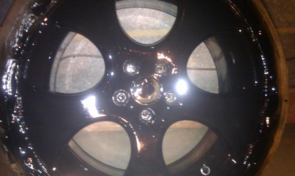

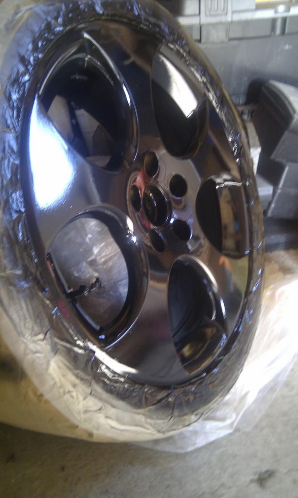

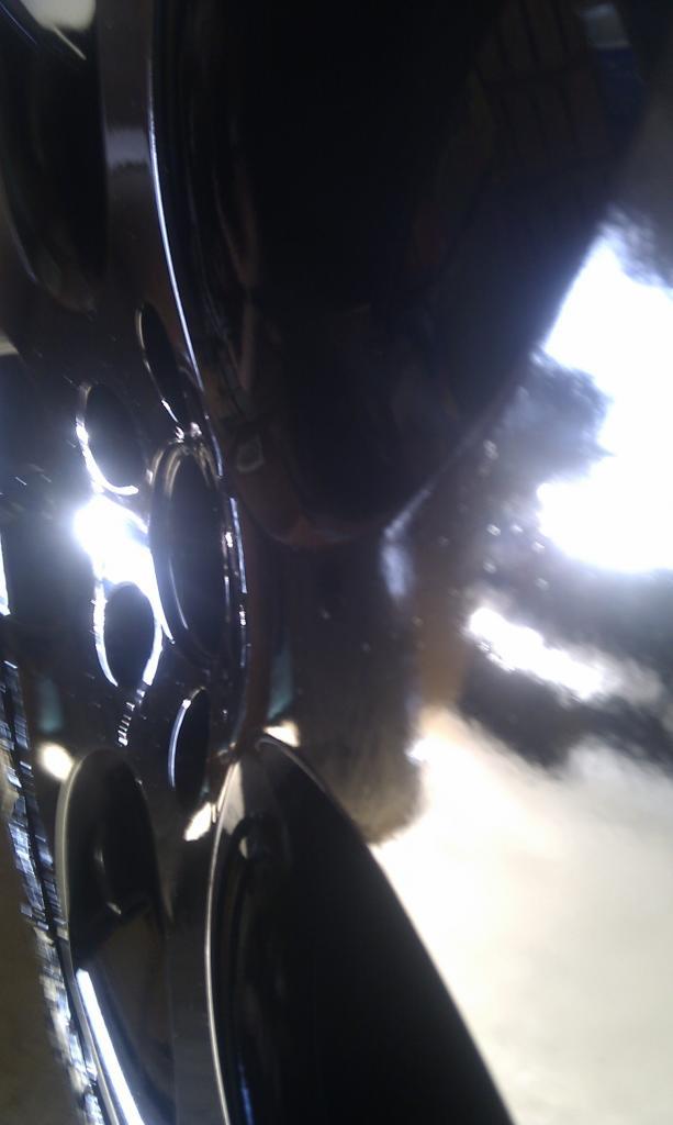

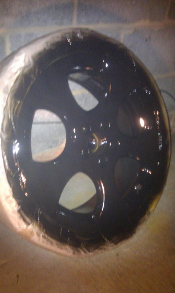

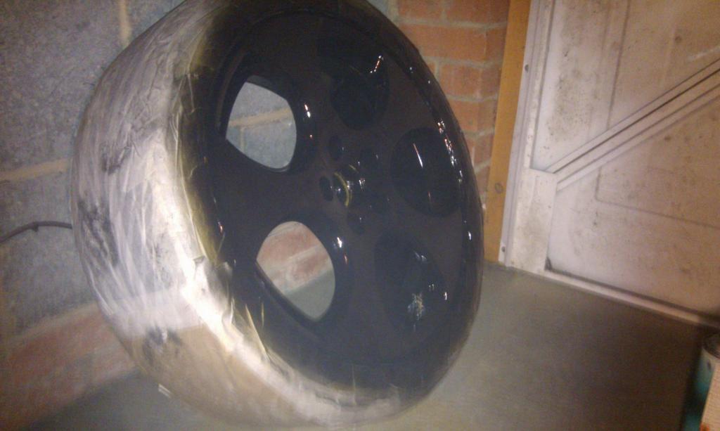

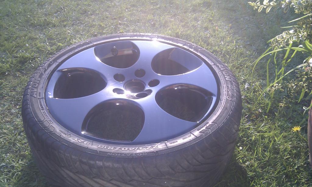

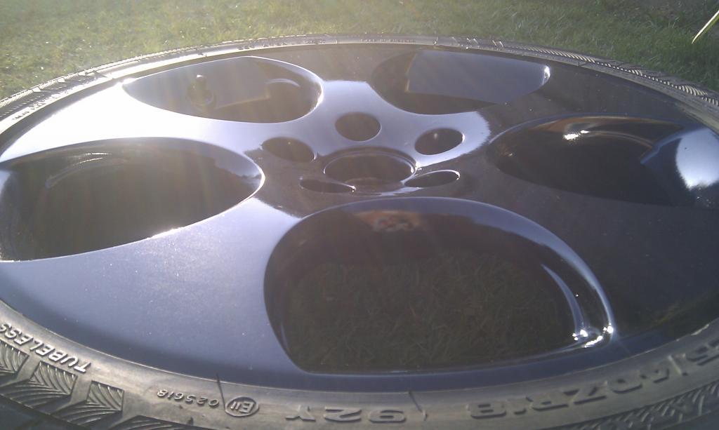

Got some coats of the Simoniz Tough coat Gloss black on:

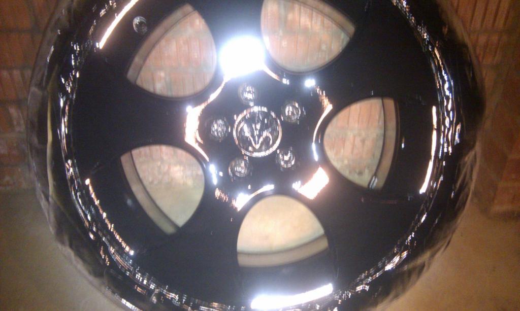

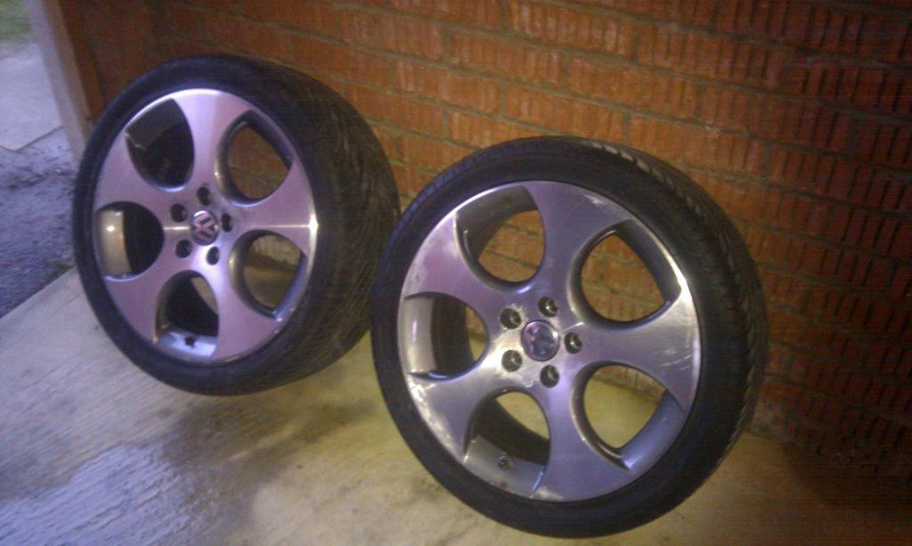

« Reply #41 on: May 04, 2013, 11:10:59 pm »
Cheers mate.

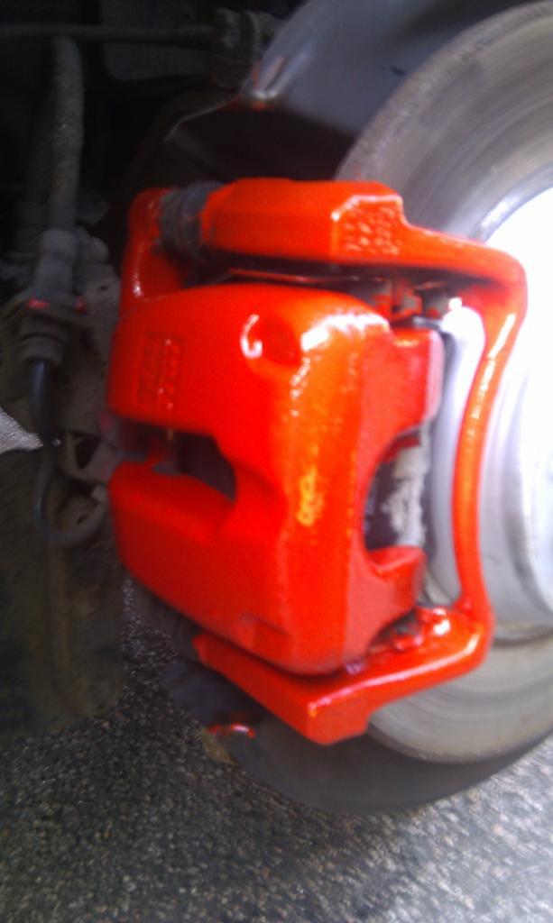

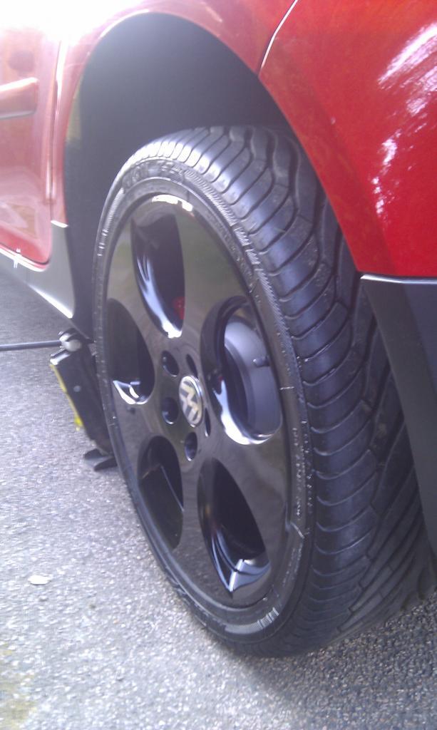

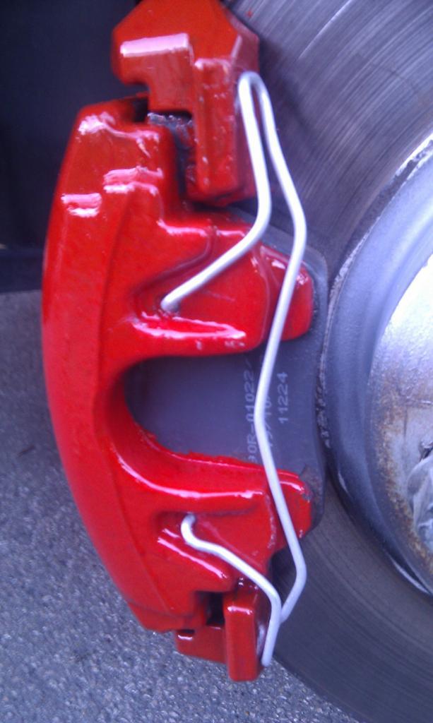

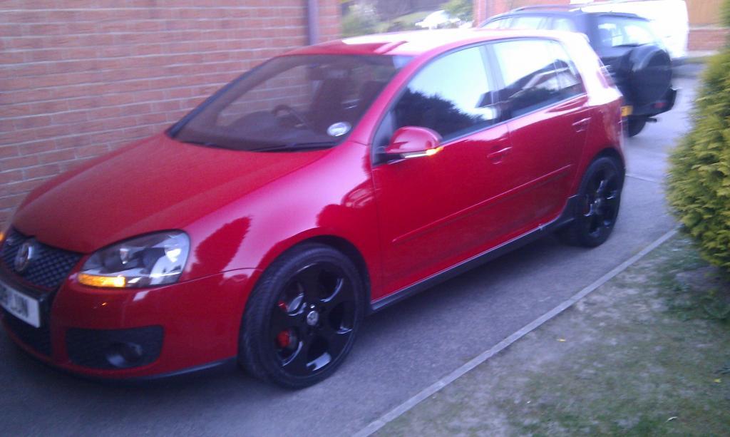

Refurbed a few of my wheels over the years. Never get as good results as professional powedercoating process, but only spent £20 on paints. Like with everything, preperation is the key. Morre time spent rubbing down and primer the better the outcome. In all spent a few evenings on these. Masking tyres up took a long time too.
Results, as wheels where off, freshened the calipers up with some hammerite gloss red paint:
And the wheels:
Sorry about the phone pics, need to get out, clean the car and take some decent shot asap.
