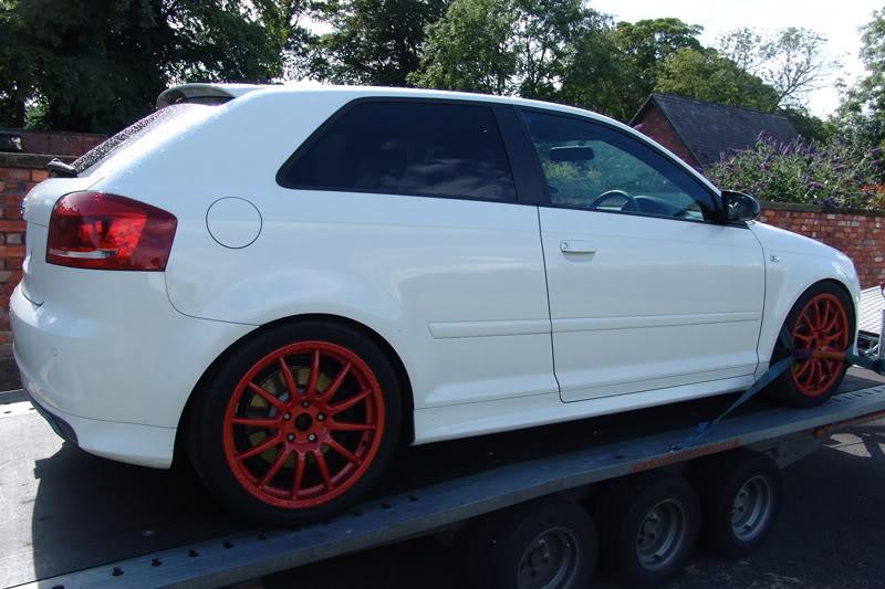

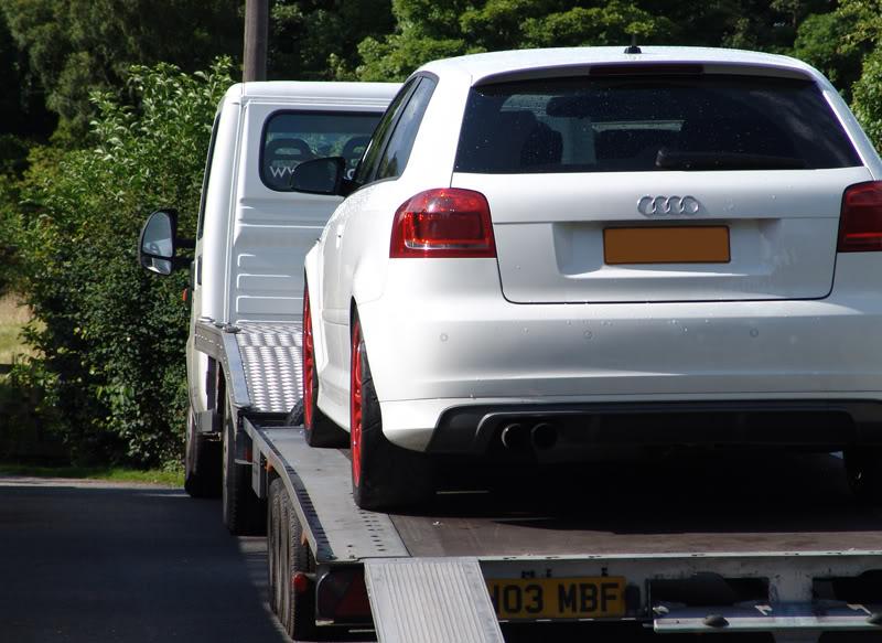

« Reply #23 on: July 23, 2009, 04:58:36 pm »
Here we go!  :scared:

« Reply #29 on: July 23, 2009, 05:38:26 pm »
can i just ask did you know about the piston when you got it ?????  and the red wheels look awesome i nearly did that but chickened out  :chicken:
