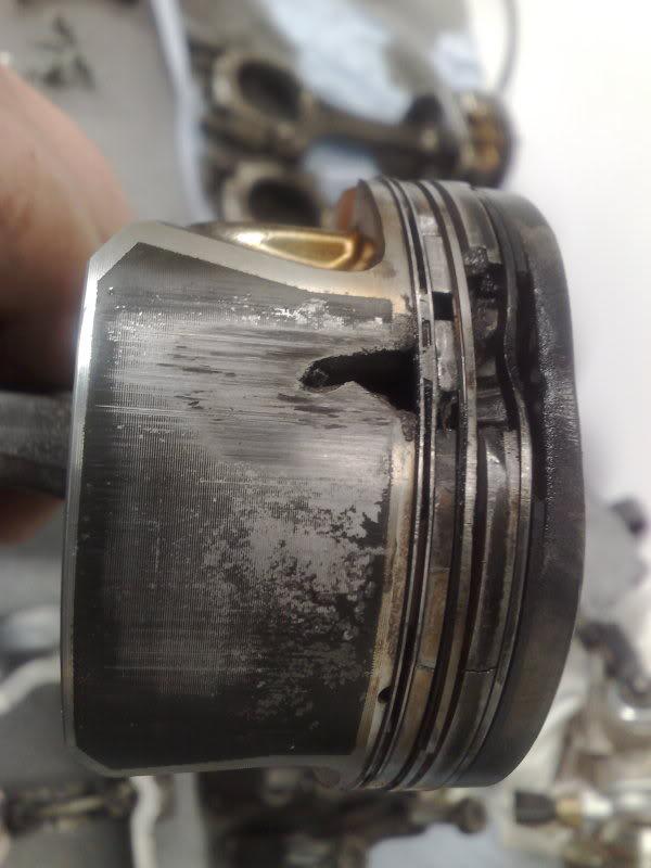

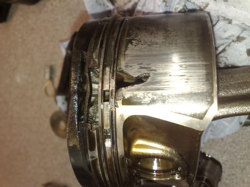

Damaged piston.. (Not for the faint hearted!!)
Strange thing is that the crown of the piston is ok, this leads me to believe that it was more a lack of oil / sh*tty oil problem rather than pre ignition as surely there would be damage to the crown if this was the case?
That does look a lot like damage from detonation (most probably crap fuel) Detonation will usually be shown on sharp edges, so usually goes down to the rings and starts eating away there... as its done in your pics.
i would struggle to see how bad oil could do something like that.
Good to hear its on the road to repair tho

If the top of the Piston crown was detonated, i would agree, but the top of the piston that ive read says its fine, so wouldnt really point to crap fuel. Lack of Lube maywell have caused it, BUT if thats the case, why arent  cylinders 2,3,4 like that??.If the other cylinder are showing signs then id be looking at potential bad fuels, but im not so sure imo.
Engine overheat from lack of cooling is possible,(and looks like it from the photo's tbh) cylinder furthest from the water pump would be 1st to cop it from my experiance. Poor Lub would again show(or signs of) on all cylinders not just one.
Again, the damage shown is only minor!, compared to major engine failure which that isnt no way near that stage.
What condition are the Piston and Oil scraper rings like Jonny on the other Pistons?. Signs of jamming or carbon burn past the lowest compression ring?
All the other pistons look mint to be honest.. Didnt have a really close look, but enough to notice that they all seemed ok..

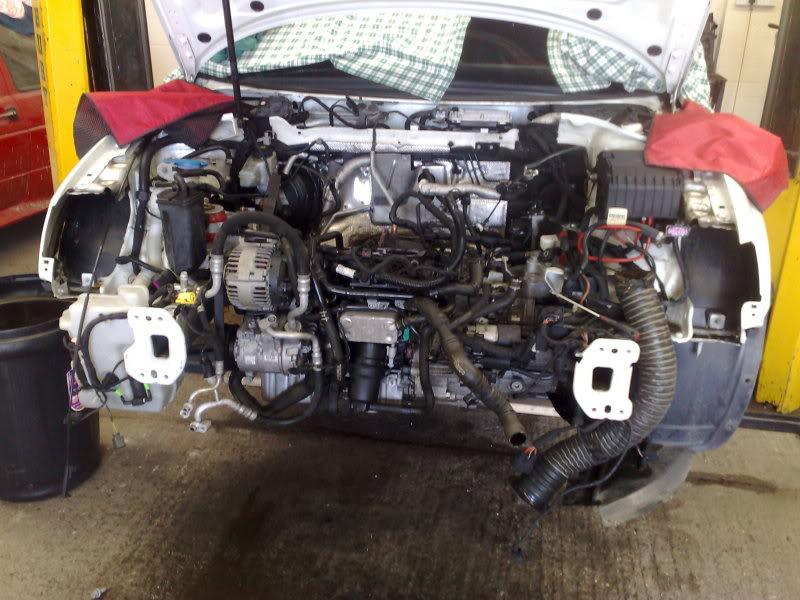

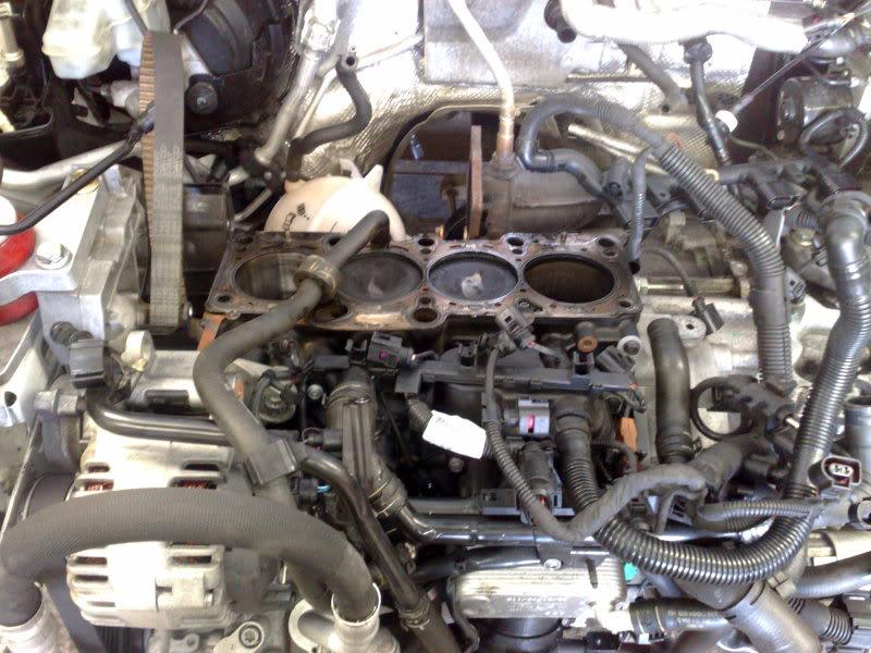

Head off..
That is an amzing amount of damage to the piston, not to have damaged the cylinder more.

I know, I was shocked.. But its a good thing for me!!

OMFG , I cannot believe that hasnt taken the whole block with it ! you must have only just caught it ....
given the revolutions the pistons do , thats not been up and down too many times once its started to fail.
maybe it was a weak spot or manufacturer casting error ? esp with a chunk out after  the last ring that has sharp not rounded edges.
in terms of it being cylinder 1 , anything special about that one? (I assume its the same firing order etc like the golf , and cyl3 is still the longest inlet tract? as thats where the expected detonation would happen first/worst)
