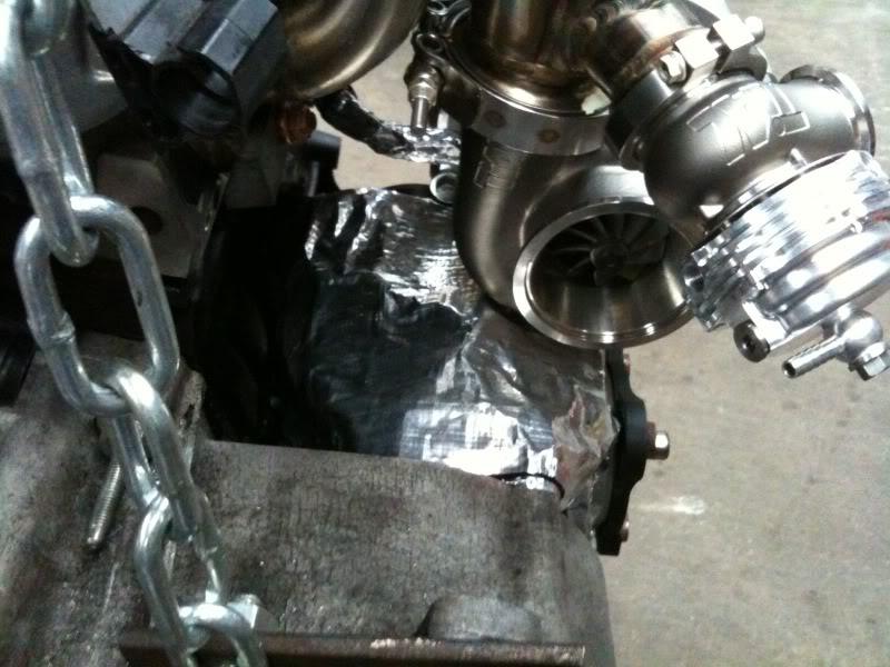

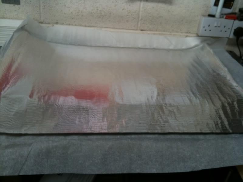

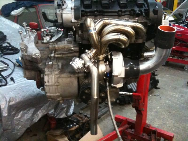

The clearance between the exhaust housing of the turbo and the transfer box was very small, around 12mm and as little as 8mm in certain places so I decided to use the new Zircoflex material from Zircotec to shield off all of the transfer box, any anything that would be subject to heat from either the turbo or manifold..
Some pics..
£100 worth.. humm, hope its good!
Transfer box covered with 3 layers..

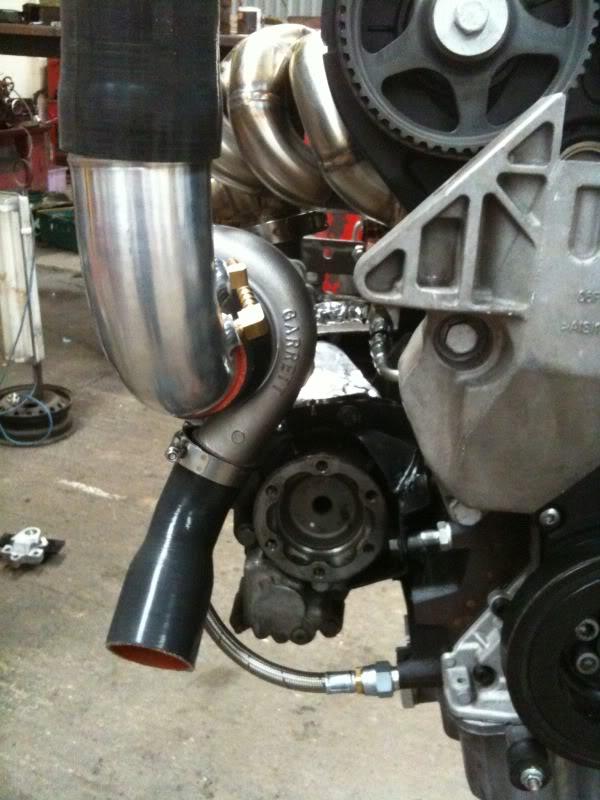

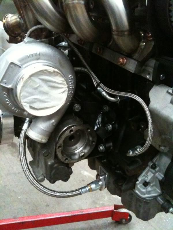

All of the lines from the turbo have also been wrapped in the ceramic matting, which will protect them from the heat..

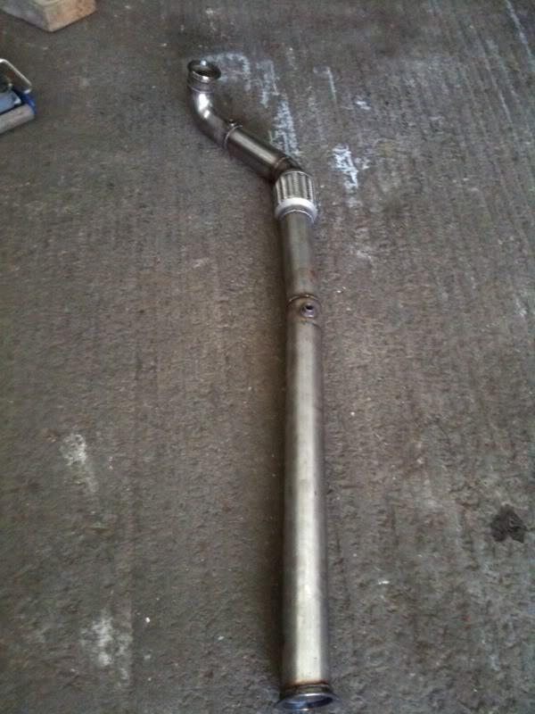

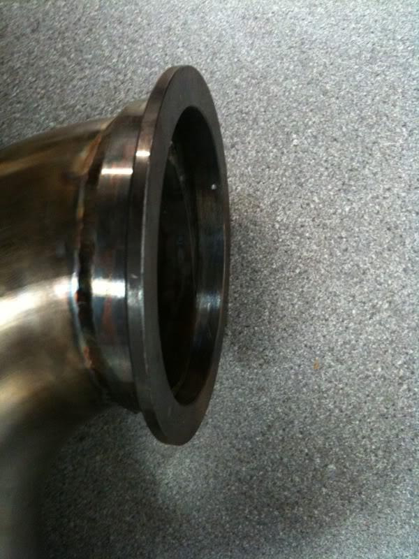

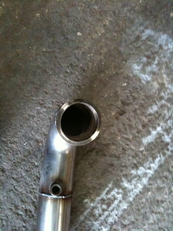

Next thing that needed to be worked on is the downpipe, this is not yet finished but some pics of the mocked up downpipe.. Features full 3” Tial V-band connector and high flow flexi.. Will have some better pics of this tomorrow all wrapped in exhaust wrap..
The downpipe required lots of work, obviously the kit is designed for the downpipe to run centrally down the tunnel, exactly where the prop sits on my car, so we had to go round and under the shift cables and down the left hand side of the prop with the downpipe..
The dump tube will exit down the other side of the prop..
Whilst everything was out we took the opertunity to strengthen the rather flimsy looking support bracket for the transfer box, all helps..

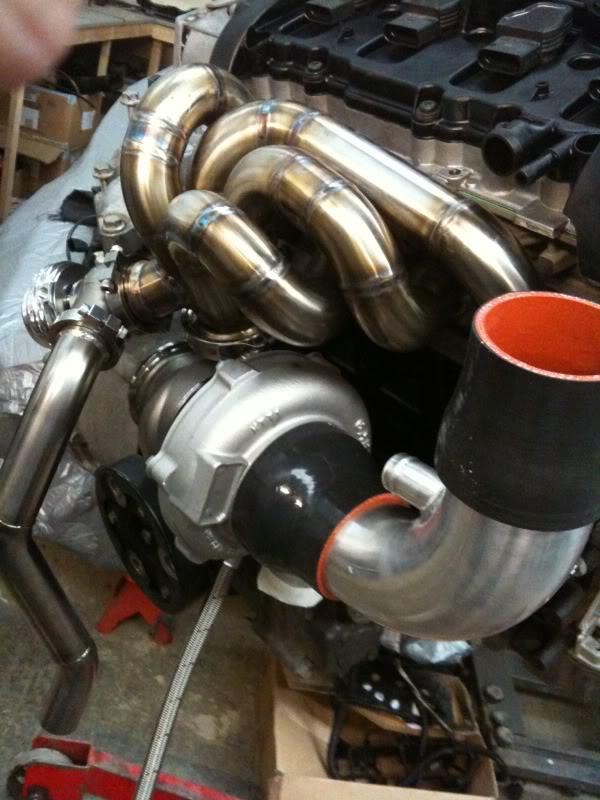

A pic of the fully mocked up turbo (complete with intake pipe) manifold, wastegate and dump tube
This pic shows just how close everything is..
And some nicely routed lines, all tucked away as much as possible whilst retaining a good flow..

Jonny, with the turbo and the transfer box being sooo close together. I take it you have allowed for any possible expansion when everything gets rather warm?
Offline jonnyc
  • Posts: 2180
  • Herrooooo!
Re: JonnyC's Audi S3 Project..
« Reply #338 on: September 08, 2009, 06:01:15 pm »
That really is my only worry, I have no idea how much the manifold will grow when its hot, and in what direction, need to get it hot then have a look, thats about the only way we can do it..
If its a problem then it will require the manifold being reworked to raise up the position of the turbo, but then it would mean downpipe and dump tube would need to be re made also.. I really hope it doesn't come to that!
fingers crossed I suppose!  :scared:

On the braided lines in the last pic, have you used Nylon Ty-wraps?  Might be a bit warm for them in that area?
But good luck with the first running tomorrow.
 :smiley:
Offline jonnyc
  • Posts: 2180
  • Herrooooo!
« Reply #340 on: September 08, 2009, 06:54:31 pm »
 :smiley:
Thats only mocked up with cable ties, there is a bracket there now..
