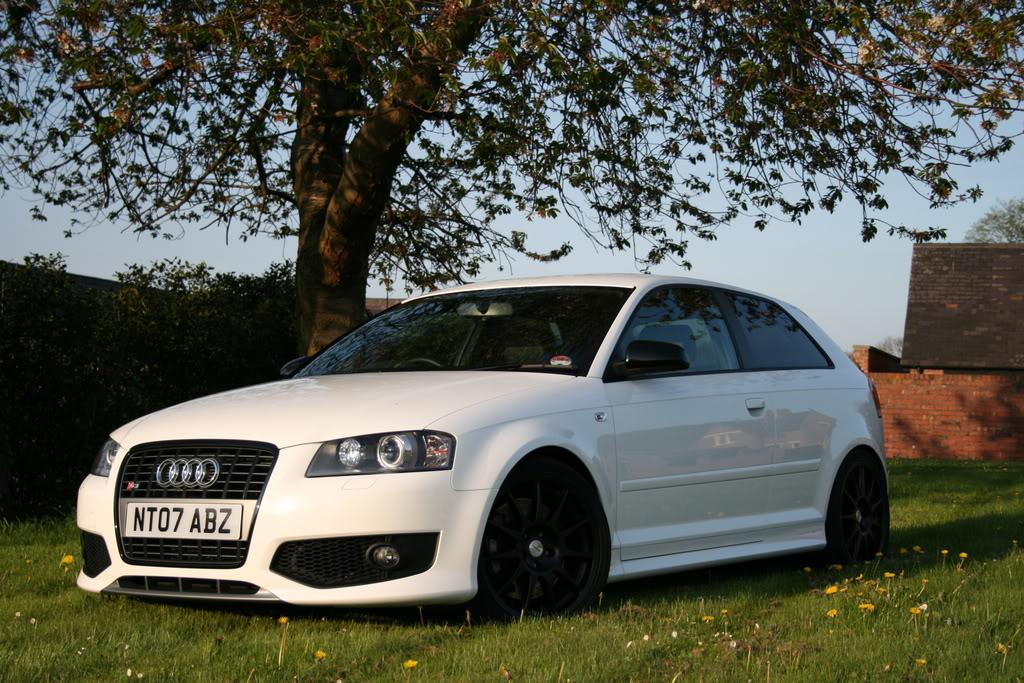

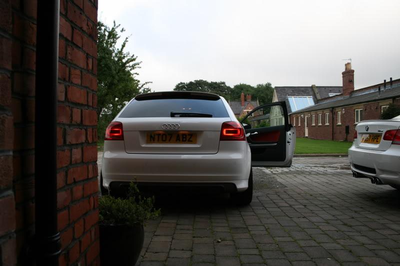

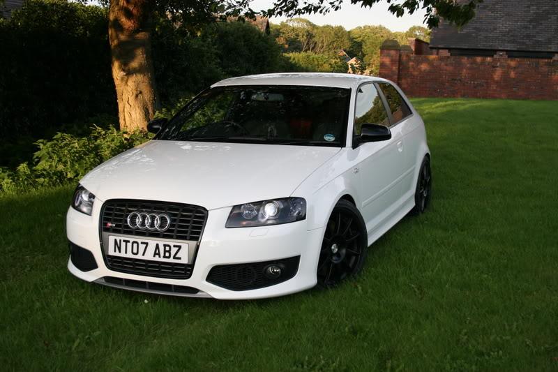

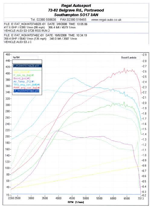

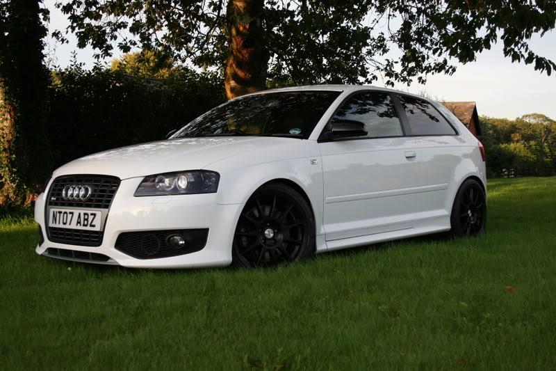

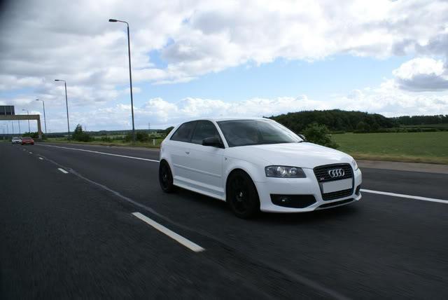

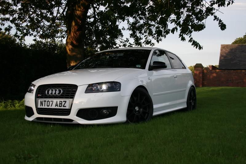

I bought the car new back in 07' and it went through quite a transformation, from a high spec standard car to the first big turbo MKII S3 in the UK, and I think at that point, the world!
Here are a few pics of the transformation, pics speak for themselves..
I then sold the car and pursued the MK5 ED30, building (on a standard turbo) the fastest MK5 GTI in the UK (despite what some people say/claim) The fastest 2.0T FSI powered car in the UK and the the fastest DSG MK5 in the world, and all on the standard K04 turbo..

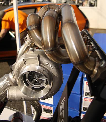

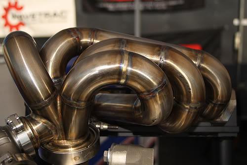

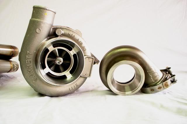

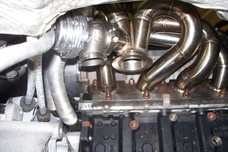

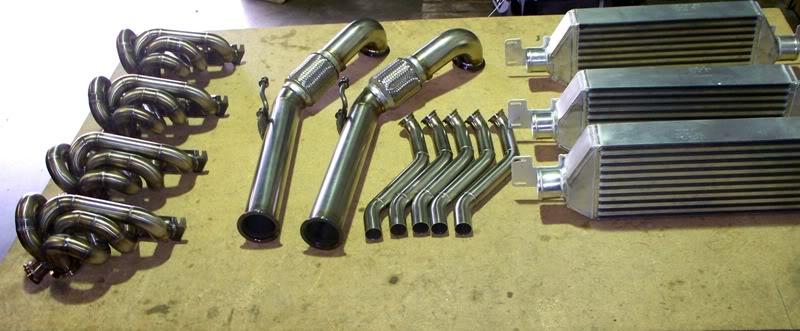

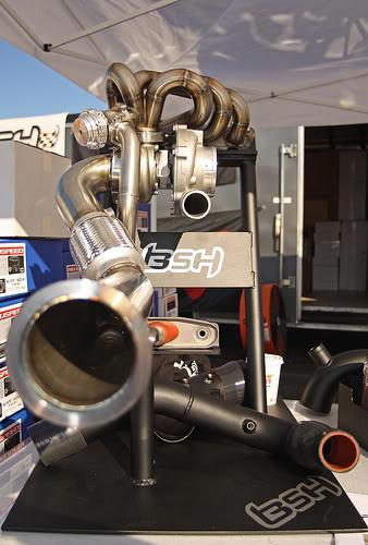

Heres some pics of the turbo kit, I considered the ATP kit, but this will make far more power when its really being pushed, and the Tial v-band stuff is so nice! I want to do this once, and right the first time round! For sure I would be able to do it far cheaper, but this is going to be a no compromise project, and a one of a kind car for a long time to come!
The end goal is 600hp and 1200kg.. That would make for a 500hp/tonne power to weight ratio.. Similarly powered Evo's run 10's no problem, and that is the aim for this car.. 10 second 1/4 mile on STRAIGHT pump fuel, no additives, no nitrous, just fill it up with V-Power and go!

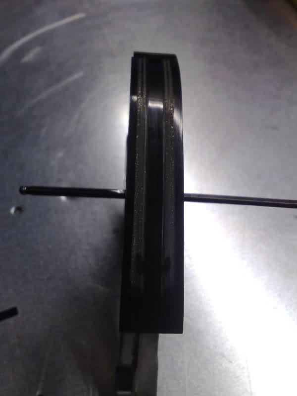

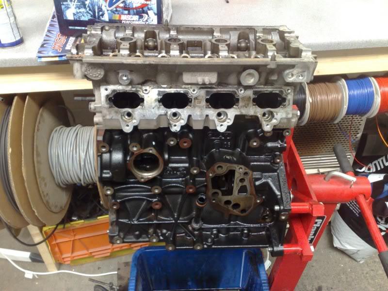

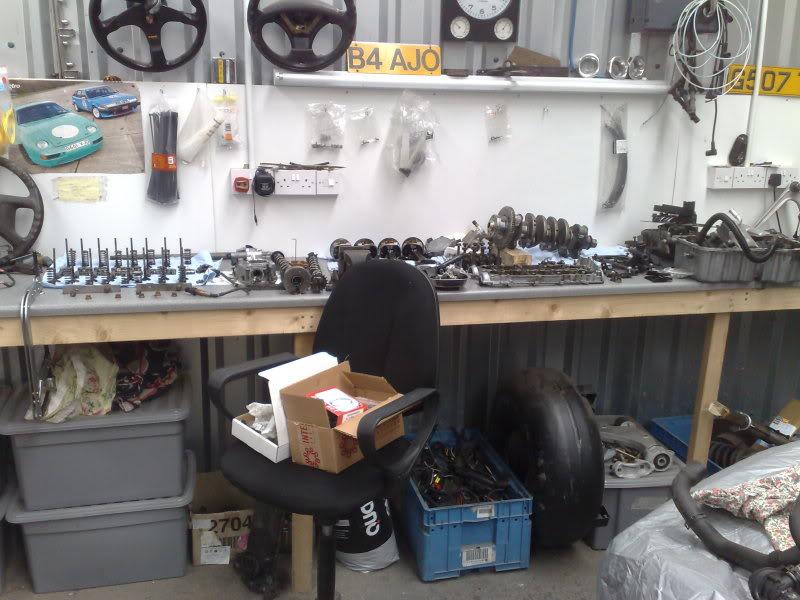

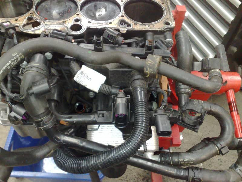

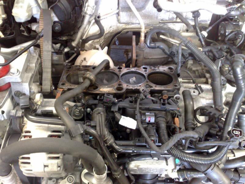

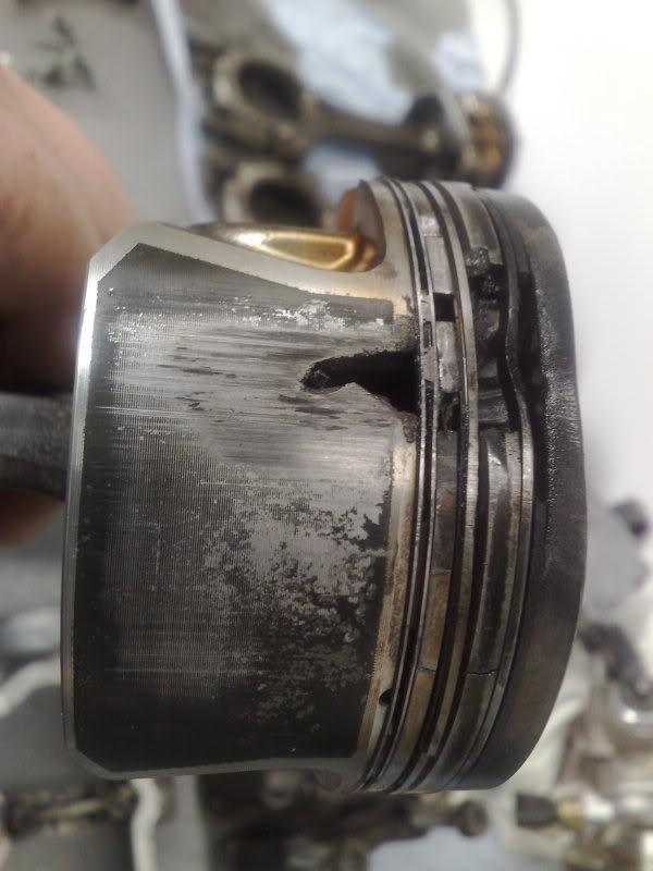

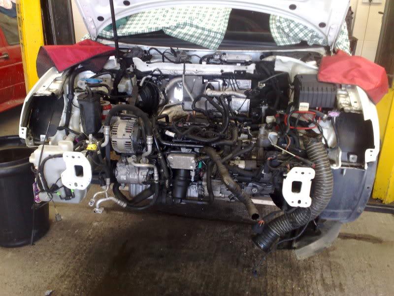

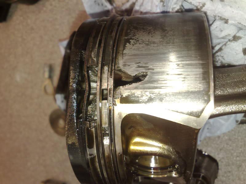

Engine is all apart now and the true extent of the damage to the piston can be seen, pretty shocking really! Amazing that the damage to the bore was so so light, I mean, you could hardly even feel it.. 0.5mm bore out will remove that no problem and I should be good to go with the 83mm bore pistons..
Damaged piston.. (Not for the faint hearted!!)
Strange thing is that the crown of the piston is ok, this leads me to believe that it was more a lack of oil / sh*tty oil problem rather than pre ignition as surely there would be damage to the crown if this was the case?

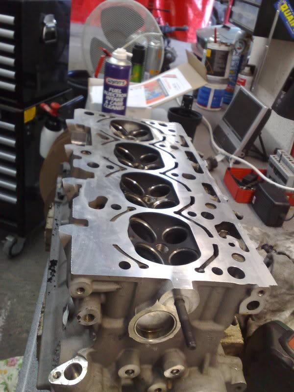

Head off..
Engine out ready to be stripped down..

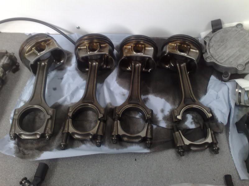

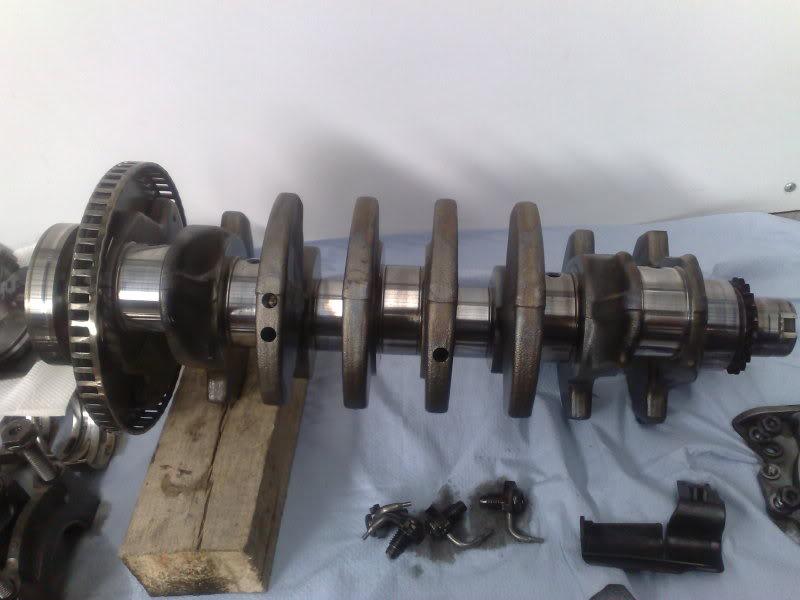

Old pistons and rods.. (All the rods look in top condition, amazingly the bearings are all in perfect condition too)
Crank.. (Again, no damage..)

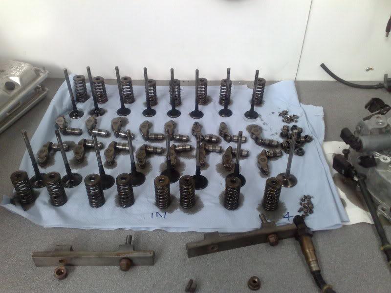

Valve train..

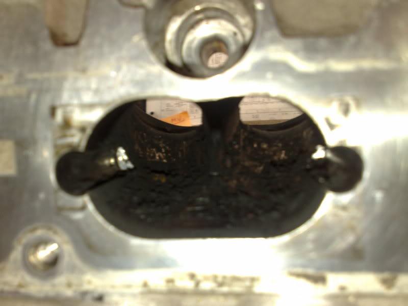

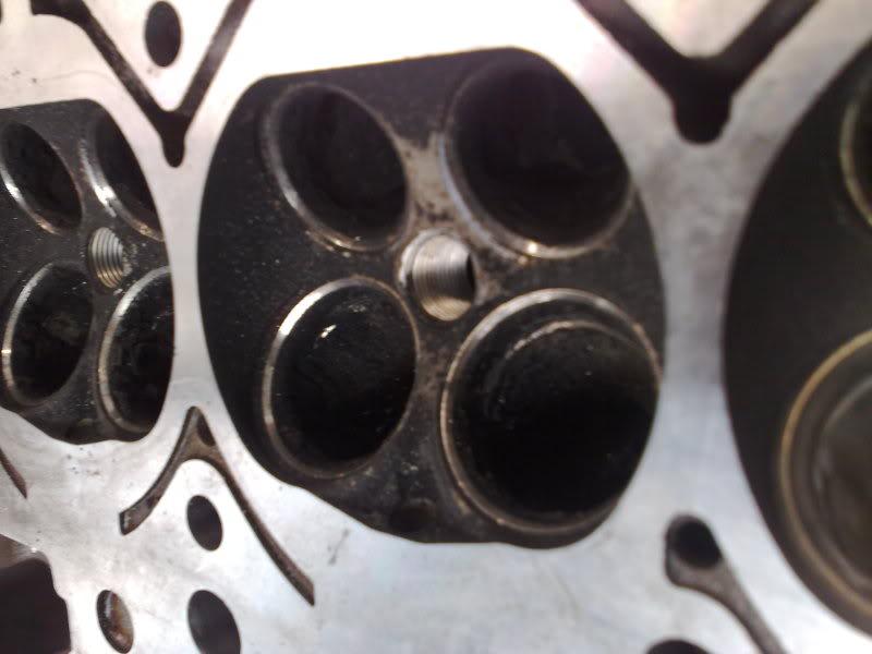

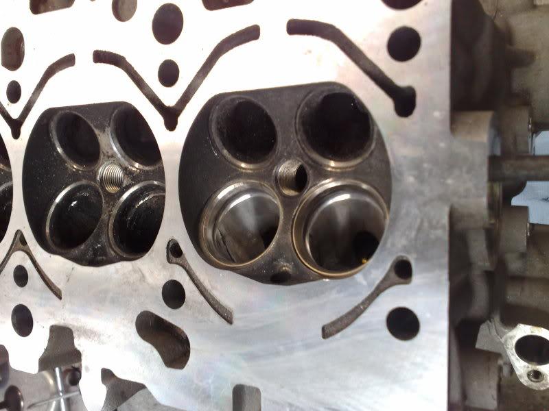

Intake valve.. (all of them look like this, because of the recirculating PCV system, just shows how important it is to run a catch can with this engine)
Block and head ready for machining..
Lots of bits..
The engine should be back from the machine shop Thursday and be fully built up with the new parts by the end of the week.. So thats good news..
One thing that was pretty amazing was the weight difference between the Supertech valves and the standard items.. Huge difference, ill get a figure to compare but a lightweight valve train can only be a good thing..

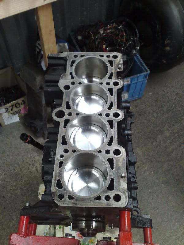

So!! The block is back, re-bored to 83mm for the new pistons, and everything is perfect, luckily enough the 0.25mm on the bore wall was enough to remove any damage from the piston.. In fact, the machine shop said that a heavy hone would have been enough, I think if it was going to be running standard power then yeah.. But with the plans that I have for the car immediately and in the long term, I want to make sure that this engine will be able to take everything that I throw at it!!

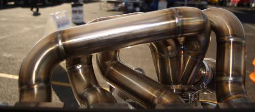

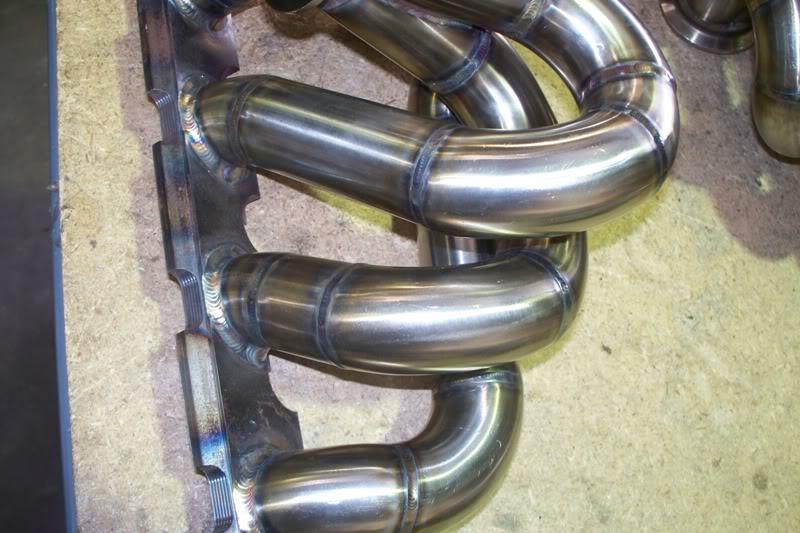

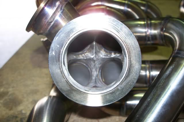

Thought I would post up a few more images of the turbo kit that BSH have just released.. (part of my kit is on that table I believe)
Can't wait to see this stuff on the car! Looks like amazing work!!

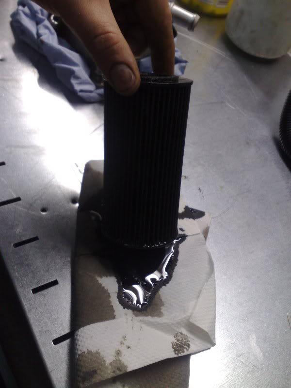

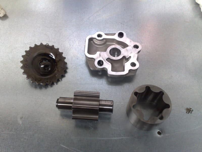

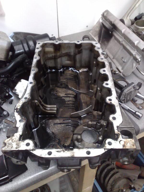

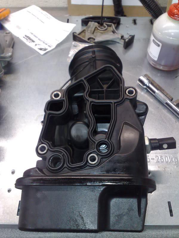

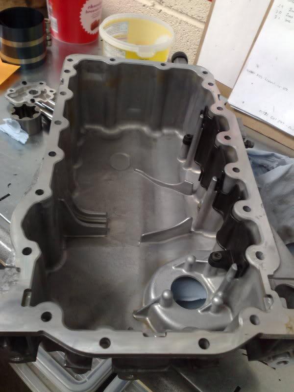

Couple of annoying things have been found, not going to make any difference to the build but just pisses me off how people can neglect a car so badly..

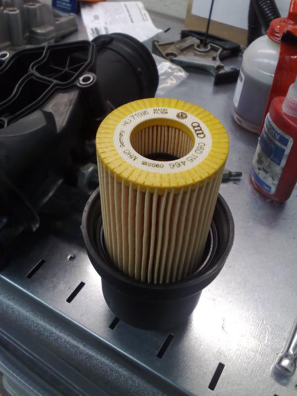

This is the oil filter
And the sump..
Notice the gunge that is coming out of the filter, and the sh*t that is sat in the sump! This is after being flushed out, the stuff you can see is residual gunk that has been dislodged! Its almost the consistency of tar, just shows that there is no way the car has been regularly serviced as suggested by myself..
Luckily all of the bearings on the crank and oil pump look mint!
The only damage is some wear on the oil pump chain tensioner, so that will also be changed..
The oil and water gallerys were in perfect condition with no metal particles or blockages.. The oil pump is in perfect condition. Im having the oil cooler changed out of precaution as there is a super fine matrix inside which could easily hold metal particles.. Better to be safe than sorry really, especially as the whole engine is going to be basically new!

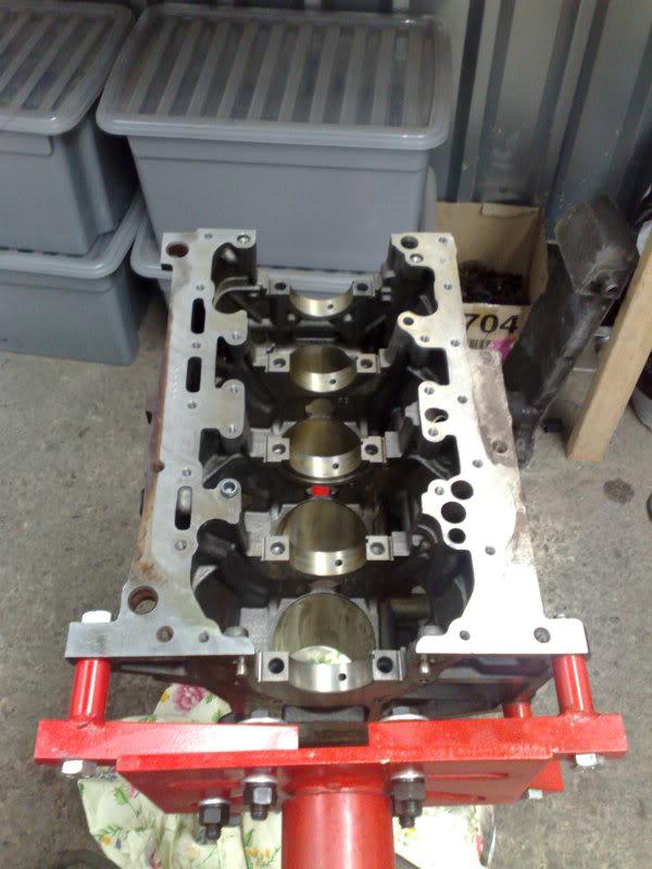

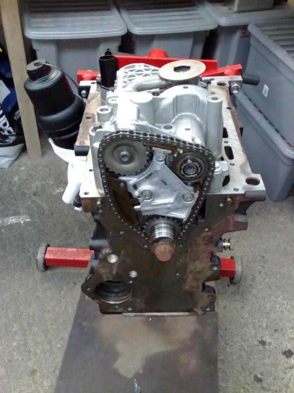

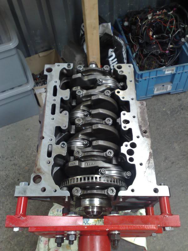

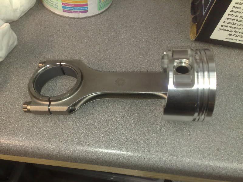

Engine is coming along nicely, block is built up with the new pistons / rods and crank and the head is back from being skimmed tomorrow and will be fitted with the new Supertech valve train parts hopefully by the end of the day!
Heres some pics..
New piston and rod combo
Clean..
Machined block.. 0.5mm overbore
Built bottom end..
So coming along pretty well, engine and all ancillaries will be built up tomorrow so that the engine is sealed and can be wheeled in and out of the engine compartment of the car when testing the fit of the turbo kit!

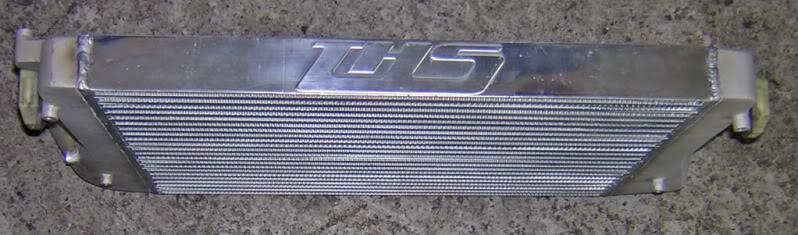

First of all this little thing arrived yesterday!! Thanks to Neil and Ollie at THS..
Core is rated to 600hp so should be up to the job!!!

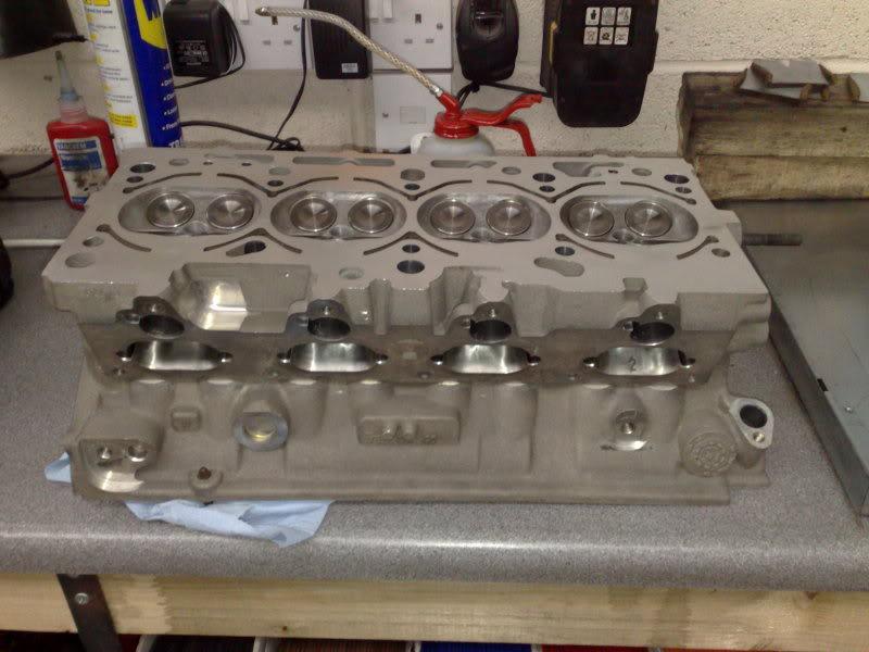

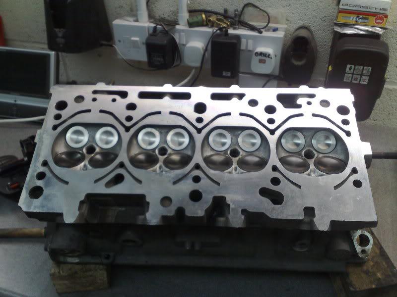

First of all the engine build.. Parts are all here now and the head is all built up. Ported and polished and fitted with the new Supertech parts!
Head back from being skimmed, 30 microns were removed, so not much.. At this point the internals of the head had not had any attention!
Before..
About an 1/8 of an inch of build up!! Crazy really..
After..
Check out the inlet ports!!
Before..
And after, you can see a small difference!!
Everyone that has seen the state of the inside of this engine has been shocked. Its got nothing to do with the piston problem that I had. This is just how the 2.0T FSI runs with the stock PCV system, pretty nasty really!!

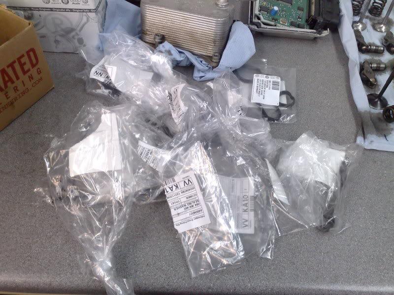

More bits, stretch bolts, seals, gaskets etc etc etc.. Now the bottom end is all built up, oil pump is back on, everything cleaned up and a new filter!!
Happy about all of the progress on the engine build! Nothing is being left to chance so everything is being replaced.. Not the cheapest way of doing things but I know for sure that im giving the engine the best chance possible of lasting and being strong enough to cope with the power.
