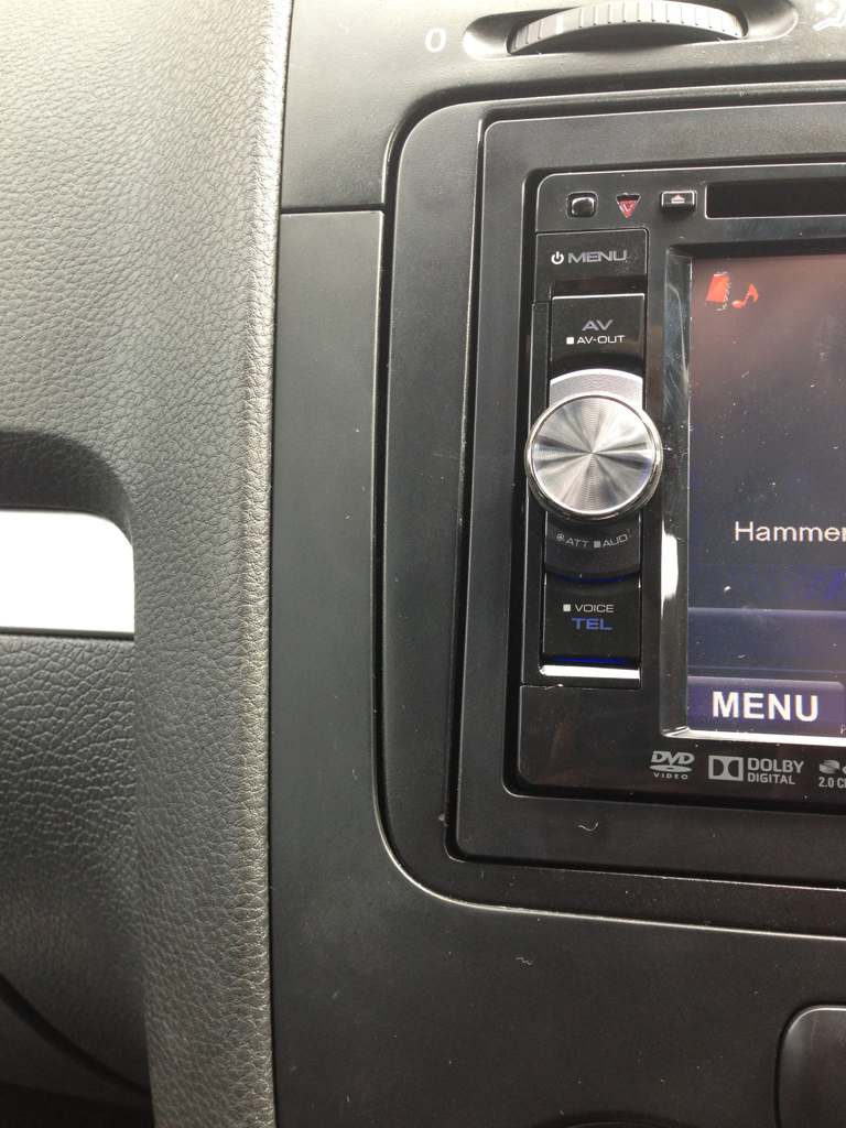

In my picture, there's the thin rectangular trim that came with my kenwood. I think with the enfig one you wouldn't need to use that trim

Well it's fitted, 3.5 hours later!  Pretty pleased with it though.
I forgot to take a photo before I started, this is after removing the top of the dash.  The RCD300 and the Parrot CK3100 are going.
The Parrot was a bitch to get out.  The main bluetooth module was buried  under the ashtray section of the dash.
Eventually the old stuff is out, the new Enfig surround fitted and the Kenwood stereo in with a iPod cable through to the glovebox.
« Last Edit: May 18, 2013, 02:35:07 pm by f1fan »
