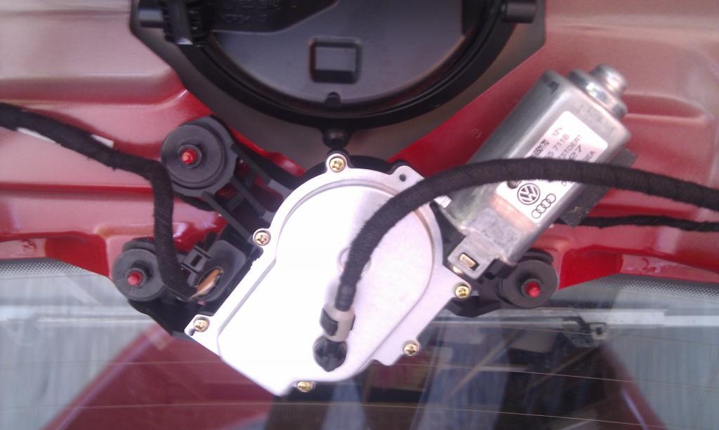

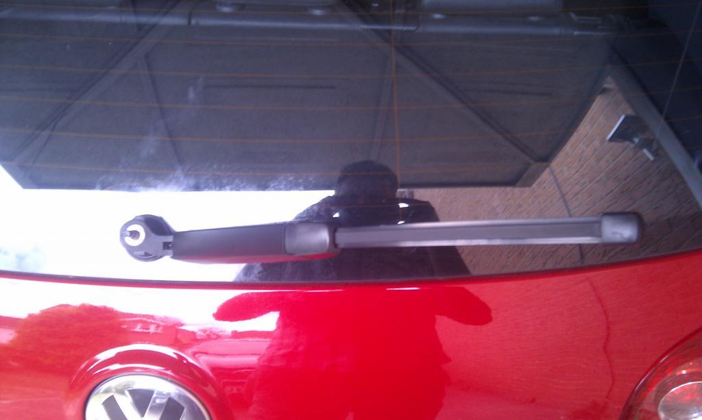

Did mine recently mate:
Left it to soak in WD40 to help remove the arm:
Then removed the inner panel:
Then undid the 10mm nuts holding the wiper moter in:
Glass blank:
Held in place while silicon dried:
All done:
Inner trim panel was missing a clip, luckily had one in my parts department
Very pleased, much cleaner look.

It DOES look nicer, but the fact that the Golf suffers from dirty bum syndrome, I am inclined to leave the wiper.
