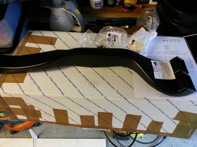

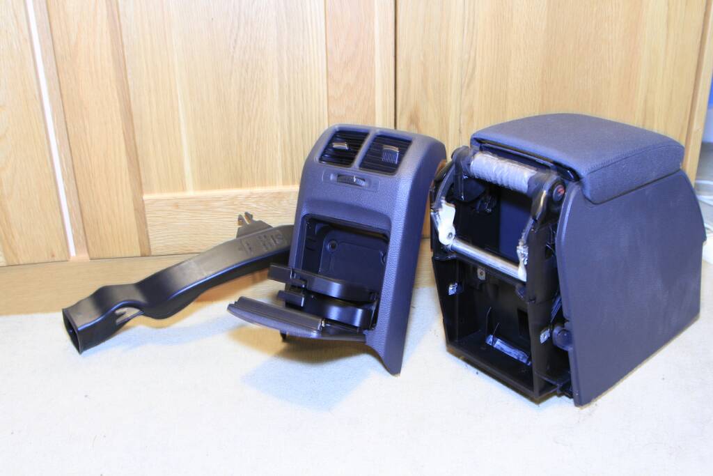

Ive recently fitted one to mine ...don't forget to buy a air duct ..there should be one in armrest and one to link it to under ashtray it is easy to fit took me a couple of hrs as I found it fiddly to get centre consol past handbrake but it does come off ...I also bought some new screws just in case I needed any ...only pence from vw ...now in all working
That's what you need plus front air channel
sent using my own fingers

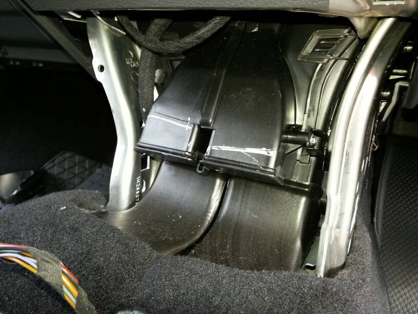

No you don't need it under the dash is just blanked off
You can see the two blanked off pipes .but armrest will just go together without
