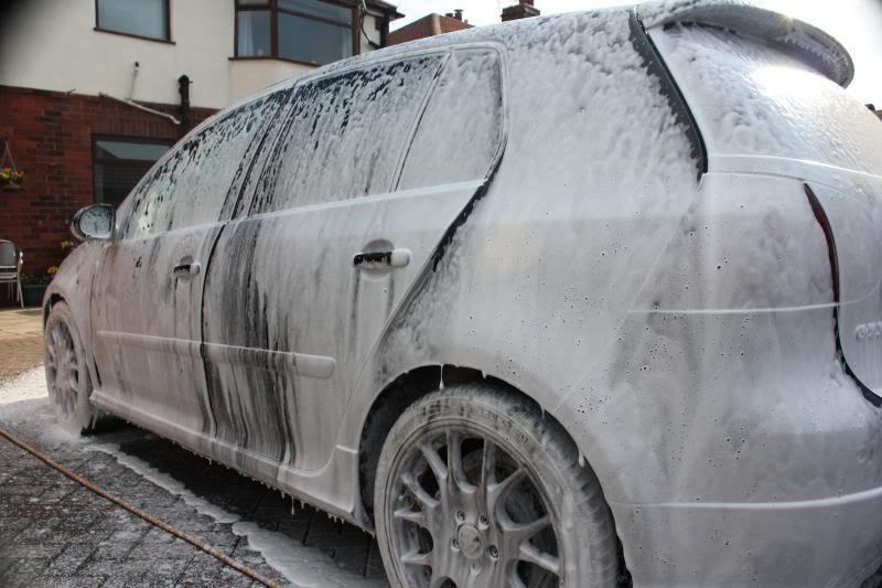

Snowfoam (chemical guys ‘no touch’) and go around door shuts / badges / wheels with detailing brushes and some autosmart TFR and some weak G101.

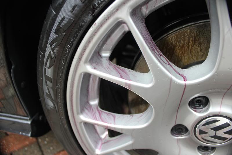

Decontaminate the car autosmart tardis / IronX  and then power wash it off.

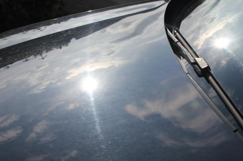

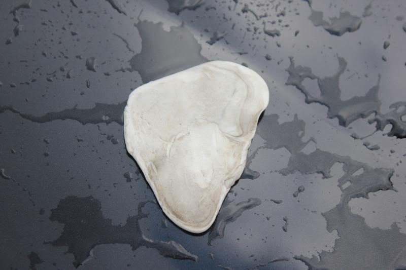

Clay the full car bilt hamber medium using water as lube. Picture is from the roof.

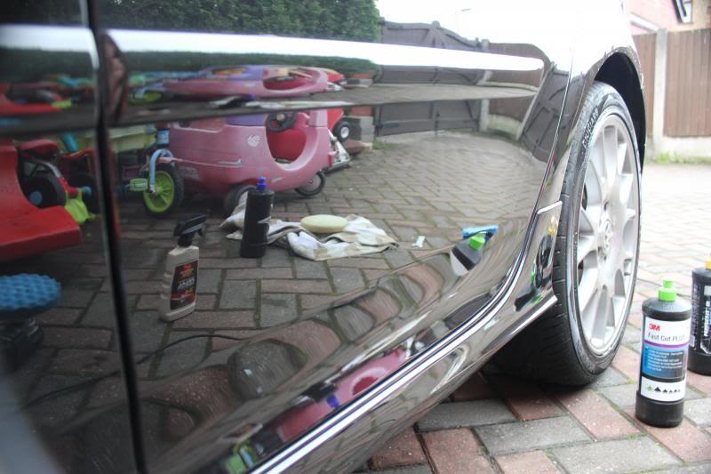

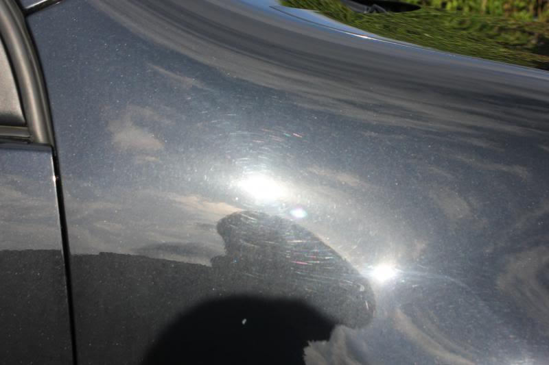

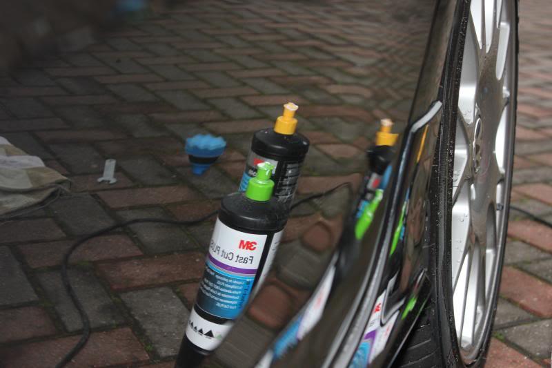

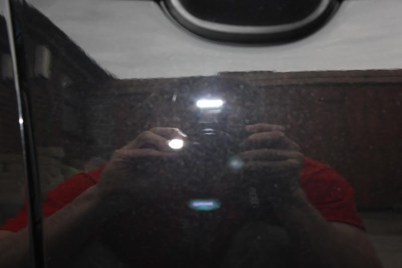

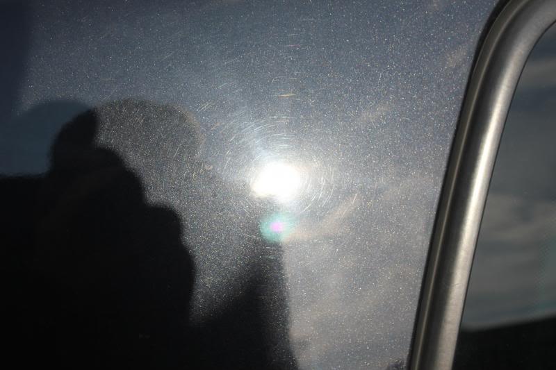

Using my EP800 rotary I did a test panel and settled for a yellow 3M polishing pad and swapped between using scholl S3 gold and extrafine 3M yellow compound. After every panel I would give it a wipe over with some car pro eraser to ensure I was achieving good correction results.

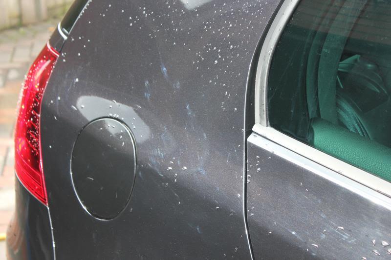

Test panel cut but prior refining,

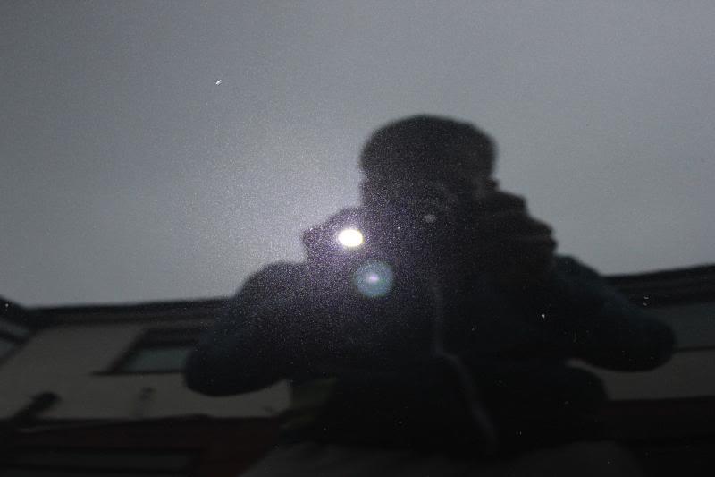

As always I started on the roof, then onto the bonnet and then around the rest of the car. On the first day I had done all the cutting (11hours) left the refining for the next day. The bonnet proved to be very hard paint and took quite a few passes to obtain good correction.
Next day was poor weather so it was literally do a bit, start raining and come in….break in the clouds and do a bit more!! I managed to get the bulk of the car refined using 3M blue finishing pad and 3M ultrafina blue top polish.

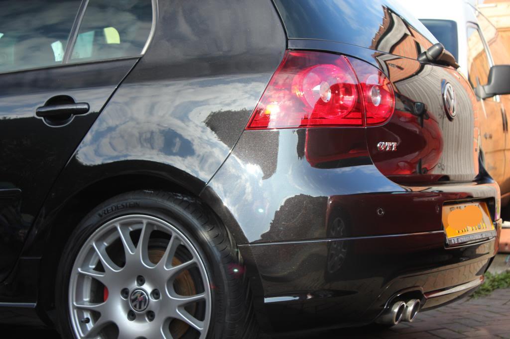

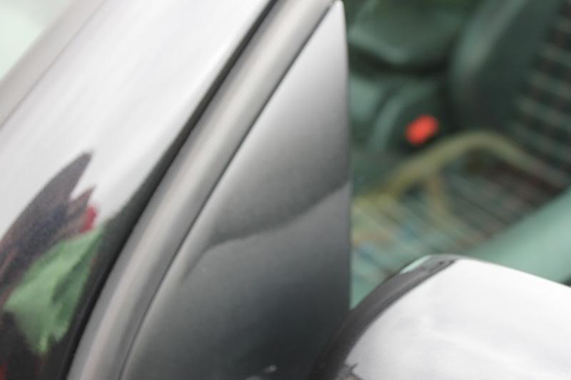

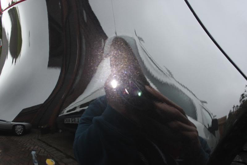

Flake POP!!
Spotty socks!!

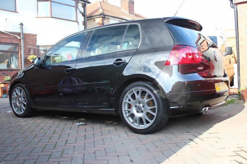

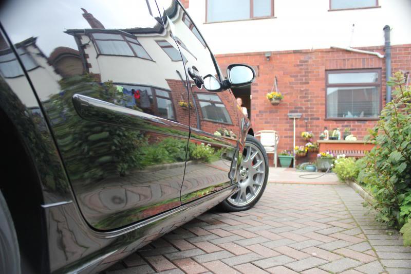

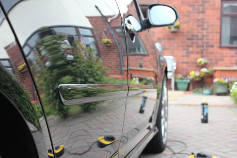

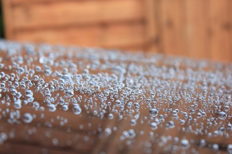

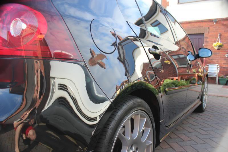

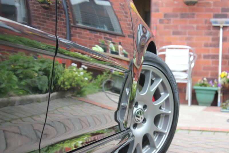

My final day meant I had to finish a little refining off. I then gave the car a through spraying over with car pro eraser. It was then coated in meguiars #7 show glaze as I really really love the look it gives on any car - super duper wet! And then the owner was given a choice of a few waxes / sealants and he wanted me to apply finishkare 1000p.
The car was then snowfaomed, power washed off and then a final layer of 1000p applied.

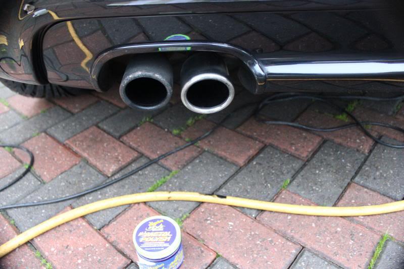

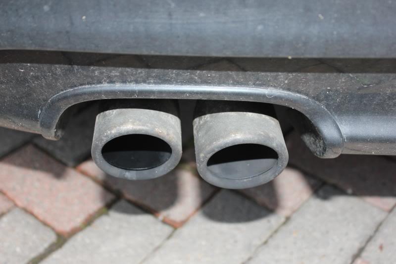

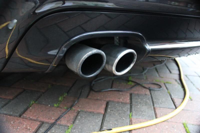

I then went around the whole car dressing the tyres (autosmart tyre and rubber dressing, unsure of name a friend gave me a bottle), dressing the rubbers, shining the badges and exhaust (meguiars metal polish).
I can certainly say I am more than happy with the results and was just disappointed there was no sunshine out for my final pictures!!
