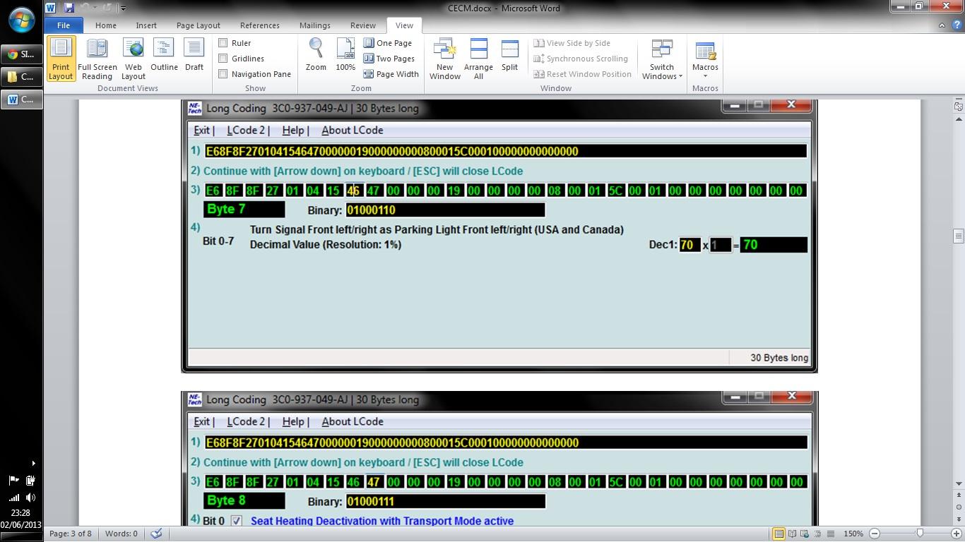

Does anyone know in which byte it says to use signals as running lights?  I cant seem to find it in controller 9 long coding helper.

« Reply #20 on: June 02, 2013, 11:29:08 pm »
Offline RetroRaz
  • -Given: 32
  • -Receive: 194
  • Posts: 2821
Re: how to turn indicators on front on as side lights
« Reply #21 on: June 03, 2013, 09:02:28 am »
Thanks SI  :happy2:

« Reply #23 on: June 03, 2013, 07:15:01 pm »
At 50%
(Sidelight bulbs are orange 501's - makes the whole strip look orange!)

« Reply #24 on: June 04, 2013, 12:23:07 am »
50% is far too bright for night time driving IMO. :surprised:
