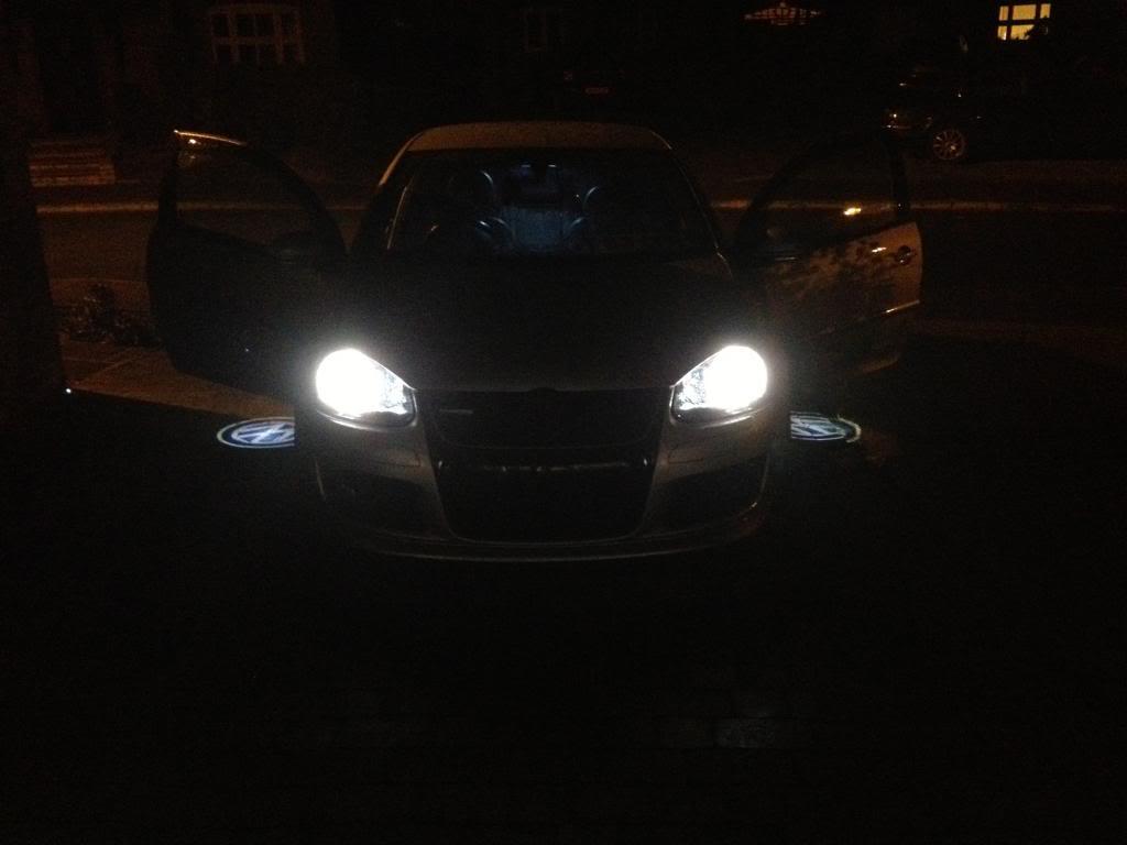

OMG.... I NEeeeed one of those lights  :grin:
You mean TWO of em  :evilgrin:
They were for sale on ebay in the UK for £50 when I bought em over a year ago. I bought mine on ebay, but from China.
Cost £14 delivered  :laugh:

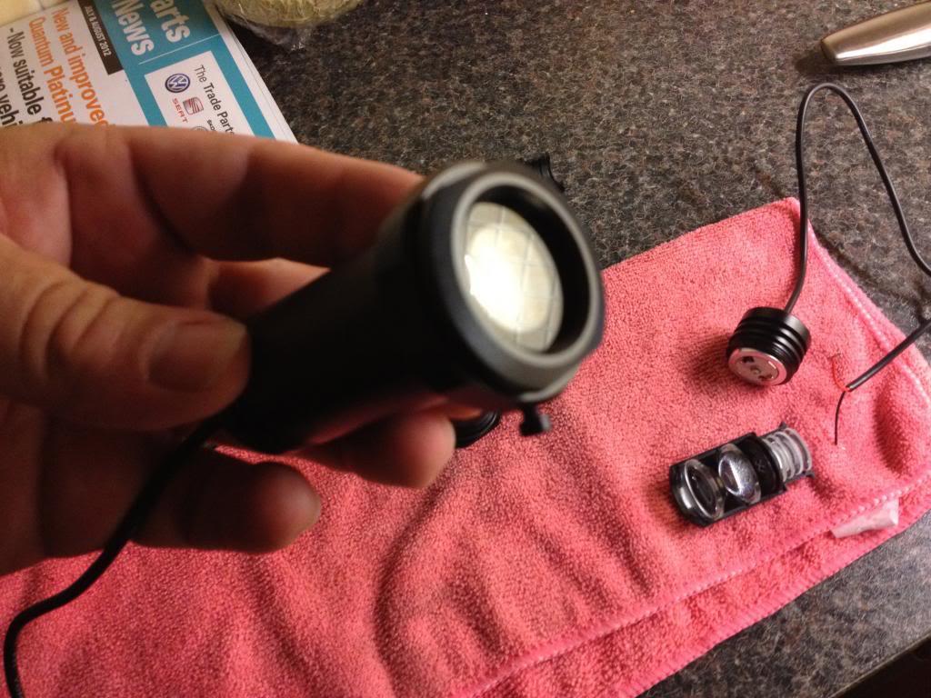

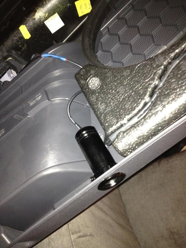

Any pics of the install? I might have to get some. :-)
The install is SO easy.  :happy2:
You need to buy 2 repair wires from TPS. £3 each max (cant really remember)
(You need 4 wires in total (2 for each light) BUT you only need to buy 2 repair wires as they come 600mm long and double ended, so just chop em in half)
Hardest part is taking the door panel, which gets real easy with practice.
With the panel off, you will see there is the perfect position and space for the lights.
The kit comes with the correct hole saw bit.
Drill the hole, pop the light in and secure with the nut provided.
There is a tutorial for fitting the oem door lights somewhere. Basically the repair wires plug straight into a large terminal block on the door. (For Example: positive pin 17, earth pin 18)
Sorry I didnt take any pics of the connector. Doh!
Just connect these to the lights, refit door panel, activate the oem door light with vcdd and done.
When/If I get fed up of them I will just wire the OEM door lights.  :wink:
