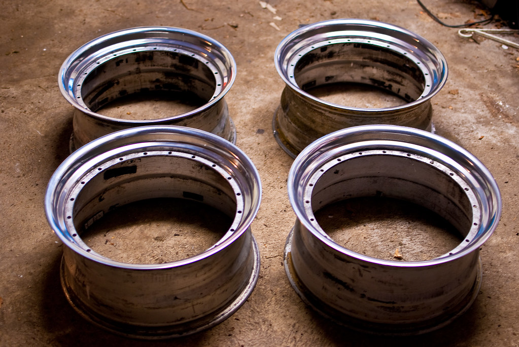

The lips are finished.
Three are pretty good. One unfortunately still has pitting that we cannot remove. I polished 1 3/4 of them and my mate did the rest. We went down to 180 grit on the pitted one and it would not remove them so have to look into getting them all professionally mirror polished over the winter. They will do for this summer anyway.
I want to get some new bolts, I have a set of 8/10 condition bolts to rebuild them with already but they are polished/stainless and I want something a little more special. We'll have to see how money is.
