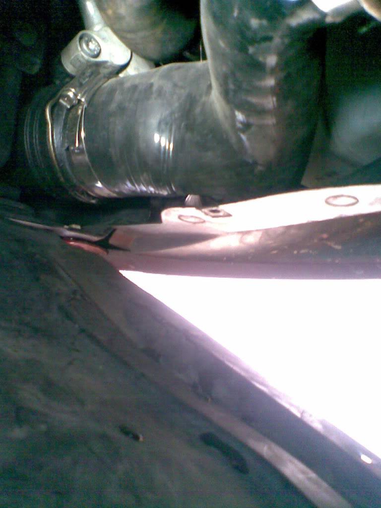

The only thing I can think of is when I fitted the forge intercooler one of the hoses (drviers side) was slightly deformed /squashed (I didn't trim it enough) therefore this could possibly be preventing full boost from flowing around the system?

Rob how kinked was the pipe, when i fitted mine the fit was ridiculous i had to cut loads off all three connections on mine, and it still has a slight kink in. If your fit was like mine and you have not chopped it then you could be right.  :smiley:

    The forge intercooler pipe was trimmed about 10mm but still squashed about 50% of original dia.

Can you post a pic of your kinked hose as it may allow more ideas on how to improve matters plus post your full revo settings.

Here is the best shot I could take of the hose, you can see towards the left hand side of the pic where it looks squashed.

As for your hose problem, you may have to trim off some more but at an angle instead of 90 degrees so that it stretches the left side more than the right of the hose relieving some of the kink.
