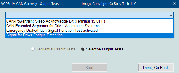

Neil try doing the output test for the manifold motor.
open vcds>engine>output test 03
then select Intake manifold flap from the drop down list
While the test is running the actuator arm should move to fully open and close the flaps
