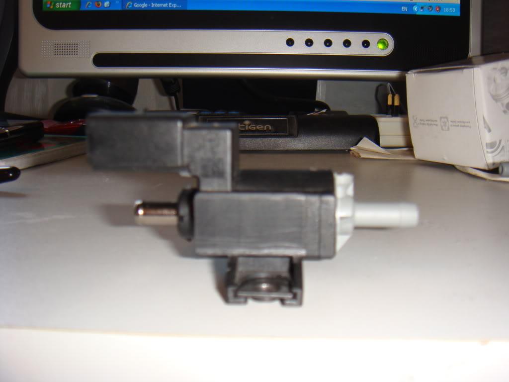

Came home lifted the hood and noticed the small hose going of the Forge DV, connecting to the solenoid had split and the plastic pipe to which it attaches had also snapped right off :( It seems strange as nothing is weighing onto it to cause it. Has anyone else experienced this?
The picture illustrates the broken bit.

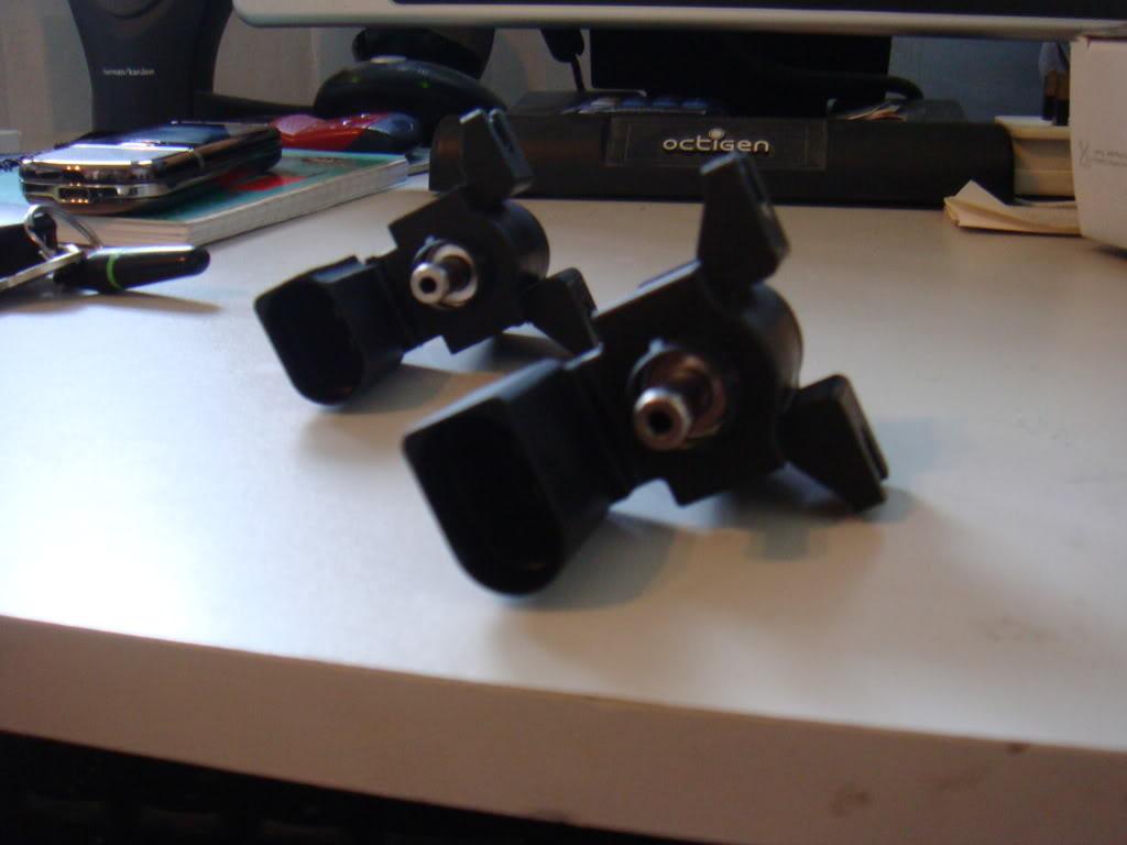

I've removed the bit this morning and took it down to VW and strangely there is no part number on the bit, it looks as though it has been machined off professionally.
The picture illustrates this.

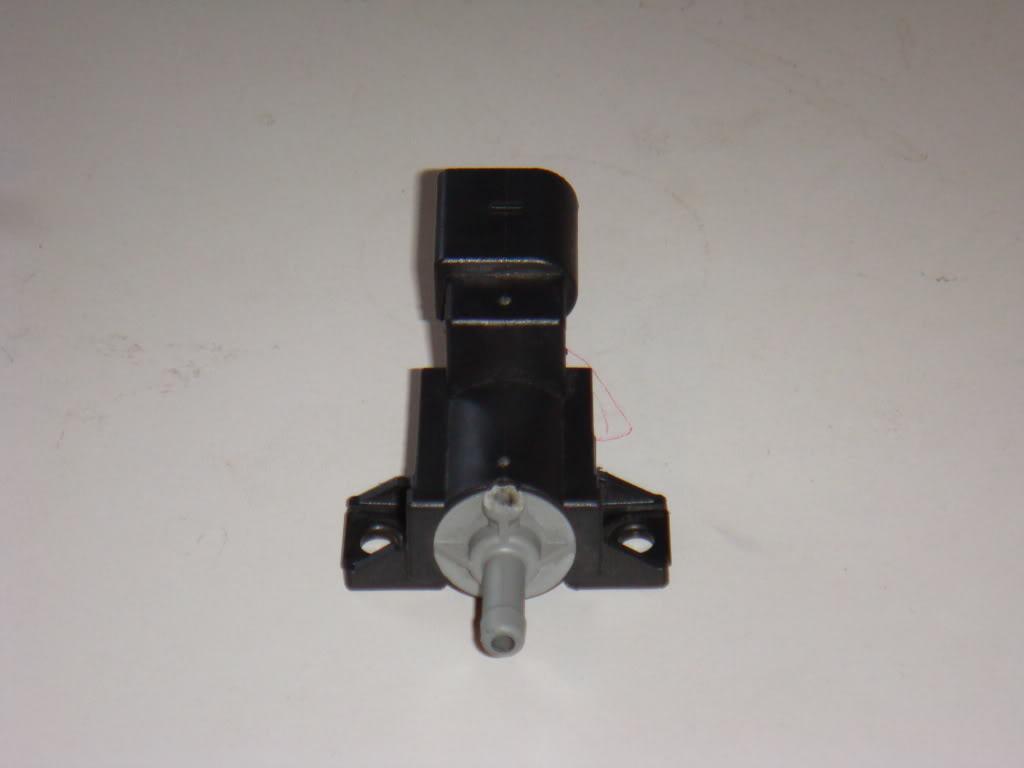

Here is a picture of new part from VW.

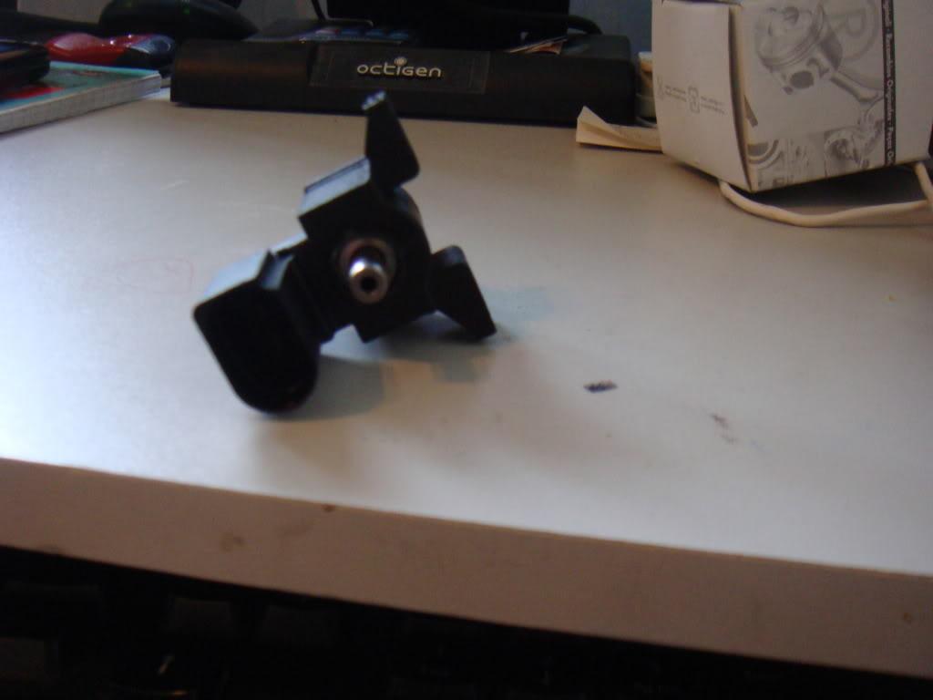

So i get the new part bring it home and being to put it together, but it doesnt seem to connect to the other end, where i notice the connector is different to the original.

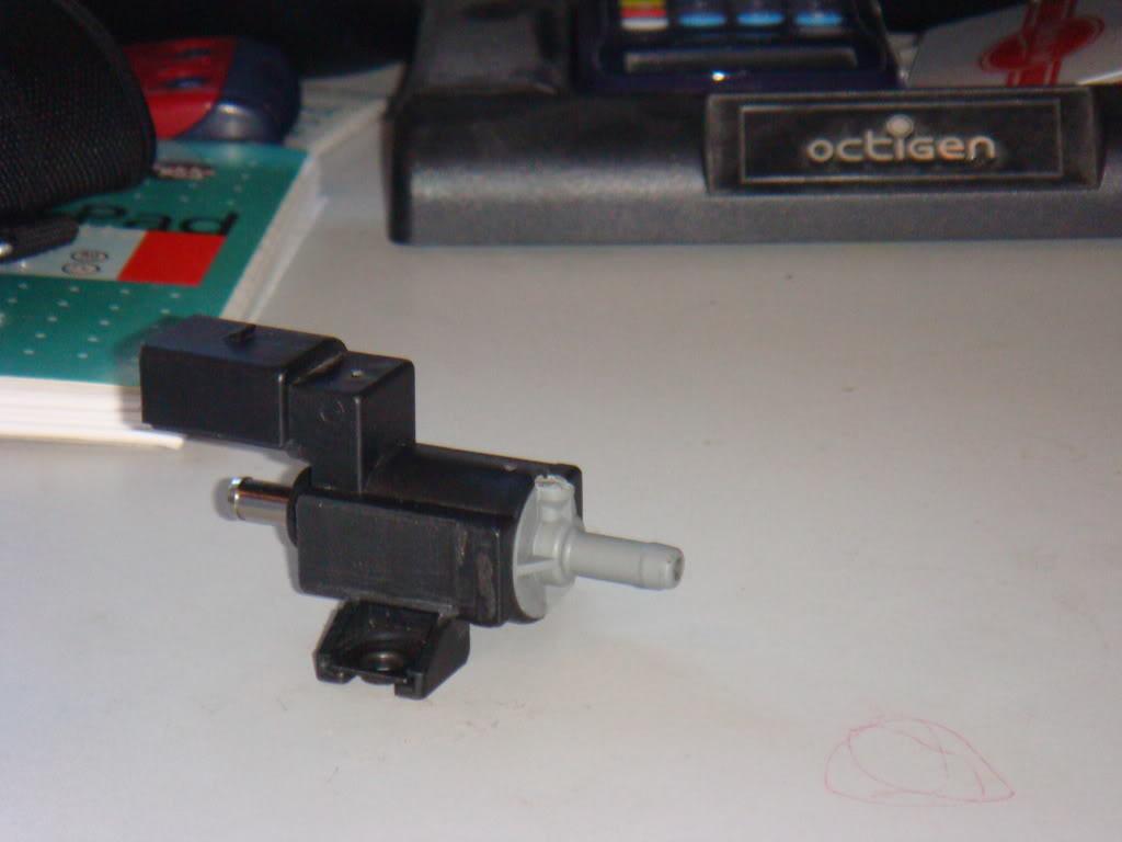

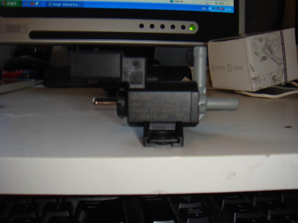

The orginal seems to have a groove, again machined where as the new part doesnt, so i've taken it back to VW who say they cant really help because they only have the one i bought today
The picture illustrates original part.
The picture illustrates new part.
