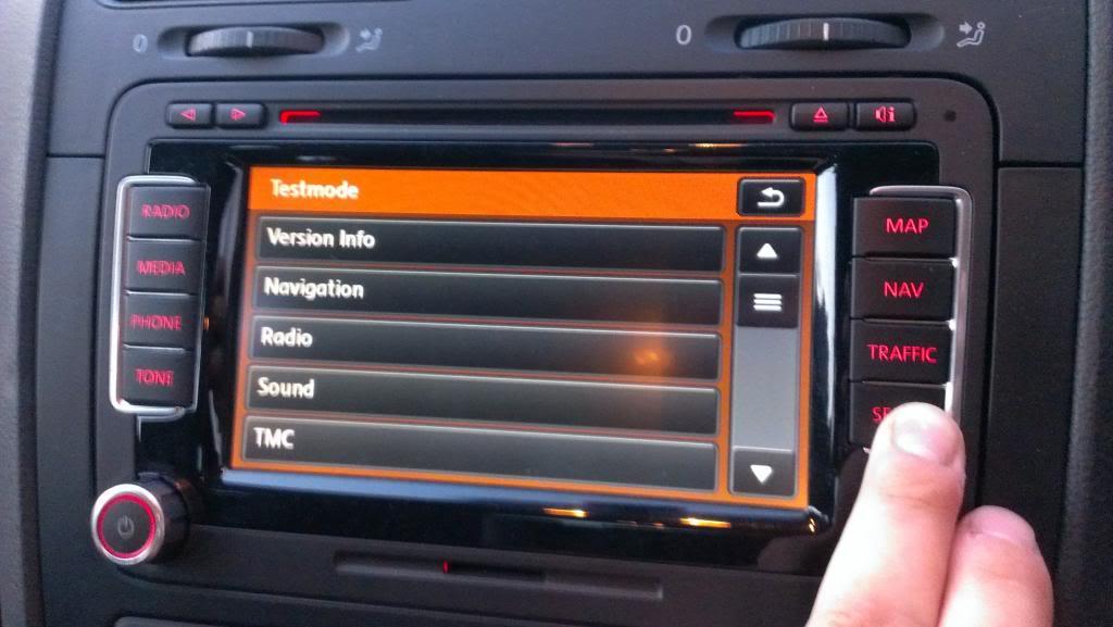

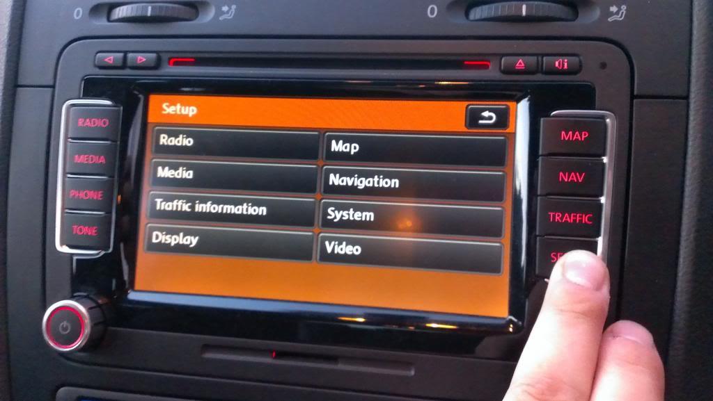

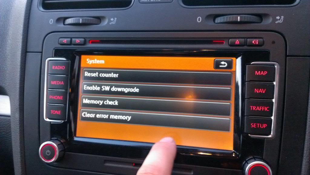

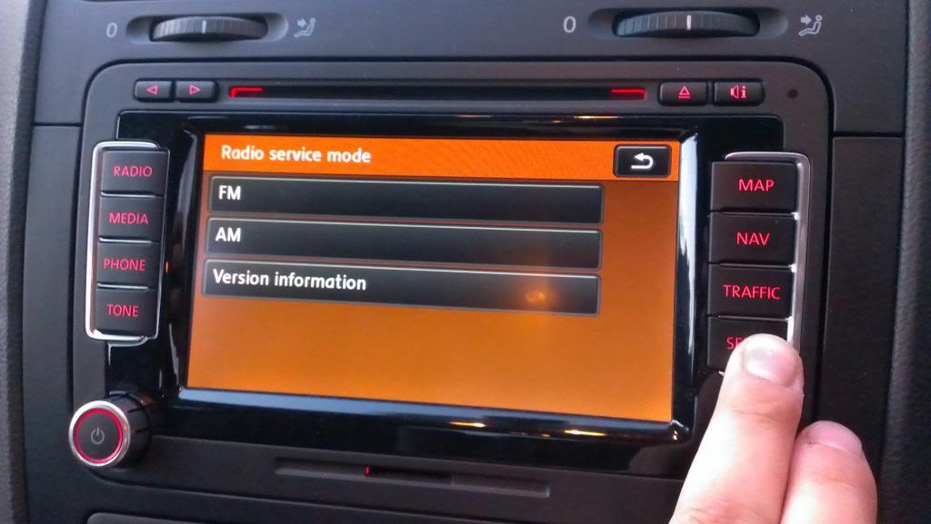

I am not a pro. This should allow the firmware to be downgraded:
To get to the software downgrade option you will need the "secret menu" enabled on the RNS.
Hold down the "SETUP" button. You will get the following menus:
Standard setup menu. Keep holding...
Radio Service Mode. Keep holding...
Testmode. Let go  :wink:
Select "System" (bottom of the list) and you will get this:
In all honesty I don't know what happens when you press "Enable SW Downgrade", never pressed it before.
Good luck.  :happy2:
