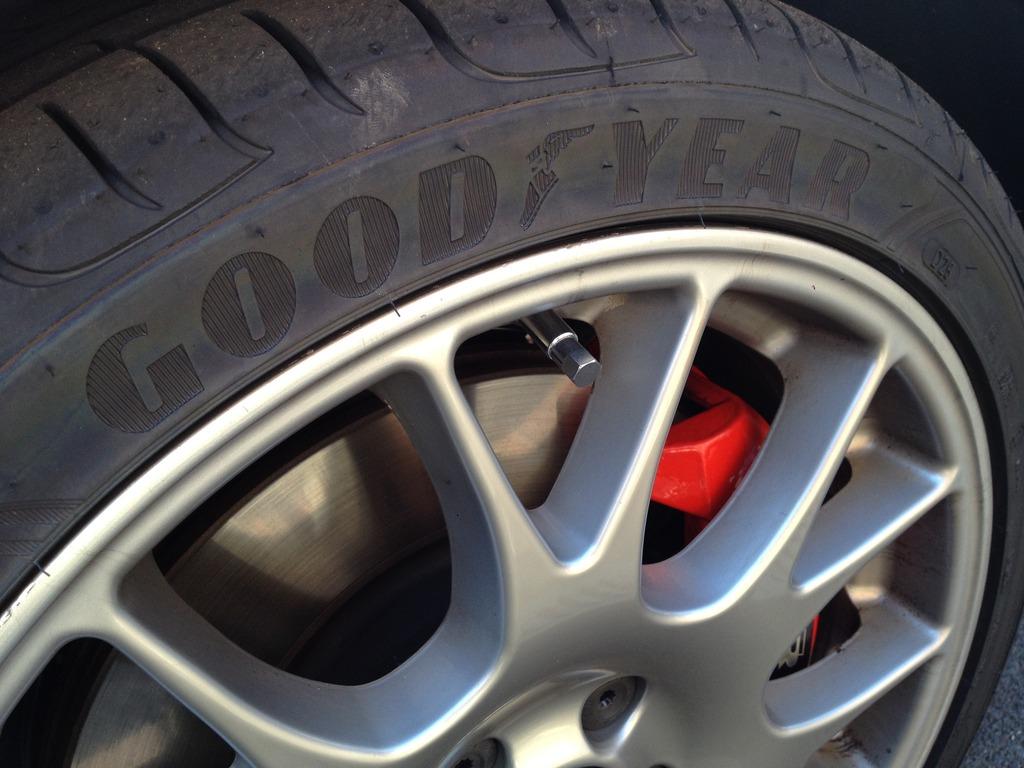

My tyres needed replacing so bit the bullet and changed all 4 to Goodyear Eagle F1 Asymmetric 2.  So far I'm really impressed and much prefer them to the Bridgestone's I had on before.  It could be down to the previous set having only approx. 1.8 tread depth on them but the grip on the new set is awesome in comparison.  My MPG's have increased by a notable amount too.
I'm busy getting the rest of the parts I want for an AWD conversion but nearly there, figure if Im going to do it I may as well polly bush, Exhaust (will need changing anyway), roll bars, SALK and alloy arm it while the bits are off.
