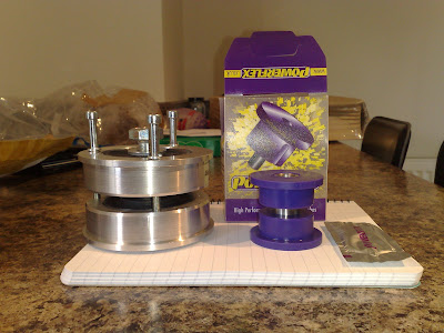

Powerflex dog bone bush ordered from Awesome :
Lower Engine Mount Front PFF85-505
£12.33 excl VAT
VWR lower engine mount  ordered (Road) :
LWR SUBFRAME PART No VWR1KO 203
£127.82  excl VAT
both companies are to be praised for the customer service I received when ordering these parts  :happy2:

although proficient in car mechanics , both new mounts require hydraulics to push them into their respective mounts (and to remove as well), I also now consider it easier to get Awesome to do my dirty work.
The lower subframe requires removal which can be time consuming.
its also worth looking at this thread on vwvortex as it shows mounts being installed (not VWR but its the same procedure)
This cost me 2 hrs labour  2 x £50 = £100 labour
If you have the right tools then id say its an easy DIY too.

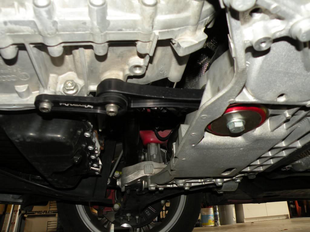

3. BSH : not yet released side mounts ,   pendulum mount replacement bar (this is an alternative to fitting the powerflex bush to the OE bar)
heres a pic of the BSH bar installed ... (thanks RR)

I did Robin, the key thing is that the BSH kit seems very much an odd compromise biased towards easy fitment rather than attacking the areas where most movement may be present.
BSH kit : the arm is very well made and potentially stronger than the OE arm (but does it need to be?) , the bush within the arm has however been replaced (a huge plus point) , BUT the kit includes a ECS type insert for the lower engine mount (a partial fix imho).
BSH seems to have done this to hit a large market and make it an easy DIY fitment.
For me the huge downside is you pay for a high quality arm , but your effort is somewhat negated by leaving the 'probably' knackered lower engine mount in place.
(note if you can get the BSH kit 2nd hand or at a high discount, I do feel its a quality product just for the arm. you would then ADD the VWR lower engine mount and NOT USE the insert provided by BSH  :wink:)
At the end of the day its personal opinion , but I wanted to attack the areas that I felt needed most improvement.
After fitting the ECS lower mount insert previously , buying the BSH kit alone was not going to sort my issue, it would merely of improved it by a small percentage (for a large cost).
Replacing the lower engine mount is costly but based on improvement/cost unit  terms its quite low.
(of note the ECS lower engine option also only addresses the bar improvement leaving the lower mount as is)
If you assume your original lower engine mount is fine then either the BSH or ECS lower kit is great.
That is however not in my opinion correct , and you inevitably will be needing more.
I would envisage an upgrade path such as this
Stage 1 : Try the ECS insert only : its low cost and worth a first shot.
Stage 2 : Lower VWR engine mount + ( either BSH bar OR OE bar with powerflex insert )  : ECS insert is of no use and is discarded
Stage 3 : add side VWR road mounts
Stage 4 : full VWR race mounts
in all honesty consider your requirements carefully , and just jump the stage that suits you best.  :happy2:
usual overly long john_o rant ends........

I think that's, as usual from you, very good advice and assessment of the various options.
With the second-hand (saving cost) BSH bar assembly with integral bush and VWR lower mount, and furthermore all three VWR 'Fast Road' mounts, I'd say that my particular car is now well sorted in this respect. Possibly more than it needs to be but I prefer it that way.

....Mat is a hard northerner though and has the solid 'Race' mounts. However, I was, believe it or not, born in Yorkshire.
