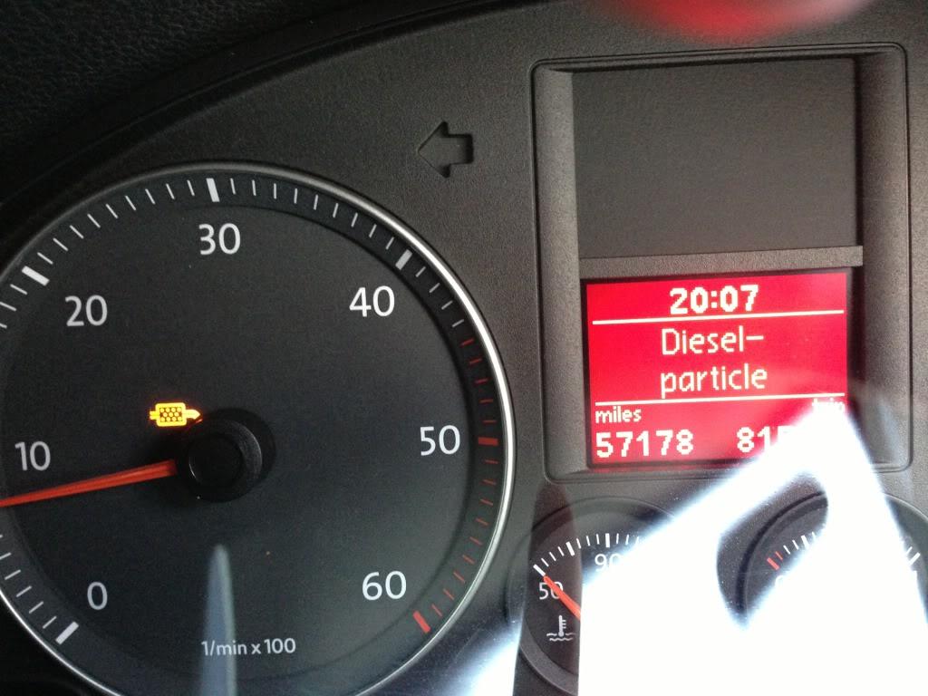

First time iv seen this warning light  :sad:
Its the first time its come on, recon it will go off after 1 or 2 long drives, recently i'v only been travelling 1 mile to work and back each day and no long drives...
I've been umming and arring if to keep this one and get a map/dpf delete or just sod it and get an ed30. Just as im a week away from the payday that'll mean i have the choice, this happens :signLOL:

100% remap and delete unleash the beast within you'll never look  back.I never have! :driver:
A constant speed in 4th around 2.5 to 3k revs ill have the light out in 4/5 miles and force a regen
dpf out! Stage 2 remap.... Now it's gam'on!

Get out and regen before it gets more clogged  :happy2:
