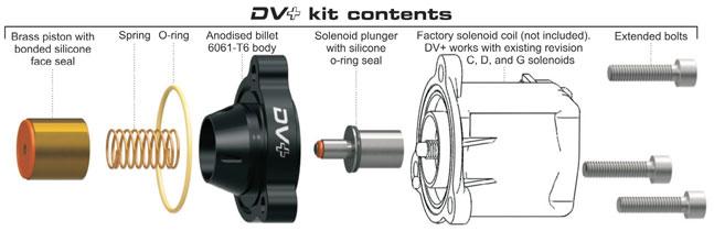

I have been lucky enough to get hold of a Go Faster Bits (GFB) DV+ kit so will be doing some ongoing reporting & reviewing.
What is it?
The GFB Dv+ kit is a kit that has been developed to improve a known possible weakness in the TFSI boost system.
It works by replacing some of the original parts of your DV, whichever revision you may have.
Above the picture clearly illustrates the parts in the kit.
Sales speel
Lifted from GFB website - See here
The solenoid coil itself from the factory-fitted valve is great (the ECU opens it faster than any pneumatic valve so why replace it?), but the weak point however is the valve mechanism itself. So GFB’s DV+ solves this problem by replacing just the valve parts with an anodised billet aluminium housing fitted with a brass piston machined to exacting tolerances.
The end result is sharper throttle response, lightning-fast valve actuation, and it will hold as much boost as you can throw at it. Read all about the DV+ story on the next page.
Other manufacturers’ products involve replacing the entire system with a traditional pneumatic valve, requiring long vacuum hose runs, additional parts for tapping into the intake manifold vacuum, plus either a different solenoid valve to actuate the pneumatic valve or a ballast resistor to plug into the OE wiring loom. All these additional items result in a product that is slower, less responsive, more expensive and takes much longer to install.
GFB’s DV+ solution on the other hand is more responsive, less expensive, easier to install, and doesn’t cause compressor surge/turbo flutter. Oh, and it doesn’t require different springs or frequent re-builds.

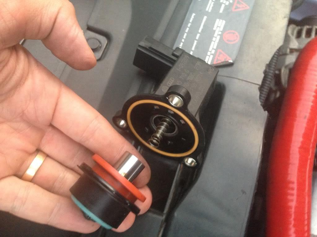

Fitting
Fitting is very straight forward on the Ko4 TFSI.  Probably a little more awkward on the Ko3.
Took me a couple of minute max including double checking the O-rings where located correctly and dabbing some oil on the piston with my finger. (Wear gloves)
There is a very clear colour fitting guid in the box.
Just remove this part of your DV and add the DV+ kit as per the picture. (This is the part you would check if you had issues with loss of boost)
