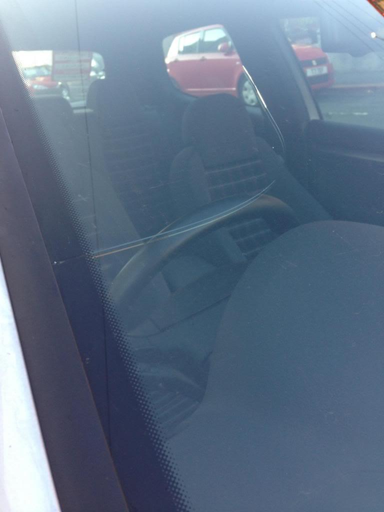

So... My windscreen has cracked...
Got an appointment tomorrow to get it changed and I've called to make sure it's the same glass (it's not VW because its older than 3yrs old)
They say it has the green tint and the rain and light sensors and that the glass is exactly the same just without a VW badge...
Unfortunately I'm away with work so my sister is having to look over their workmanship..... Anything she should look out for please?!? Do tell...

It's a massive crack that I don't wanna risk leaking in... I have my Brother in law and dad on the case now... Watching over them... Fingers crossed it'll be good! I've told them about everything that I would do so it should be ok!

For your information......
