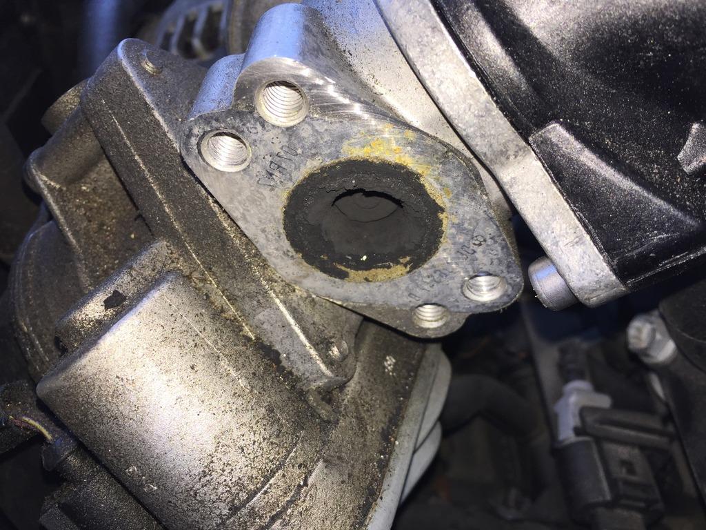

Did this on mine a couple of weeks ago.
Here was the EGR valve on my 2007 63k BMN engine.   :sick:
And then after a good clean:
Here's some of the crap that came out of it:
Definitely running a lot smoother and idle is much better (was quite lumpy ever since getting the car a few months ago)
Chris
