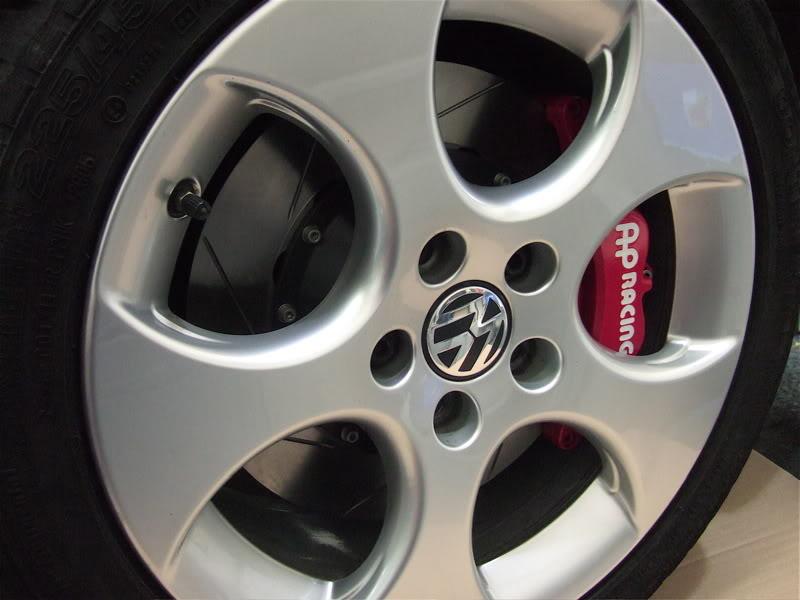

^ Standard Monza 18" diamond-cut clear lacquer and with grey 'inserts'.

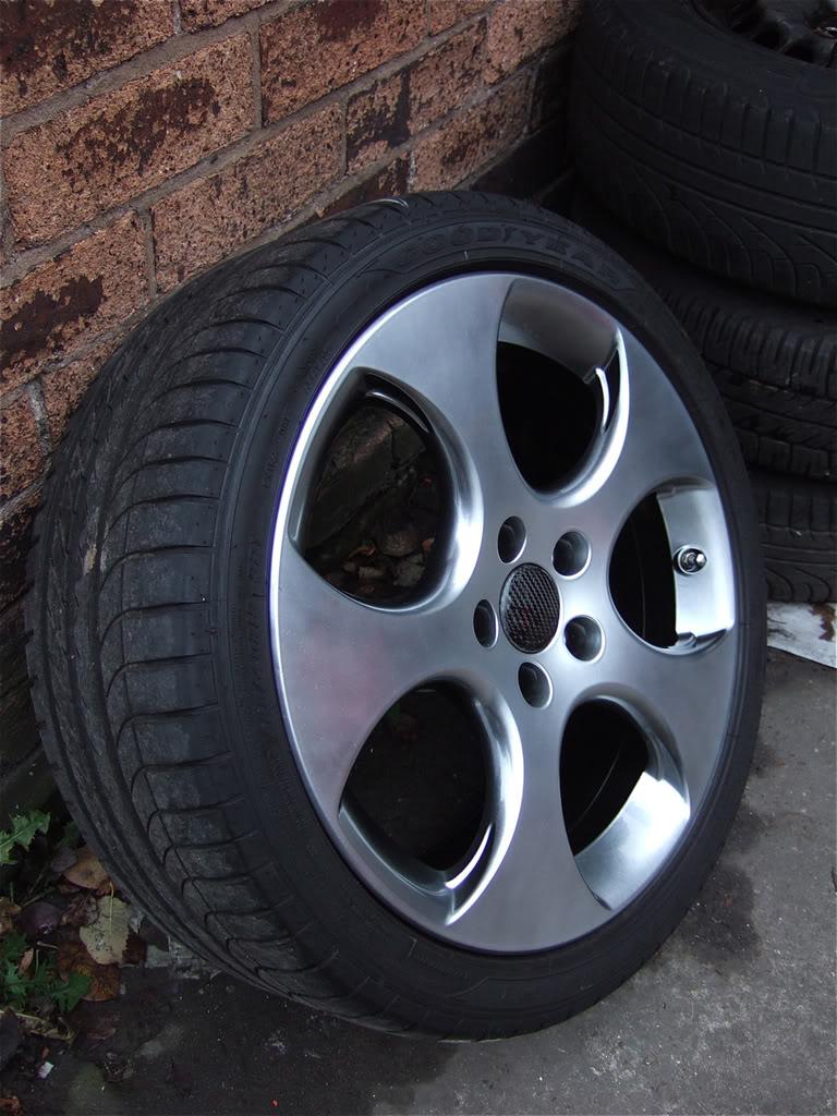

^ Showing the grey 'inserts' and clean edge join to the diamond-cut face. This can only be achieved by firstly powdercoating the whole wheel in grey and then cutting back to the raw alloy on the face and then lacquering it.

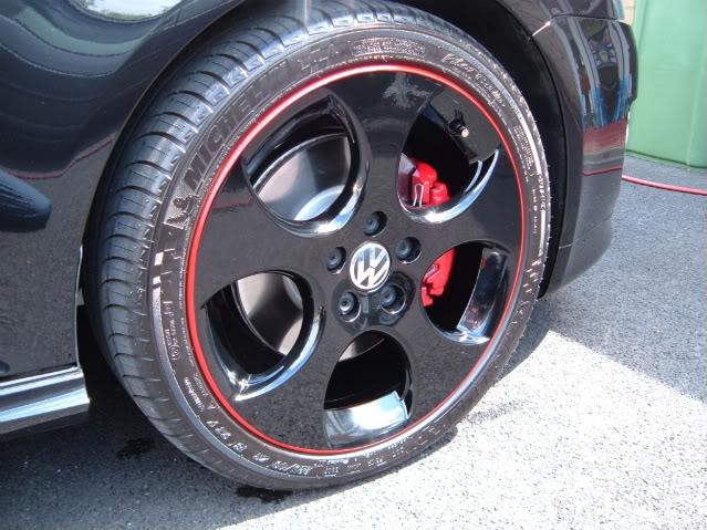

^ An example of custom finish done for Nathan by A1 Wheel Renovations in Wolverhampton.

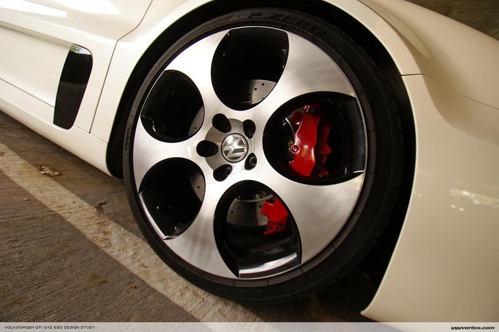

Nathan's latest custom design matches that of the pre-production Mk6 GTI as shown in Paris and also the GTI W12:
^ By painting the inserts black, the wheel appears bigger.

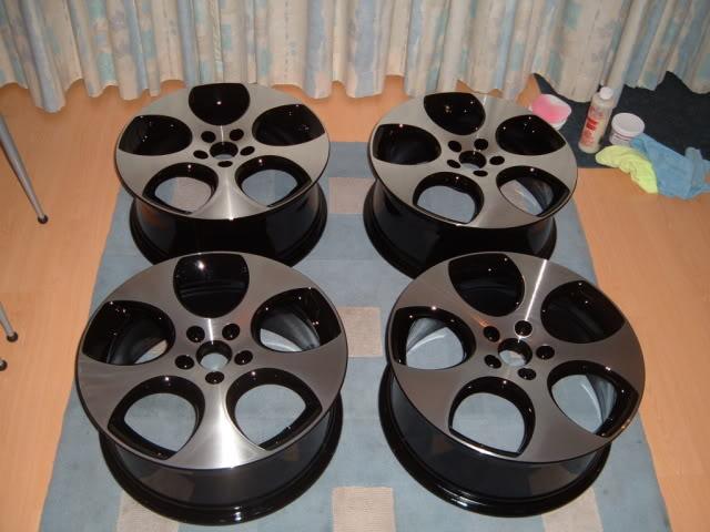

^ This is achieved in the same way that BBS manufacture for VW - But in this case, the wheels are painted black all over and then diamond-cut back and clear lacquered. This also enables a visually clean edge between painted inserts and face and is the only way to get this result. If you wish to mix a painted face with a different coloured painted insert, you have a major problem achieving a clean edge and most professional refurbishers will only undertake it, if at all, entirely at your risk - You pay however badly it comes out.

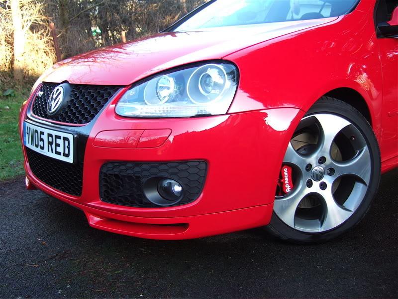

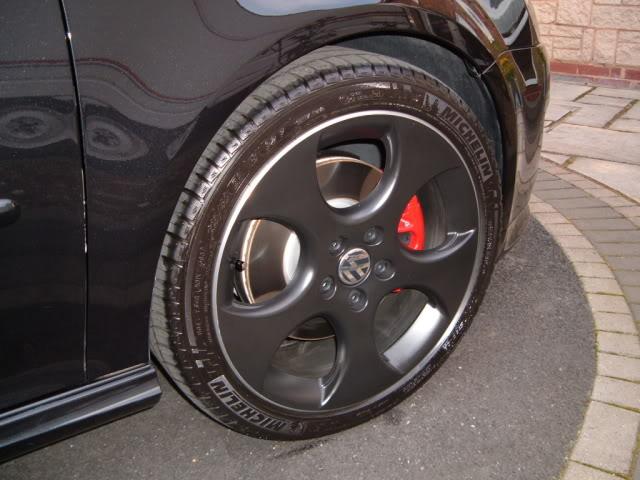

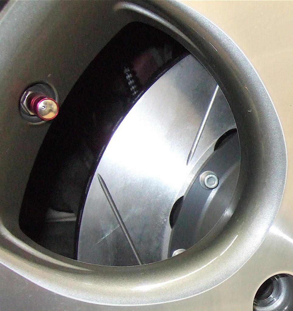

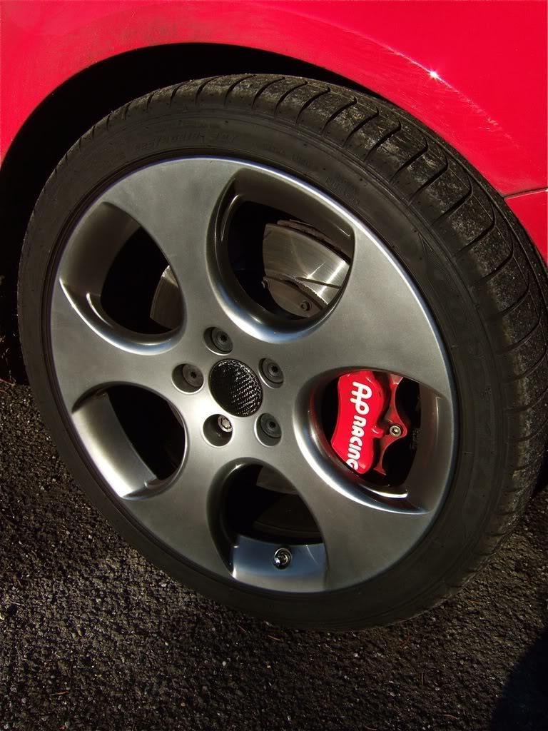

Custom finish but powdercoated entirely without any cutting back to diamond-cut face. This totally avoids future white worm problems and is what I decided to do:
^ They are first painted black and then powdercoated Smoked Chrome (a shade of silver) such that the face has slightly more silver than the inserts. This results in some visual subtleties.
^ Dirty after about 200 miles of motorway muck, but not showing it.
^ The brighter silver of standard VW Silver on the Monza 17's.
^ The effect of powdercoating Smoked Chrome overall, the inserts are more easily seen but also add an exciting visual effect. It's swings and roundabouts and a matter of personal preference but it has been my aim to retain the integrity of the Monza as an important component in the Mk5 GTI's identity while killing the white worm for good!
