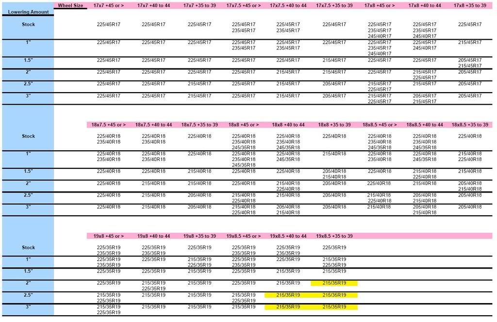

The best way to explain this is to look at the below picture
Generally when we are fitting summer tyres you do not need to worry about load or speed ratings. Of course buy the ones suitable for your application.
What is the standard fitment on a Golf Mk5 then
Standard fitment alloy wheels for the Golf Mk5 fitment are generally no more "aggressive" than 18x7.5j with an ET of 51. All are 5x112 with a center bore of 57.1
On a Mk5 Golf GTI the tyres come in either 225/45/17 or 225/40/18
Other tyre sizes on the Mk5 Platform are also 195/65/15 and 205/55/16.
You will notice that these all keep more or less the same rolling diameter (that is, the diameter of the wheel (with tyre mounted) is near as makes no difference the same between all of the tyre sizes.
Another thing to be aware of is the tolerance in tyre size - For example Falken tyres run narrow and Vredestein run wide.
A 215/35 Falken tyre on a 8.5 rim will give more clearance than a 215/35 Vredestein tyre on the same rim width.
So the take away from this is that you will generally have a 17x7.5 et 51 with 225/45/17 tyres fitted, or 18x7.5 et51 with 225/40/18 tyres fitted.

That's all well and good but what tyre size should I buy?
As mentioned hundreds of times this all depends on i) how low you are and ii) what your wheel width and offset are.
So for example on  standard Monza 2 - 18x7.5 et51 - you can use a 225/40 and you can go pretty low indeed before you would rub on the outer arch. Inner arch clearance is generally fine.
However if you wanted to put, let's say.. 18x8.5 et 45, not only is the wheel itself one inch wider, but it sits 6mm further out. So the outer lip of the wheel will sit approx 31mm further out from where a standard Monza 2. If you put the "normal" tyre size on this wheel, probably a 235/40/18 or a 245/40/18 - You then also have another 10-20mm of tyre
What does this mean? MAJOR RUBBING.

As a rule of thumb, and as a base for calculations, anything wider than a 9 inch rim with an offset of higher than 46 will hit the suspension strut (again this is very particular on what kind of suspension set up you have and should only be taken as a rule of thumb)
With a 7.5inch rim you can have around ET62.
