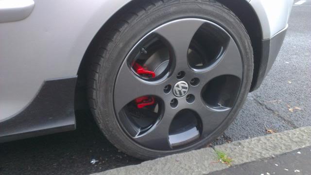

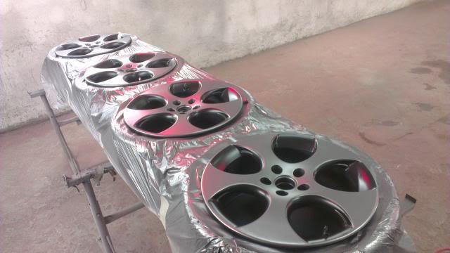

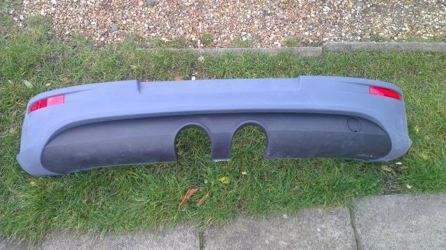

Have a little update. Decided to refurbish and paint my alloys. Painted the centres black with a graphite on the face off the alloy. New VW centre caps to finish them off. My R32 rear bumper arrived today. So will need to paint that and get the exhaust made up. Can get a full custom made from cat back for £300.
Here are a few Pictures

The wheels looks nice. Need some more pics  :happy2:

Where did you get the R32 bumper from?

I won the Bumper on ebay biddinh for £70 :signLOL:

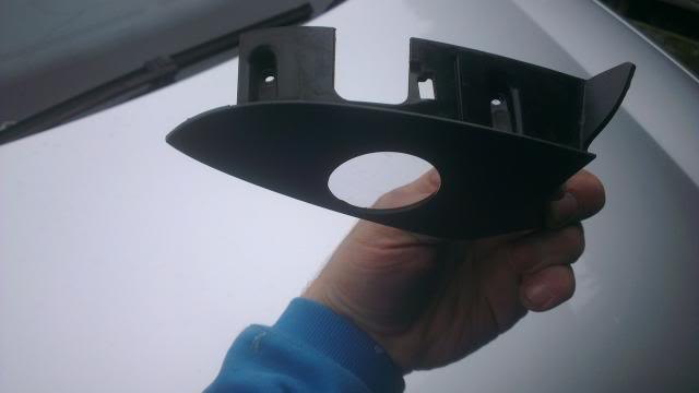

Little update. Decided to modify my wing mirrors and fit some Puddle lights. ALL works a treat and very bright.
Stripped the wing mirror down
Drill a hole in the bottom using a hole saw

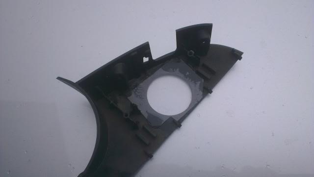

Glued a sheet of clear Perspex on the inside to protect the LEDS from water

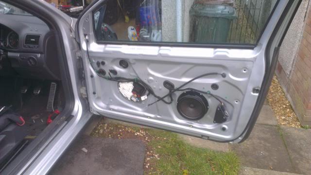

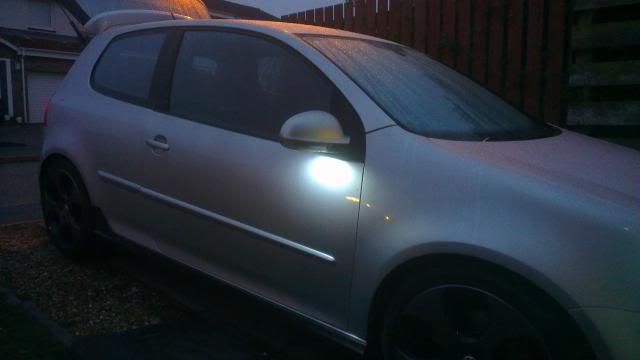

Final result. Simple but effective. I know i could have bought the Puddle Lights of ebay. But my wing mirrors dont have the guide at the bottom also wasnt much space underneath. So went with 24 SMD Panel each wing mirror. Wired the SMD panels via the footwell Lights.
What you guys think?

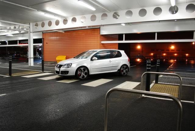

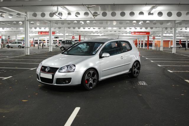

New Sainsburys has open where I Stay so thought take few photos of my golf with my camera instead of my mobile show you guys better quality photo of my golf
