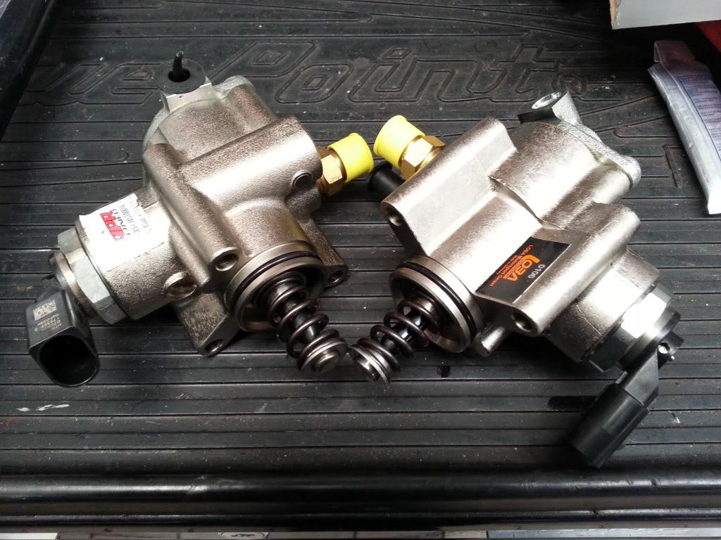

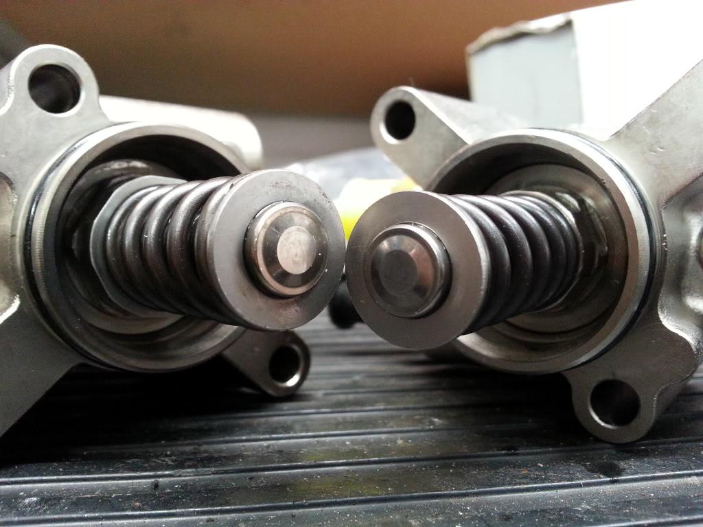

APR is tested to 150 bar as the stage 3 turbo kit runs a 150bar FPRV.
Both the contact points onto the follower are the same on both pumps.  APR on the left, Loba on the right:
Loba is still the winner on price, but there isn't anything in it between that and the APR in terms of performance and quality.

Re: What upgraded HPFP are you running
« Reply #67 on: November 05, 2013, 07:15:12 pm »
This is news to me. The last time I saw the fuel pump it had a smaller head on the piston which didn't have the chamfer. Also the last time I heard 140bar was what they tested at. Just looked on their website and looks like things have moved on. Thanks for the update Alex. Looks like the difference is just price point then. :happy2:
On a side note, It must also be fairly recently that APR started using the 150bar FPRV......probably since the stage 3 golf R development was completed. I know they have changed a few things like going back to S3/R injectors and removed the need for the LPFP as they had a few issues with the controller, specifically voltage related.
