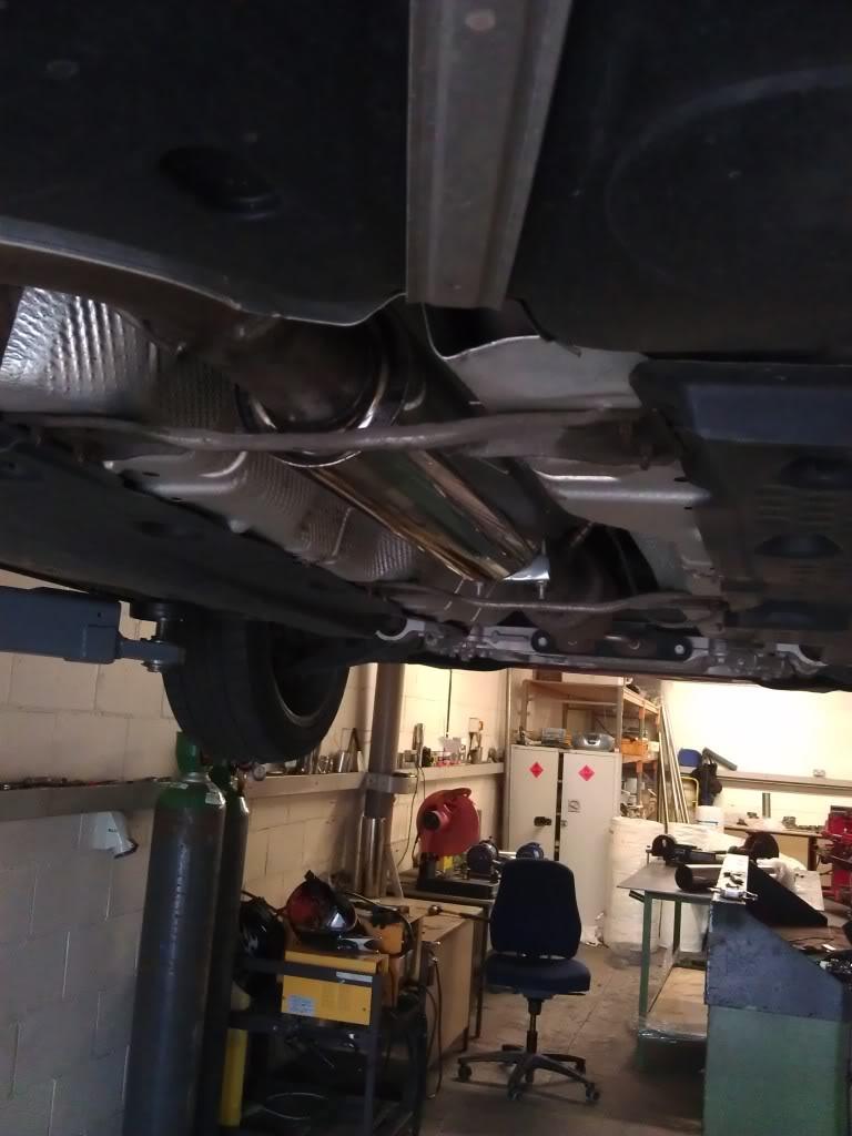

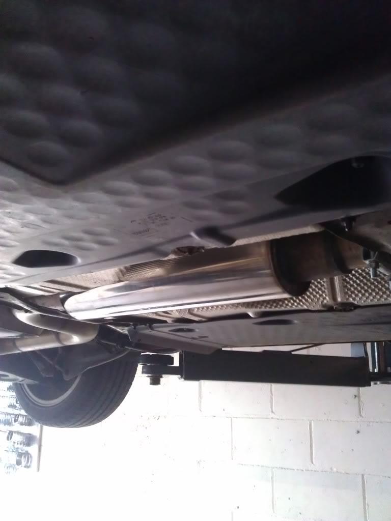

Firstly the exhaust was a bit too loud for my tastes as it was basically a straight through cat back stainless system with a rear back box so I went to a local exhaust place called pipe dynamics and had them weld me in a centre silencer.
Sorry about the pics in this whole post as they were all taken with my phone.
It's taken the drone away but still has a wee bit of noise to it to keep me happy.

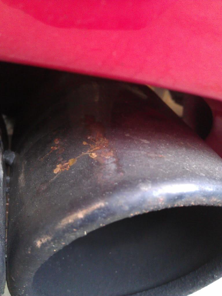

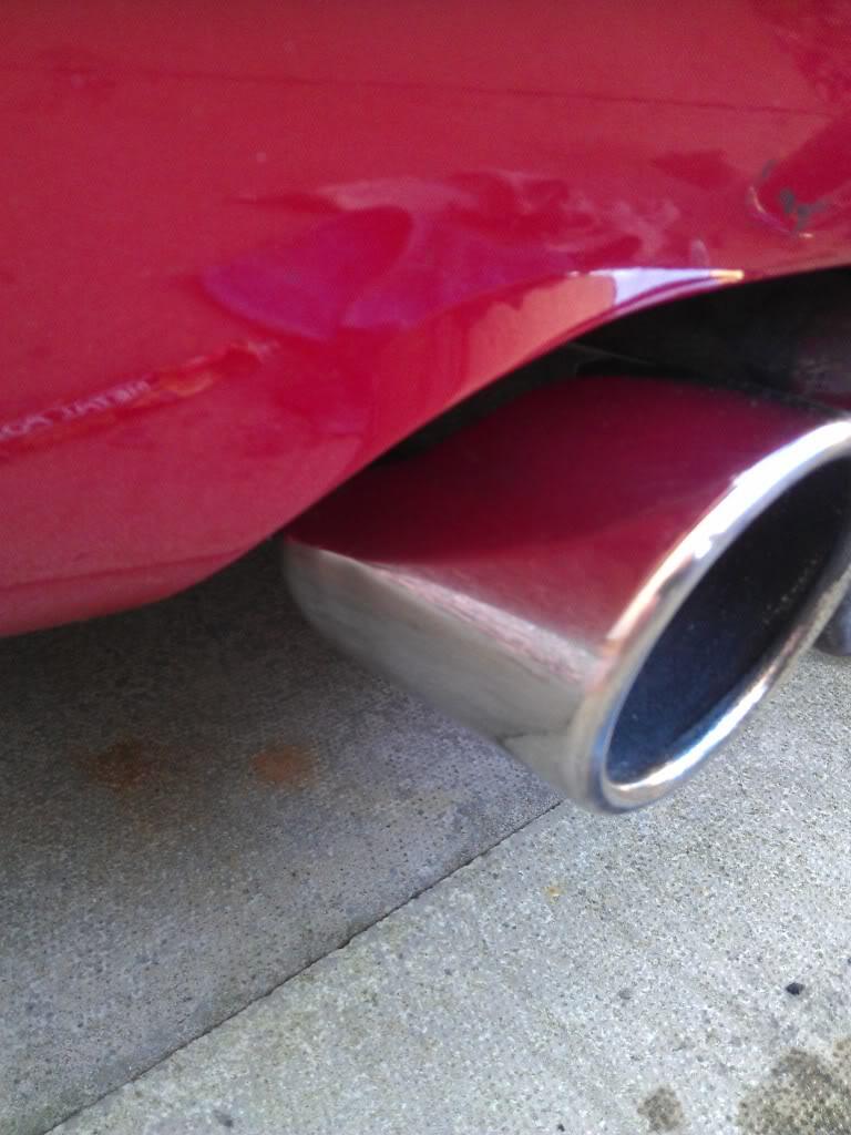

When I got home I gave the car a bath and cleaned up the tailpipes too as they were in dire need of it.
Not finished here but you get the idea

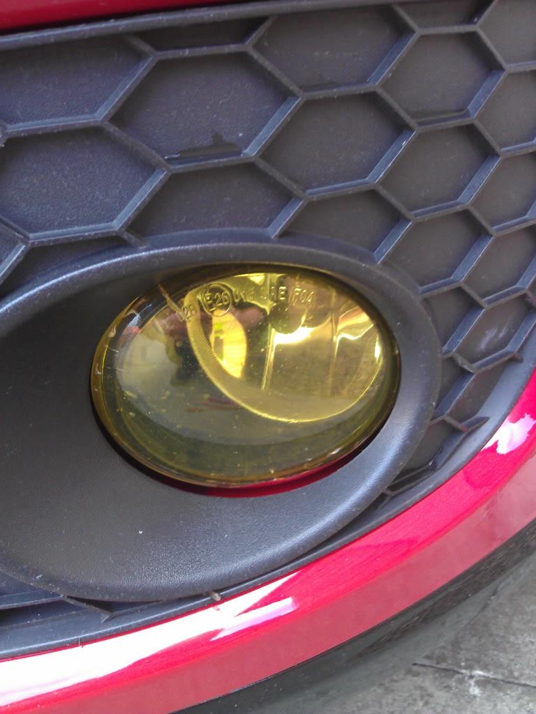

I also removed the yellow laminex from the front fogs but realised after it I quite liked it. I'll possibly smoke them in the future.
Before
After

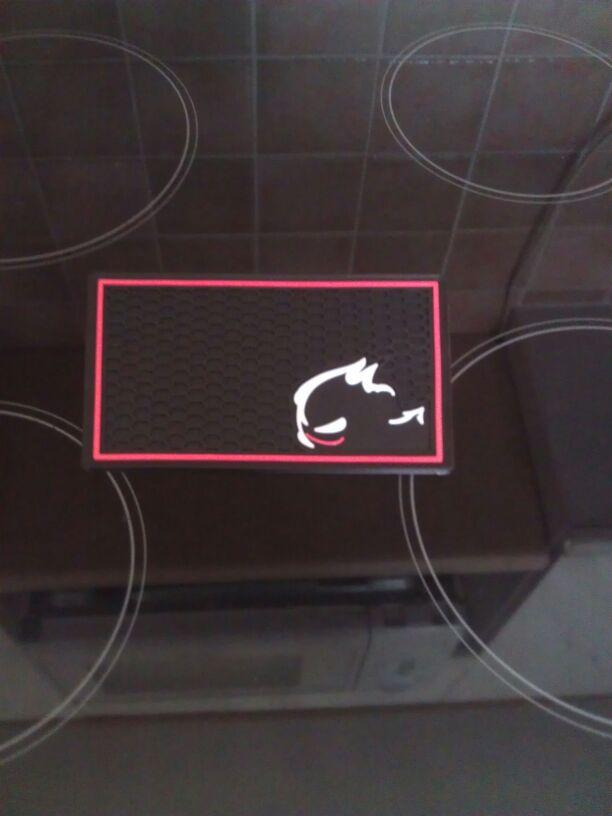

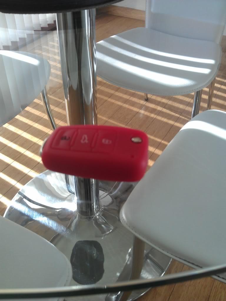

I also got a few wee trinkets that buy cause you NEED them when you get a new car.
Red silicone key fob cover
Fast mat

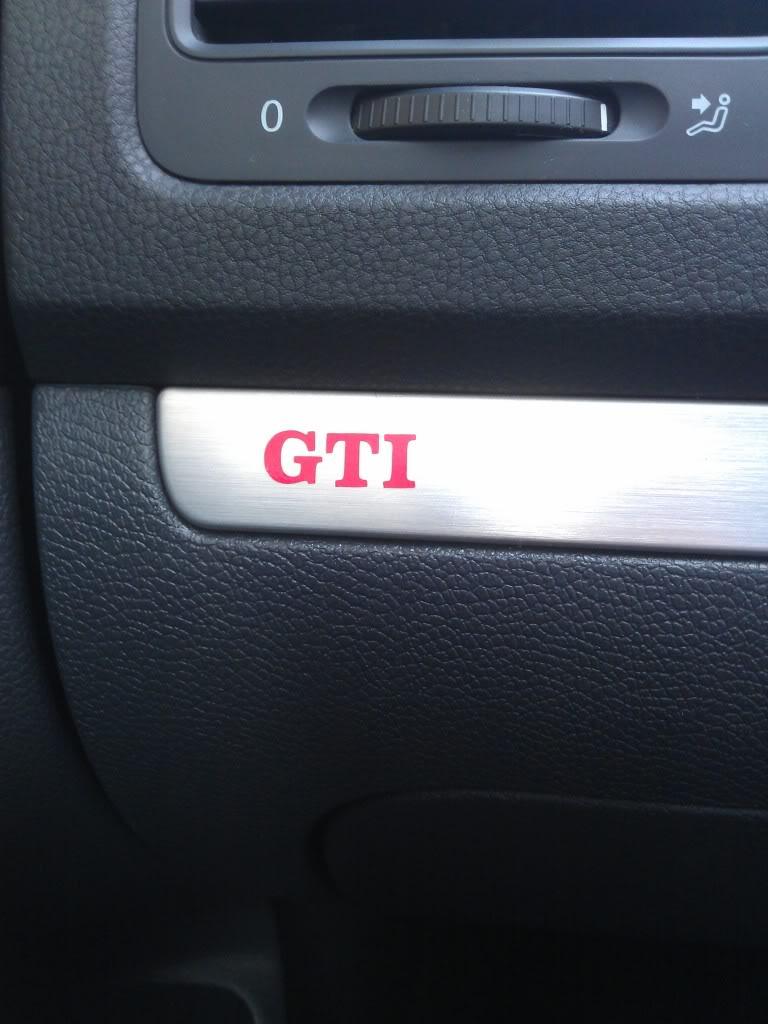

And GTI sticker that I put on the passengers side of the dash trim.

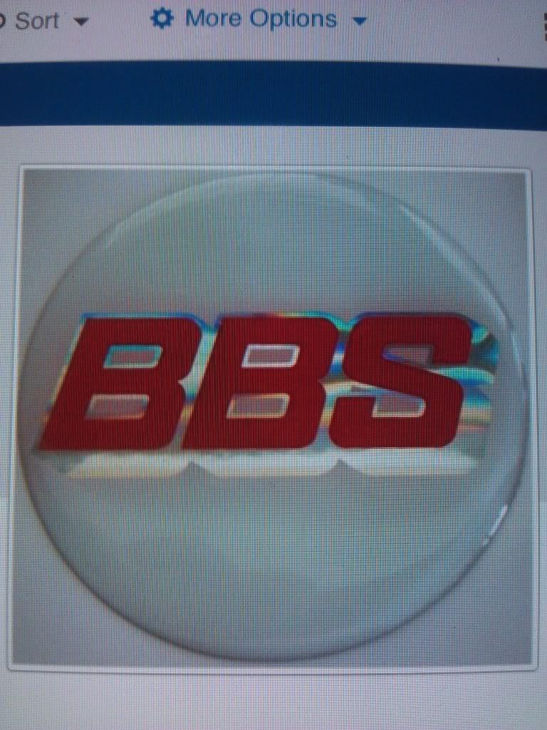

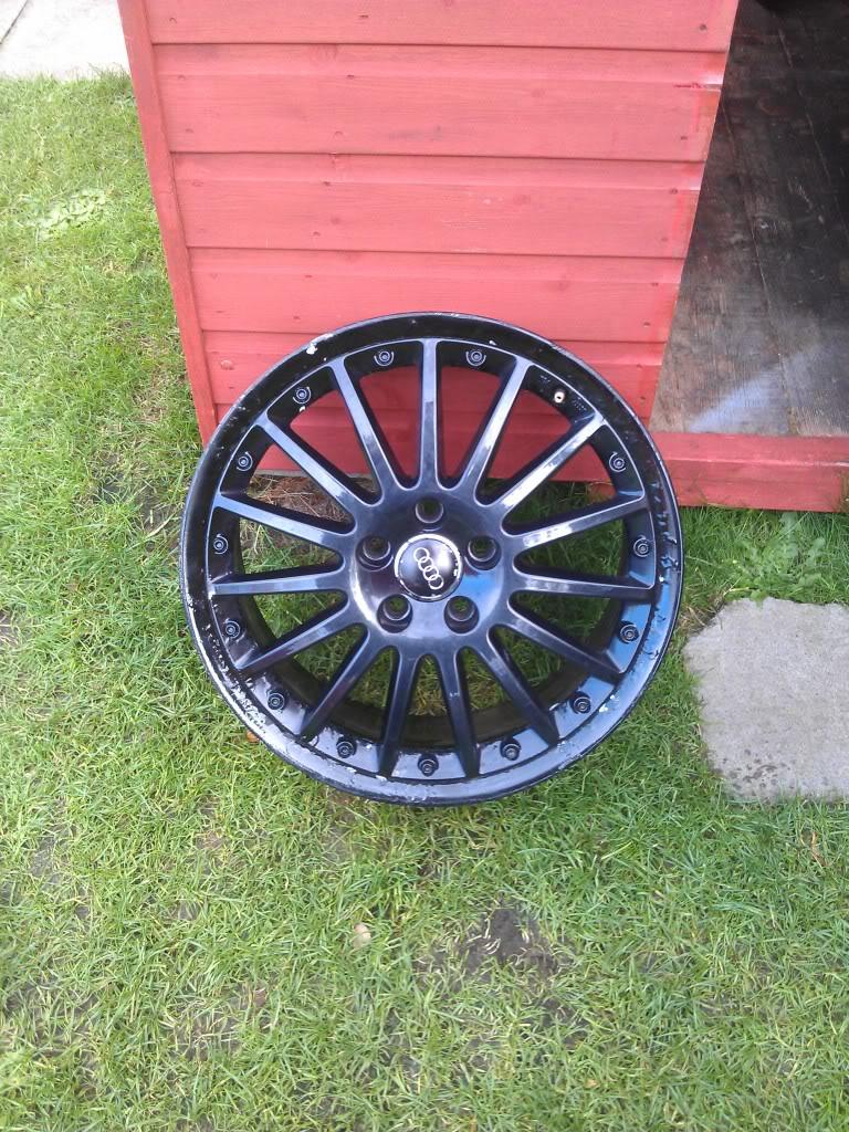

Now comes the fun parts. I've bought a set of 18" bbs speedlines that are in a mess cause they were badly rattle can painted before. They're straight and the lips are rash free so they'll come up fine. They're in the powdercoaters split down and ready to refurb in silver.
I've also bought a set of four Vredstein ultrac sessantas in 225 40 18 ready to go on. Allong with (sticker) bbs centres that I'll put on a set of flat centres I've yet to find.

Nice progress dude, coming along nicely. Them wheels will come up nicely with a paint, you going with polished lips?

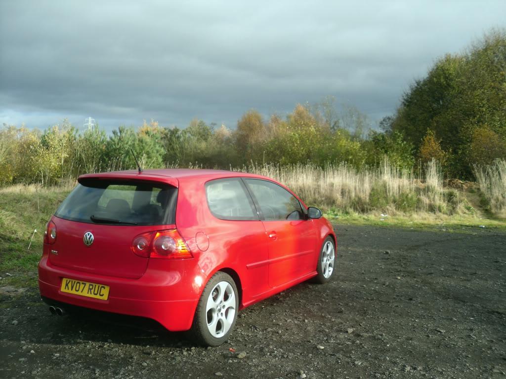

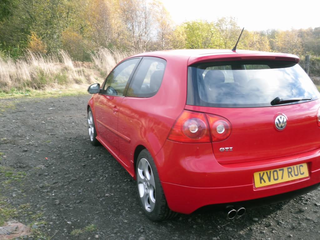

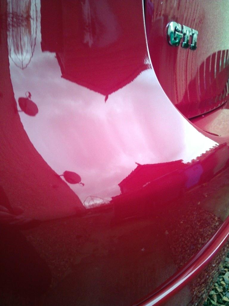

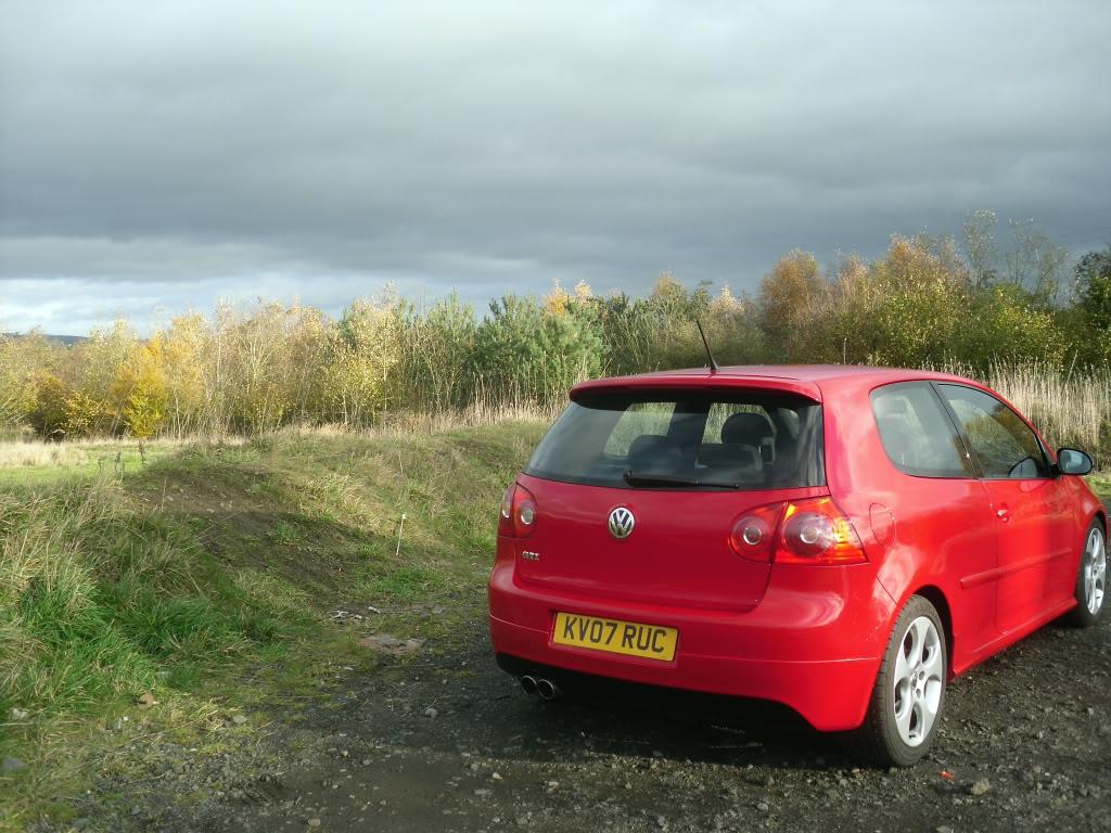

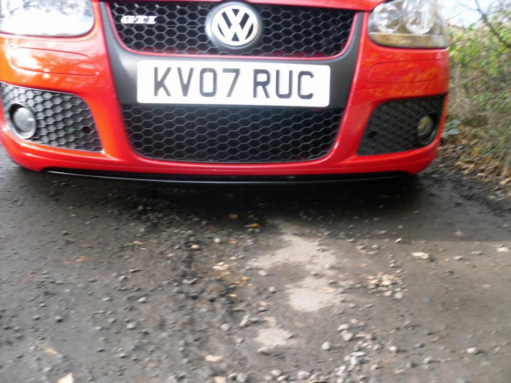

Well I got the car back from the bodyshop last night and they've done a cracking job on the colour coding.
I ended up getting front and rear bumpers removed and fully painted along with the side skirts too. The black bits are done in Satin black as I asked and the finish is spot on.
Anyway, here's some pics.

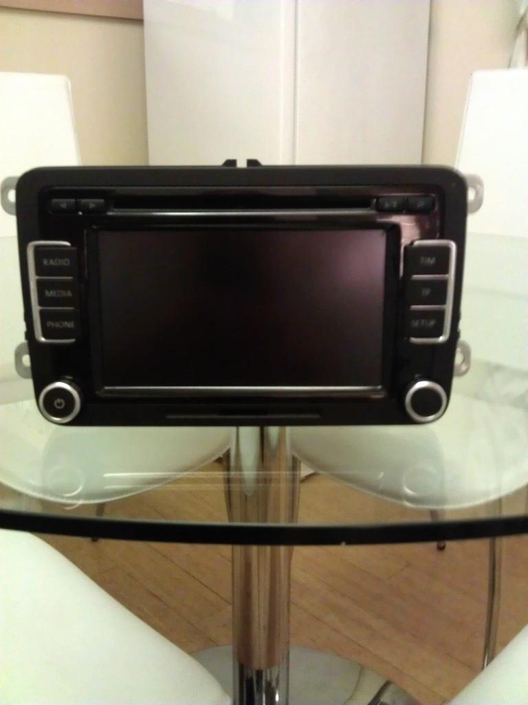

I went to Kinross last night and bought this from Doig90. Cheers bud, hope your rns turns up soon.
 It's an Rcd 510. I've bought an mdi so I'll have full control of my iPod from the headunit, I'll also have to get a new can gateway coded and sent out to prevent battery drain.
Wheels should be ready any day now. Really starting to feel like its my car now. :)

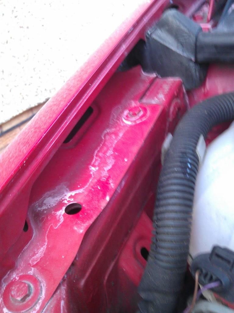

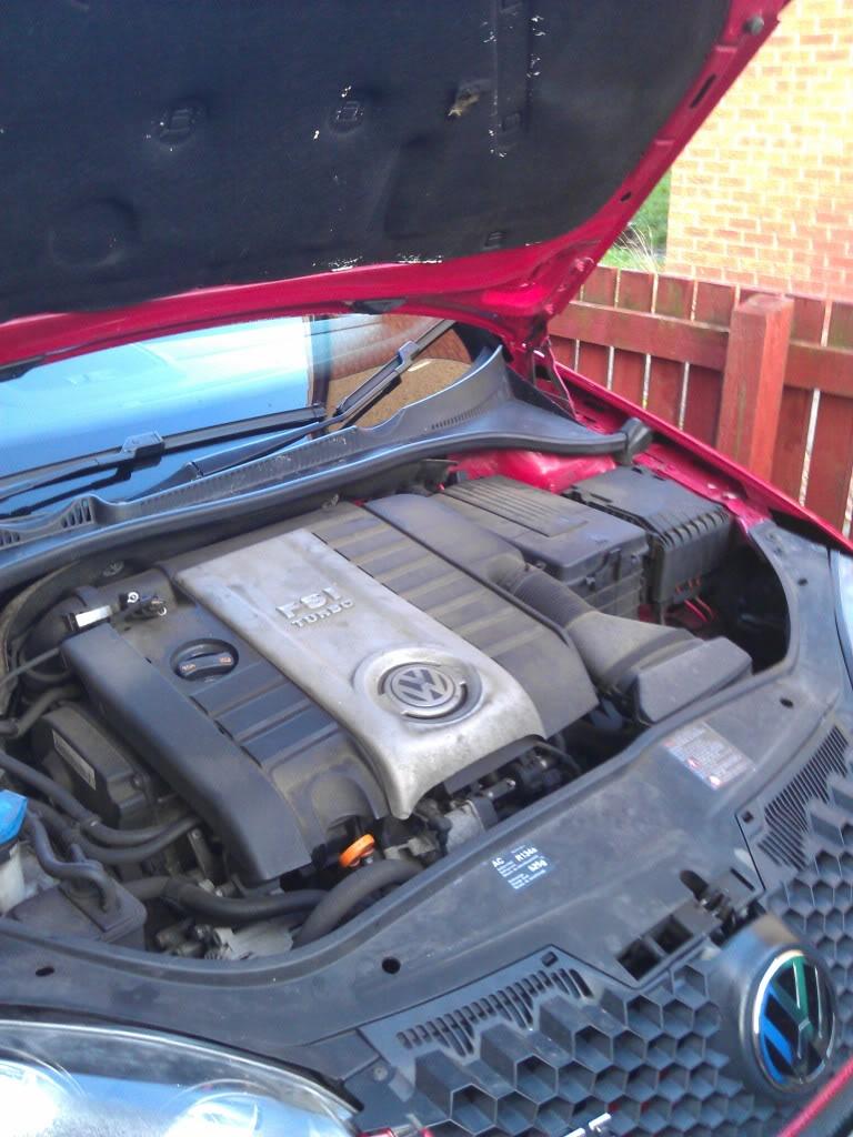

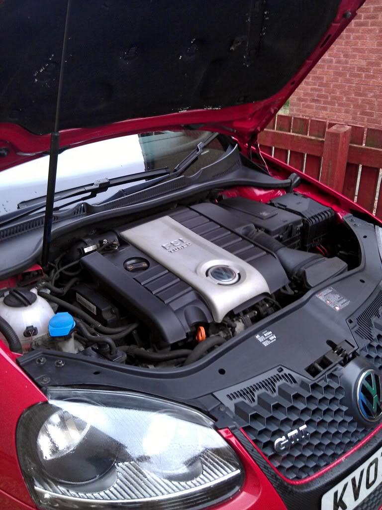

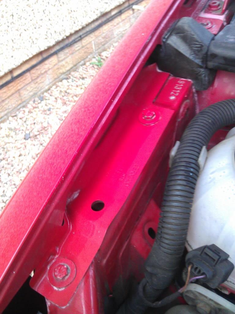

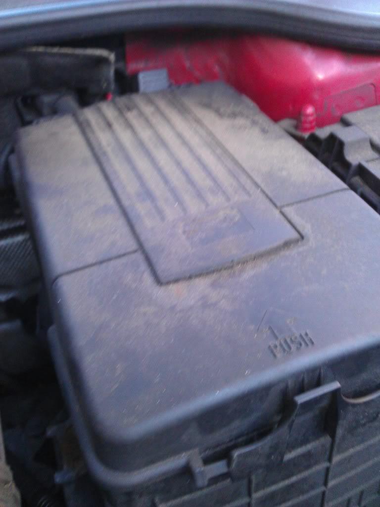

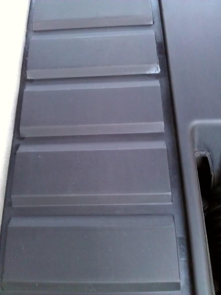

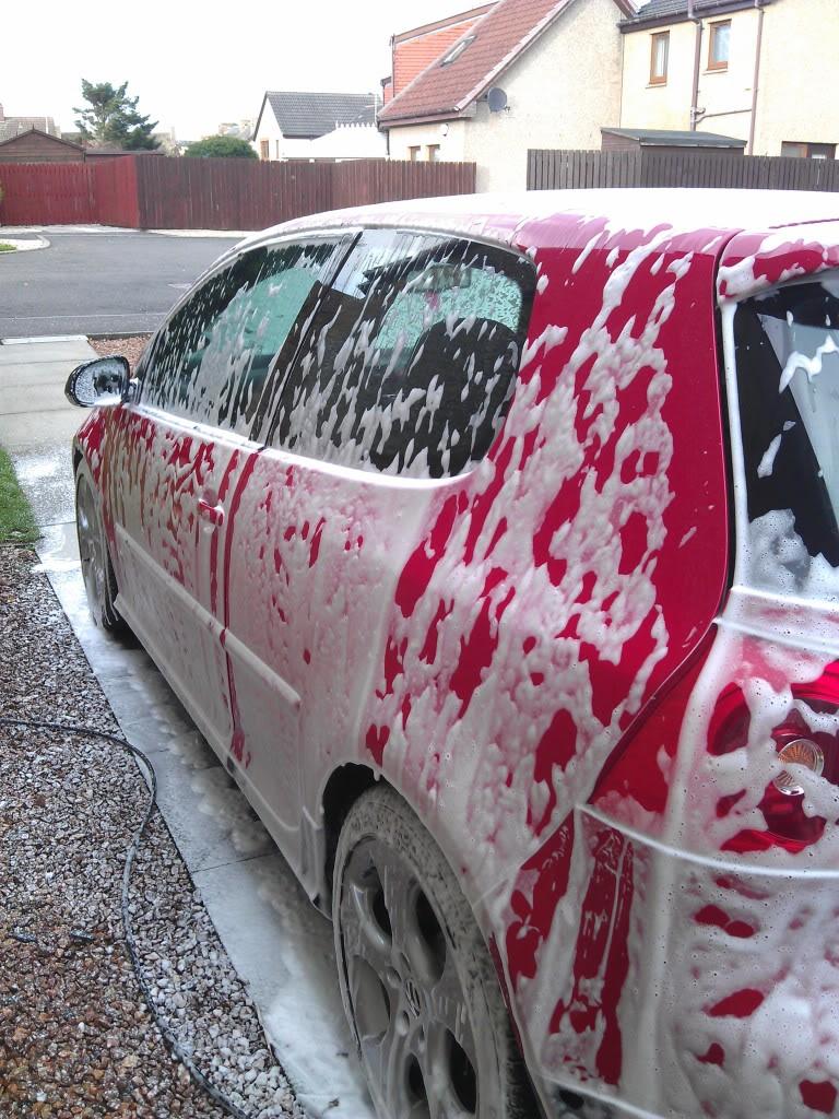

Was checking the fluid levels today and couldn't bring myself to close the bonnet without having a wee clean as it was thick with fine dust and general grime.
Here's a few wee before and afters.
Mostly dried snow foam here
It's far from perfect as my back couldn't handle any more but a wee brush and wipe with apc has freshened it up.

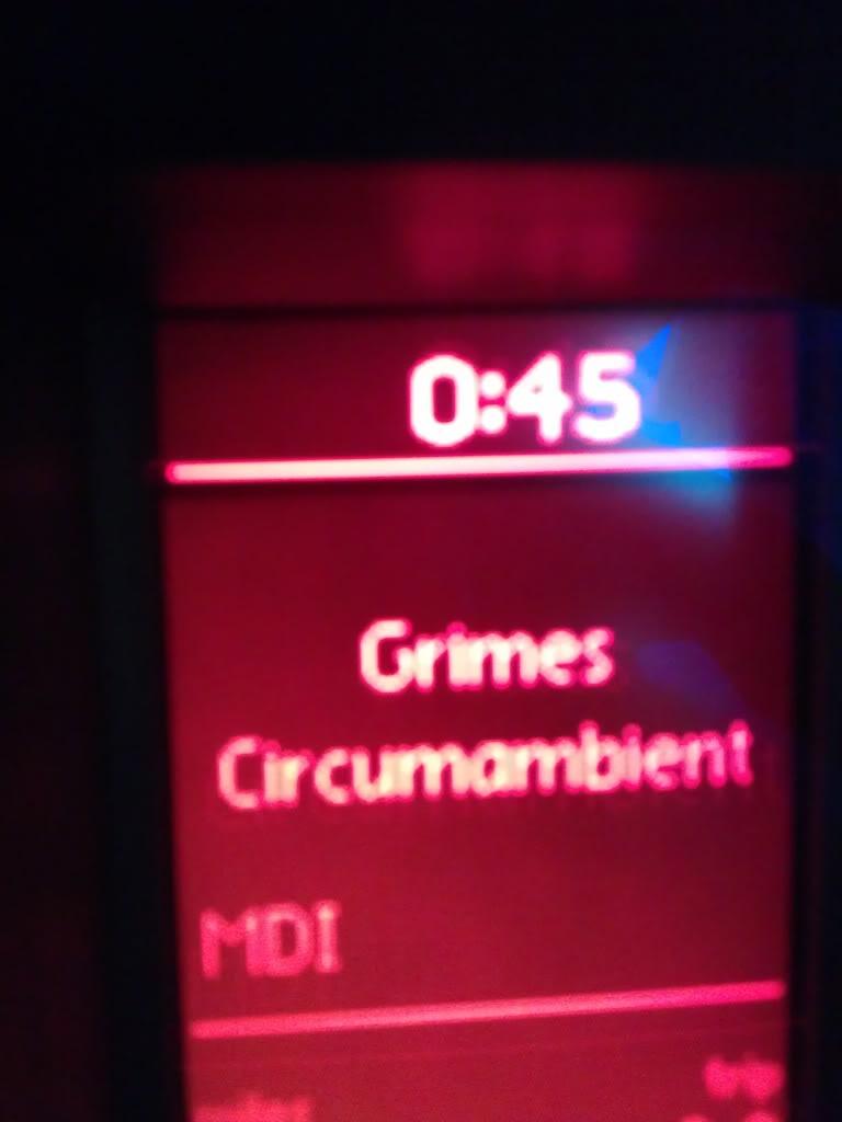

Right, next on my hit list was a double din headunit so I purchased and rcd 510 off Doig90
Fitting these to any car older than 2008 causes battery drain so I had to order a new CAN BUS Gateway, I ordered and payed for this yesterday from Eddie NL with the spec of my car and It was delivered along with a plug in and play modified loom for the mdi unit I'd bought to have full control of my iPod through the headunit and it also displays the track playing on my highline display, it's fully functional through my multi function steering wheel too. Must say I'm very impressed with Eddies knowledge and the service he supplied.

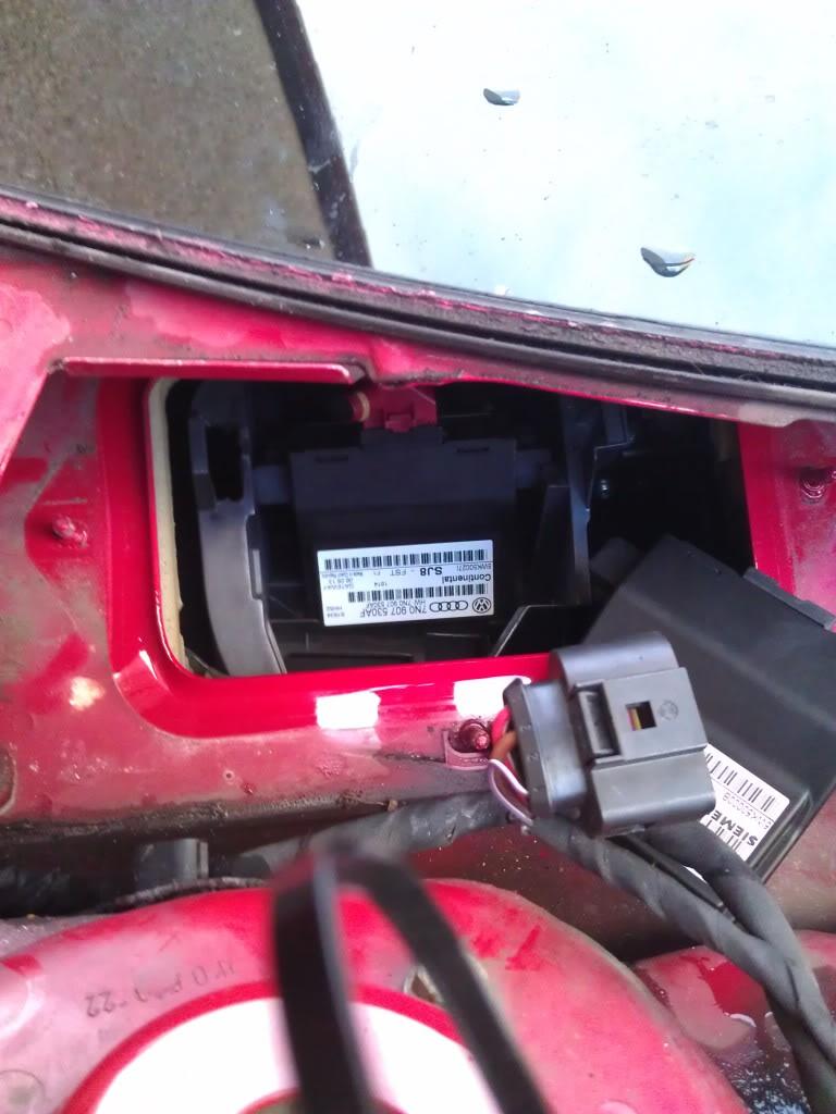

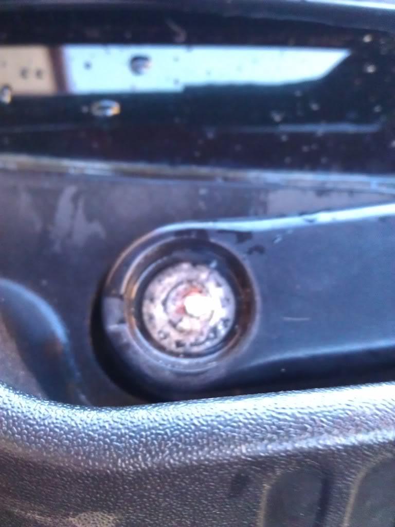

Right so onto the fitting. Can bus gateway first.

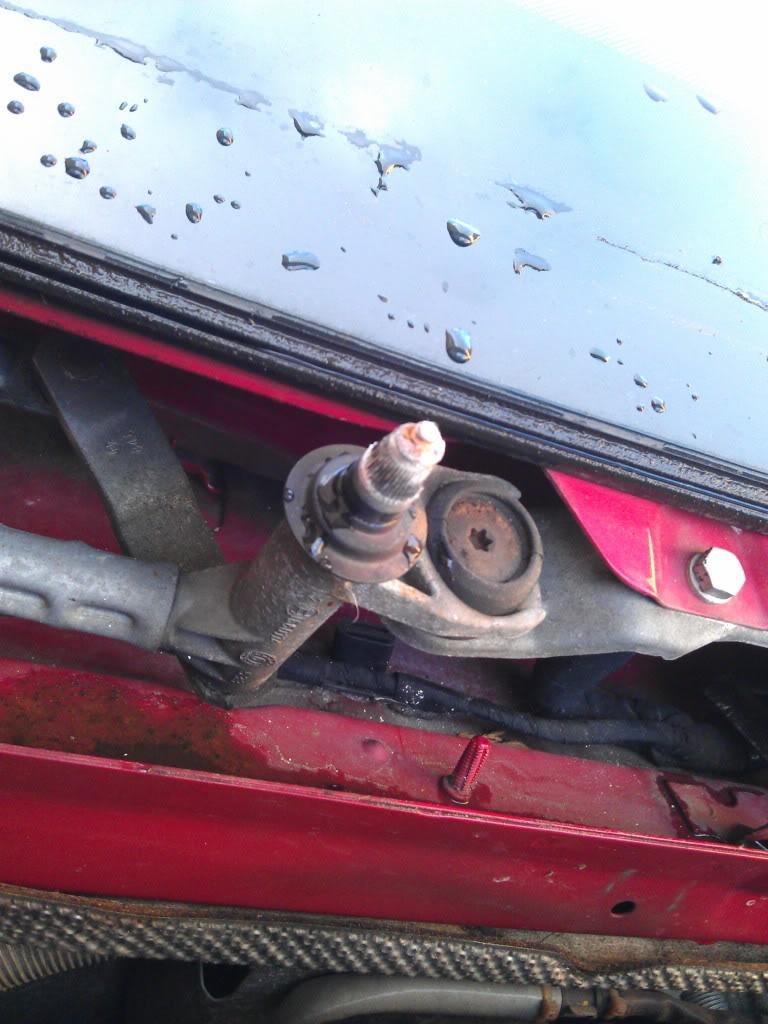

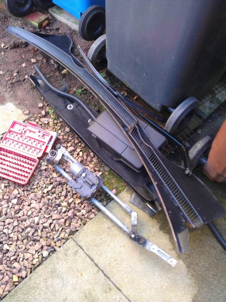

First step is to remove the windscreen wipers. And here came the first problem. A bolt had obviously been sheared before and replaced with a 10mm threaded part instead of the usual 13mm (I think it had been welded onto the sheared thread) first gentle turn and yup, you guessed it, it snapped.
Can't do anything about that now so, carry on stripping parts. Wipers, wiper motor and a few trim parts.
Which lets you get to the CAN BUS Gateway.
Swap that sucker for the new one and refit parts.

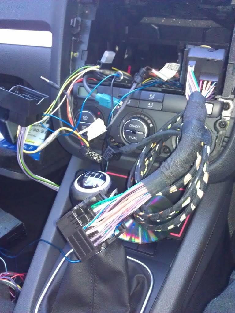

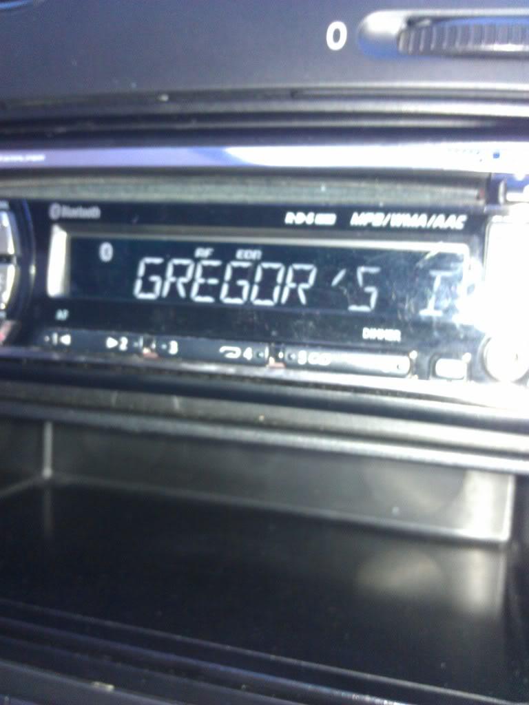

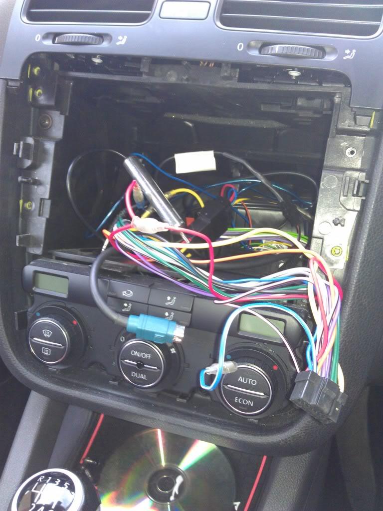

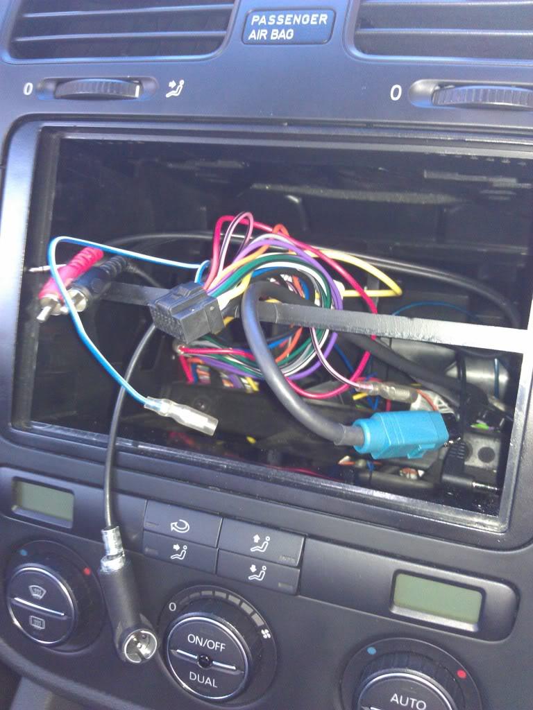

With that out the way, onto the headunit. The one that was in it was a cracking Alpine one but I wanted an oem double din. So, out with this.

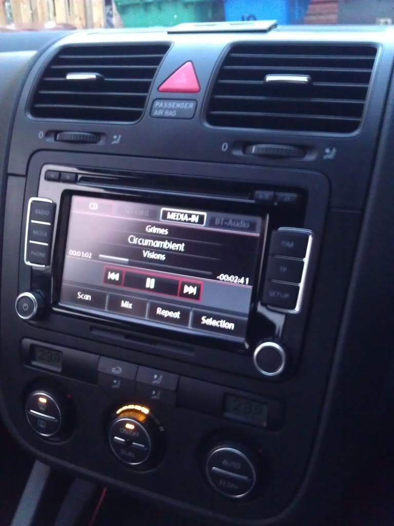

And in with this.
Ps I got it sitting flush.
Happy days everything works perfectly except as i was sore and it was raining i rushed it and I forgot to reconnect the wiper motor so I'll have to take the wipers and scuttle off again  :laugh:  :headbang:

Thanks for sharing this with me bud!.. where did you get the yellow fogs from? I quite like them LOL
