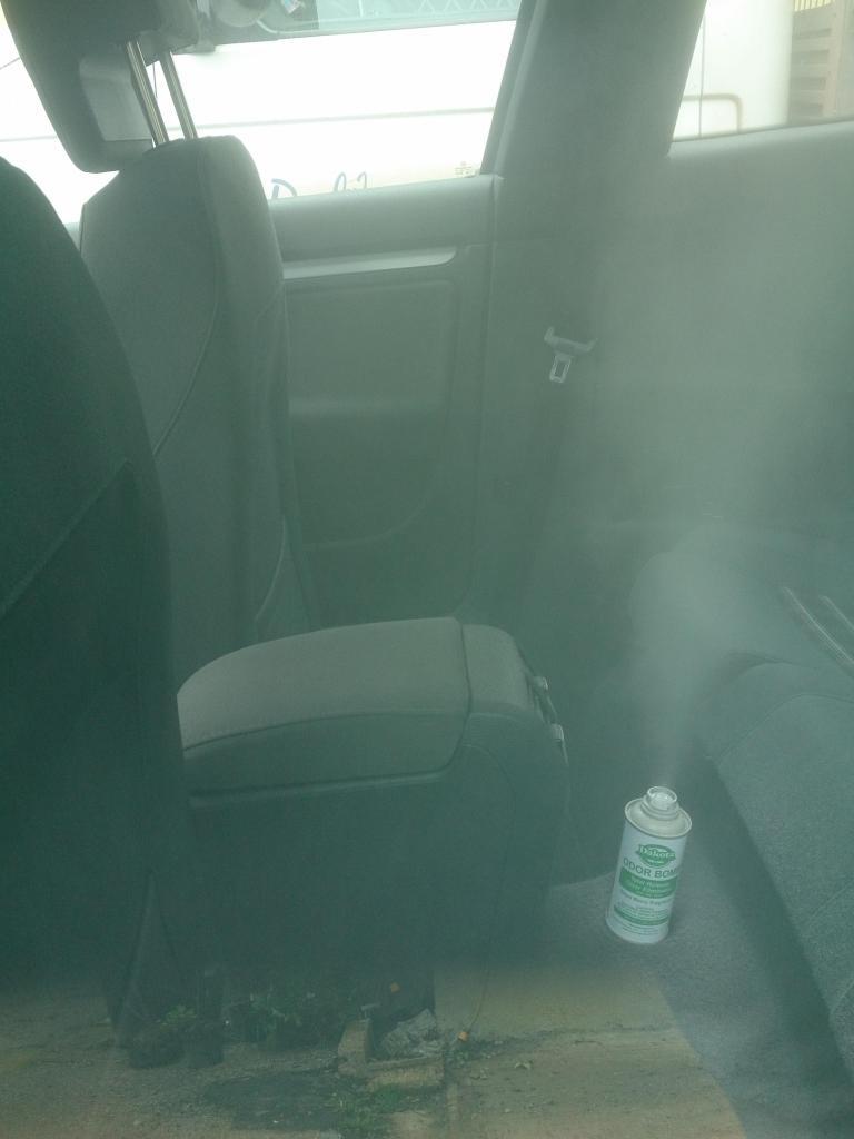

Well I'm mainly aiming to get it all running sweet as a nut mechanically wise and also a better environment to be in with the smells from previous owners dogs.
So today, my Odor Bomb arrived, used these quite a lot on my previous car because it used to leak often and caused dampness smells. Very much highly recommend these. For people not knowing these products. It practically eliminates any foul smells in the cars fabrics. Various scents about, just eBay Dakota Odor Bomb. Position in the center of the car for maximum coverage. Push nozzle right down, it locks. Close all doors and leave to settle for 12hrs. Then open all doors to vent it out. Hoover whats left about, its only fluids.

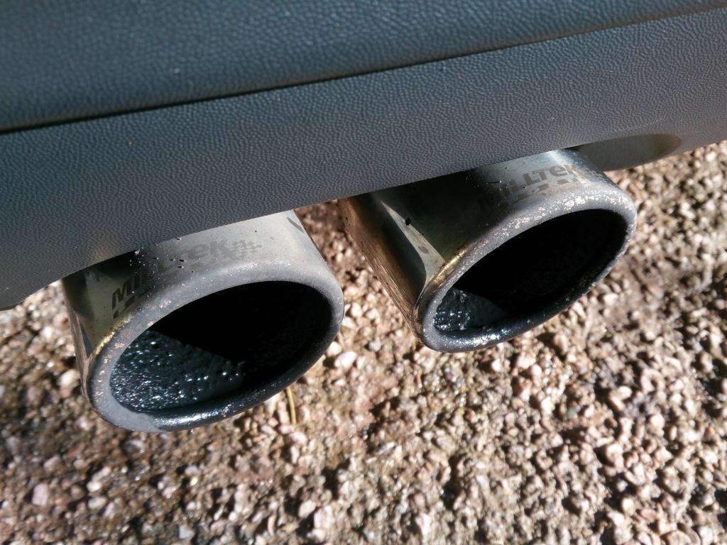

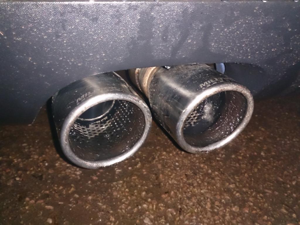

Also turned up today was my drill attachments, circular wire brush type thing, like a bottle cleaner. I wasn't happy with my exhaust being covered in soot and corrosion. So gave it ago and it worked very well. As you can see below. Sunday hoping to get my headlights in, wanted to fit them tomorrow but I've been told Im driving to Bristol for crimbo shopping. Good excused to clean out the exhaust etc etc.

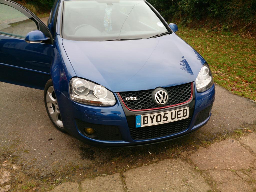

I've only just fitted my headlights today, did try the other weekend but couldn't get the indicator on N/S to work. Found out today was the bulb holder, the Positive and Negative was touching. Altered that and all is good! Didn't do a DIY as it was pretty simple. I'll do a mini one if you would like me too.
Lights are plug and play, they all work fine with Autolights and See You Home functions too. No errors if you buy the right kit. My friend does the kits.
Web - http://www.car-mod-shop.co.uk/
Facebook - https://www.facebook.com/pages/Car-Mod-Shop-LTD/238041269594003?fref=ts
Front bumper is held on by...
- 5 Torx screws in each arch.
- 9 Torx screws underneath. (Think there is 9? But all are easily seen)
- 4 Torx, 2 normal screws for the grill. (Open bonnet, visible are 2 Torx next to the headlight units. 2 screws under the registration plate then gently pull off grill. 2 Torx screws you see on the ledge)
- Then pull bumper forwards from the arches first and place gently on the floor BUT WATCH YOUR FOG LIGHT CABLE AND HEADLIGHT WASHER JETS THATS STILL CONNECTED. You will have enough room to take out the headlights as the picture will show.

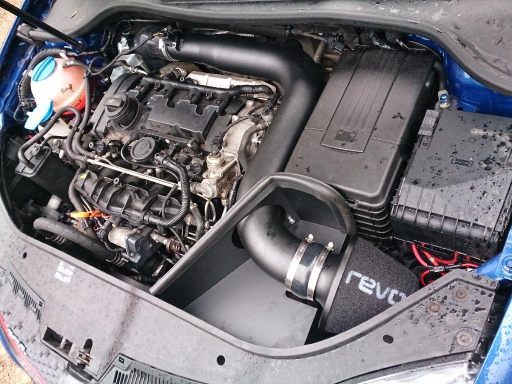

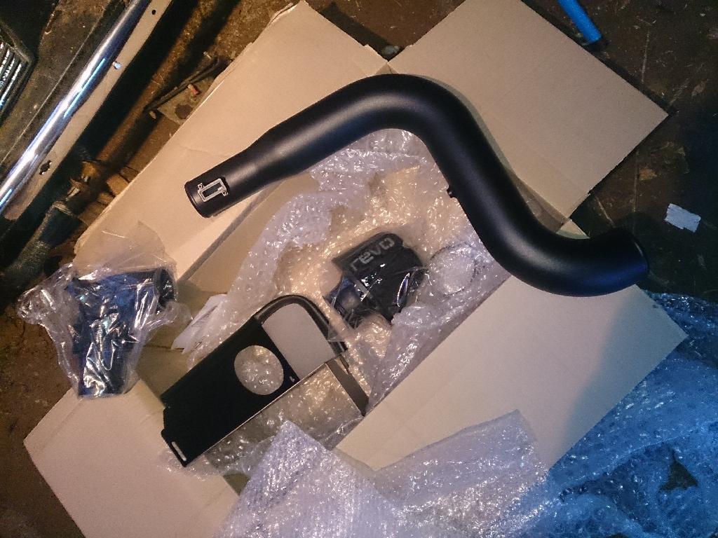

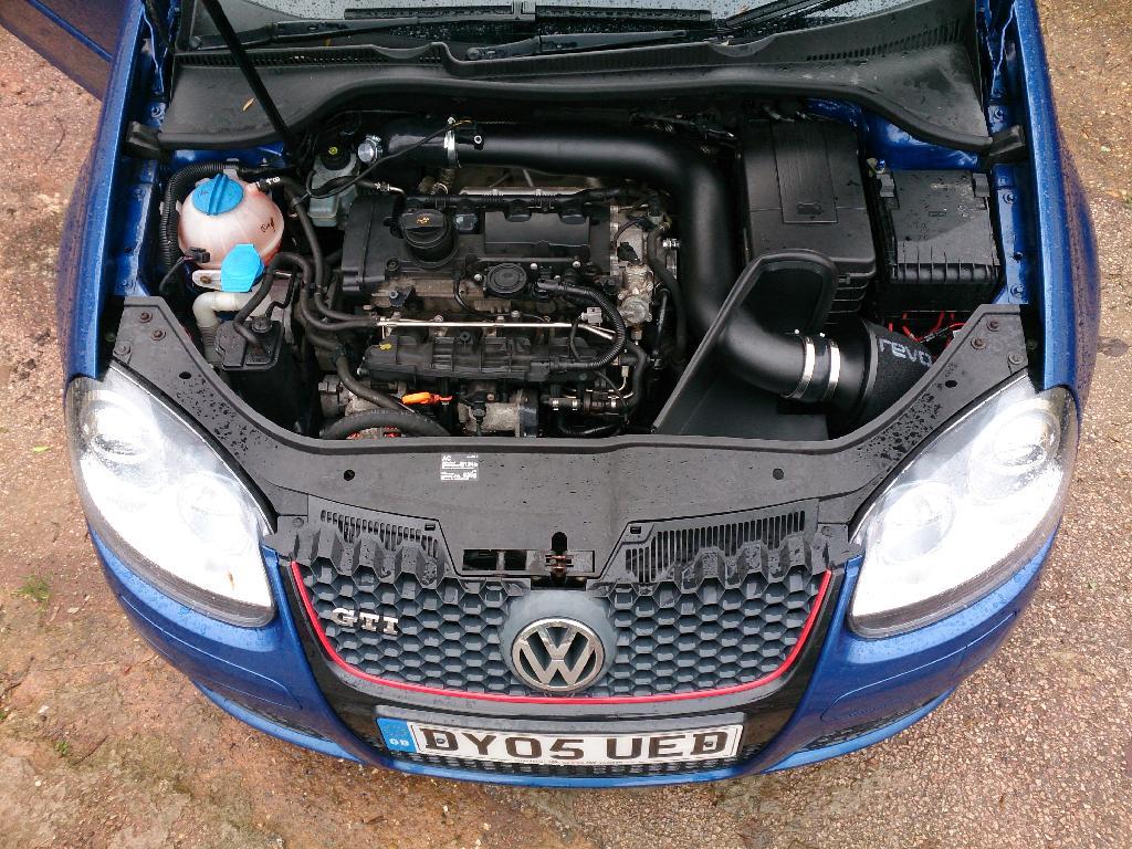

But order myself a new toy as the noise factor from the front was lacking. So bought the Revo High Flow Intake System. Was a straight forward but kinda hard work. Noise has been a massive improvement, can hear the spool up and let off.
