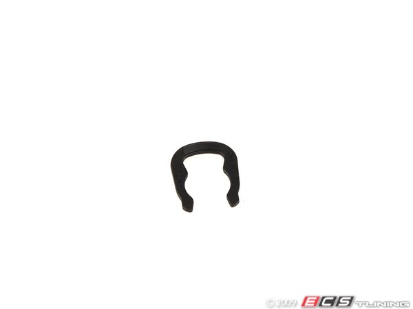

Just my 2 cents but on our cars there are two coolant temp sensors!
One is below the intake manifold and I'm assuming this is the one you changed. The other is below the vacuum pump (battery side of head). Unclip it, clip looks like this
Pull it out, and put the new one in. There is an O ring (N90316802) on the sensor which ideally should also be replaced as well before putting the clip back.
