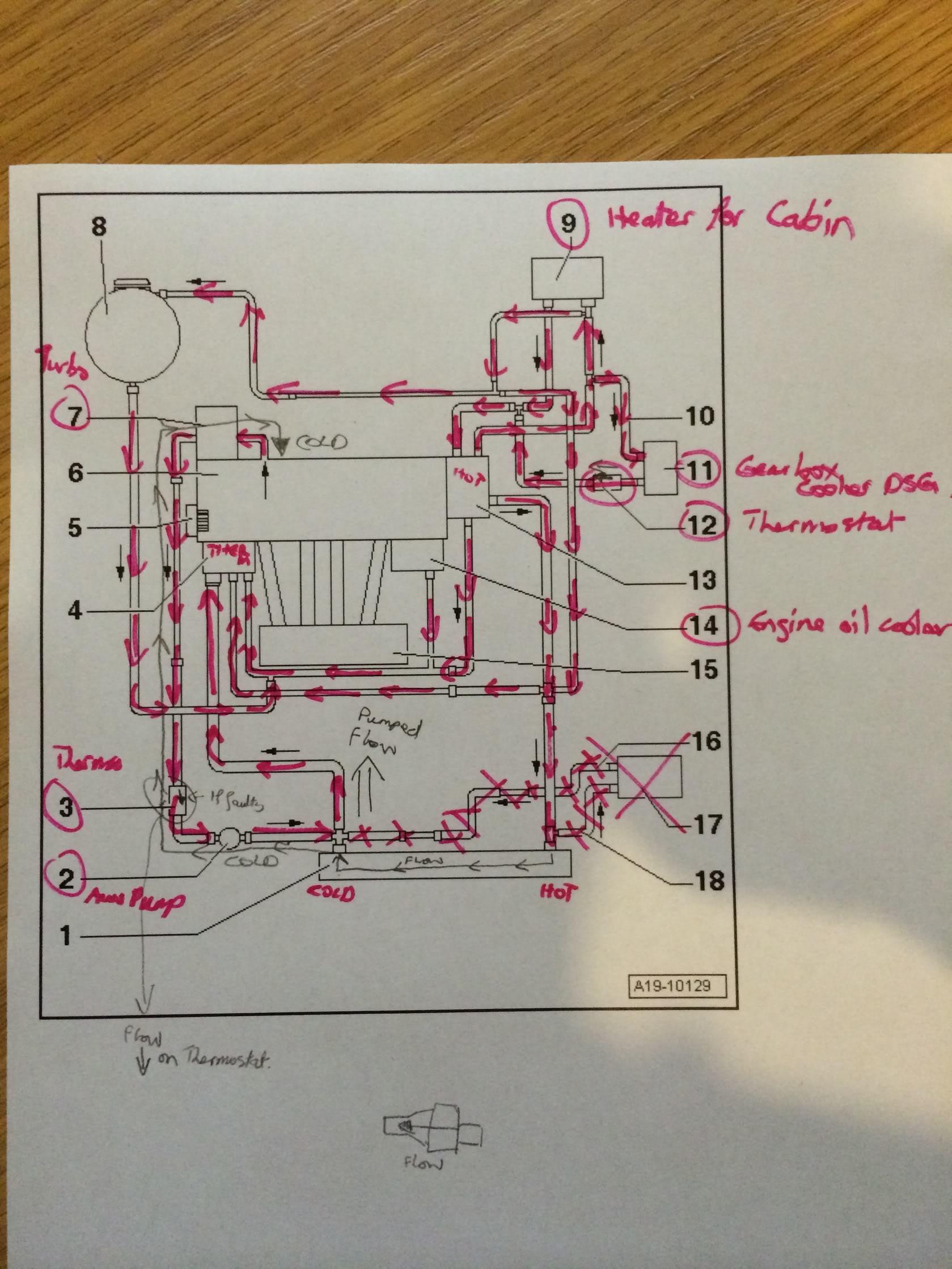

Ok. Can someone check my logic on this diagram below?
Bottom left you can see the secondary thermostat for the turbo. If this is stuck open I can clearly see that this would mean coolant flow around the system would be bad.
The other secondary thermostat top right near the gearbox cooler wouldn't be as bad but would just slow the warmup down.
Make sense?

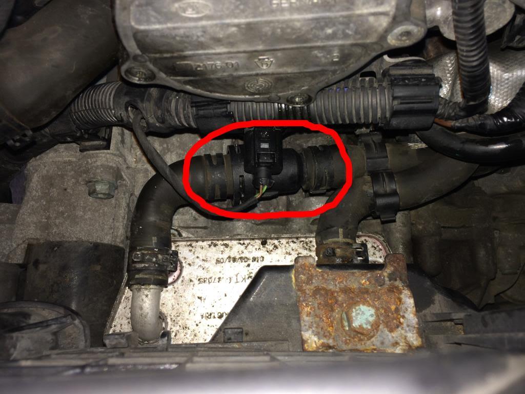

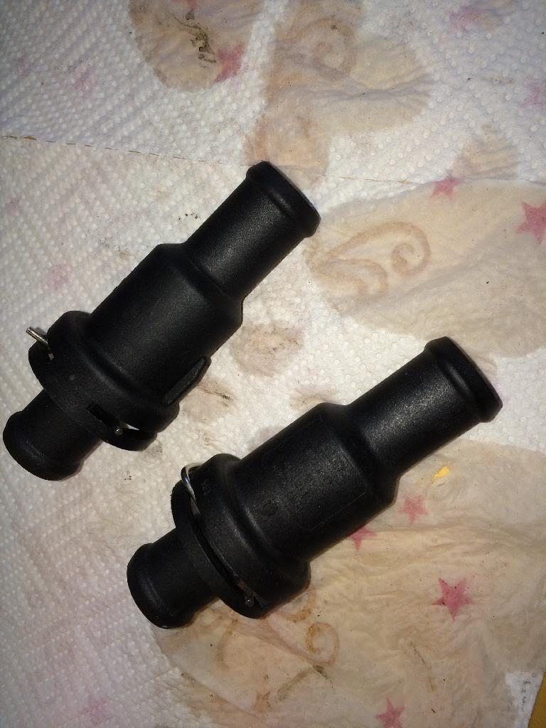

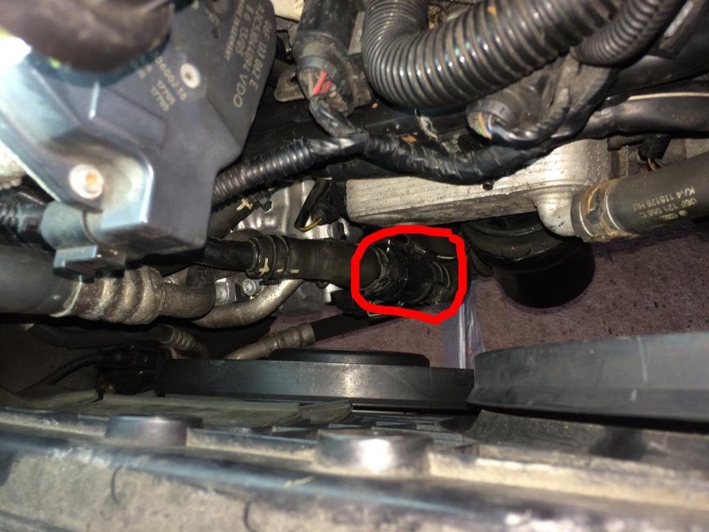

Dropped the coolant and removed both of the bypass thermostat valves to check them.
Here's the first (as my car is a DSG)
Here is the second (turbo coolant line)

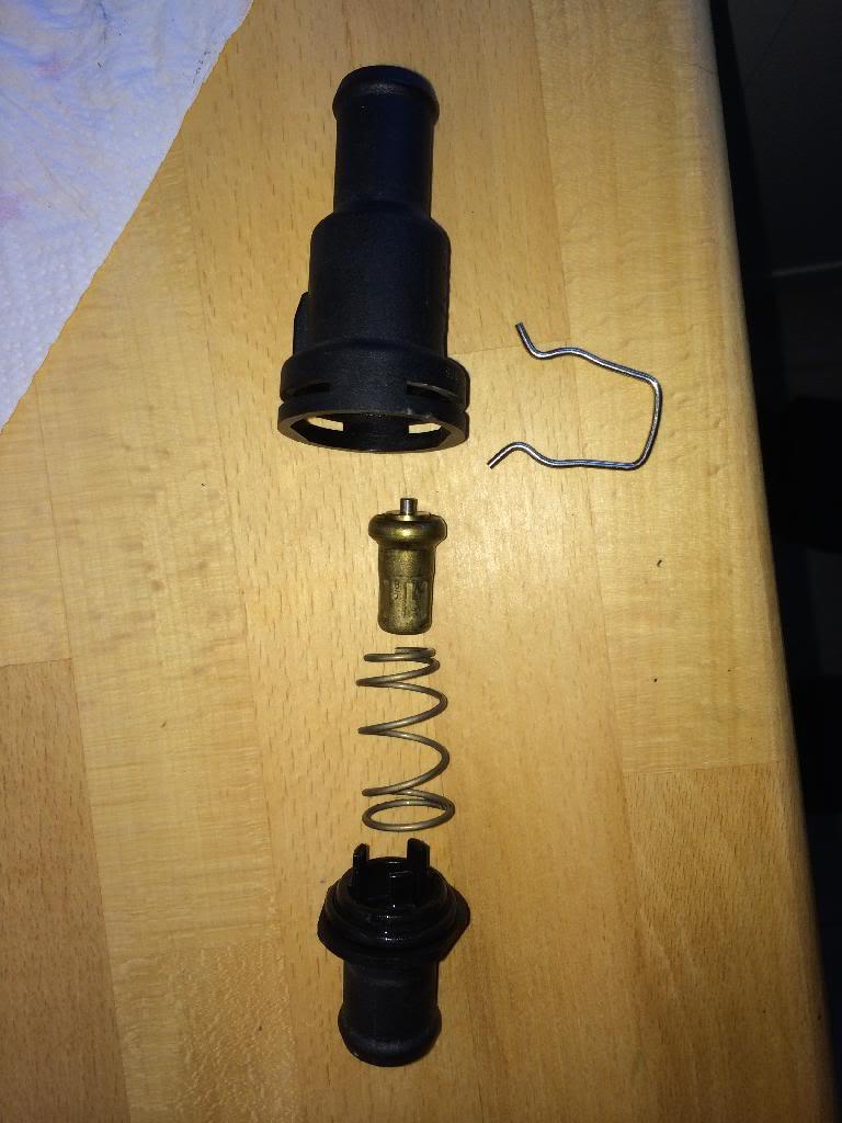

These look like this
And then opened up look like this
You will notice that there is a brass active element in these. The pin position on the one in the photo here is fully closed but i had to use pliers to get it there. Both valves allowed me to blow freely through them in both directions when I took them out of the car, clearly both brass active elements are shot.
I put the brass thermostats in a cup of boiling water and they did expand, but then when i cooled them down and tried to press the pin back in it was very stiff, way harder than the small spring would overcome.

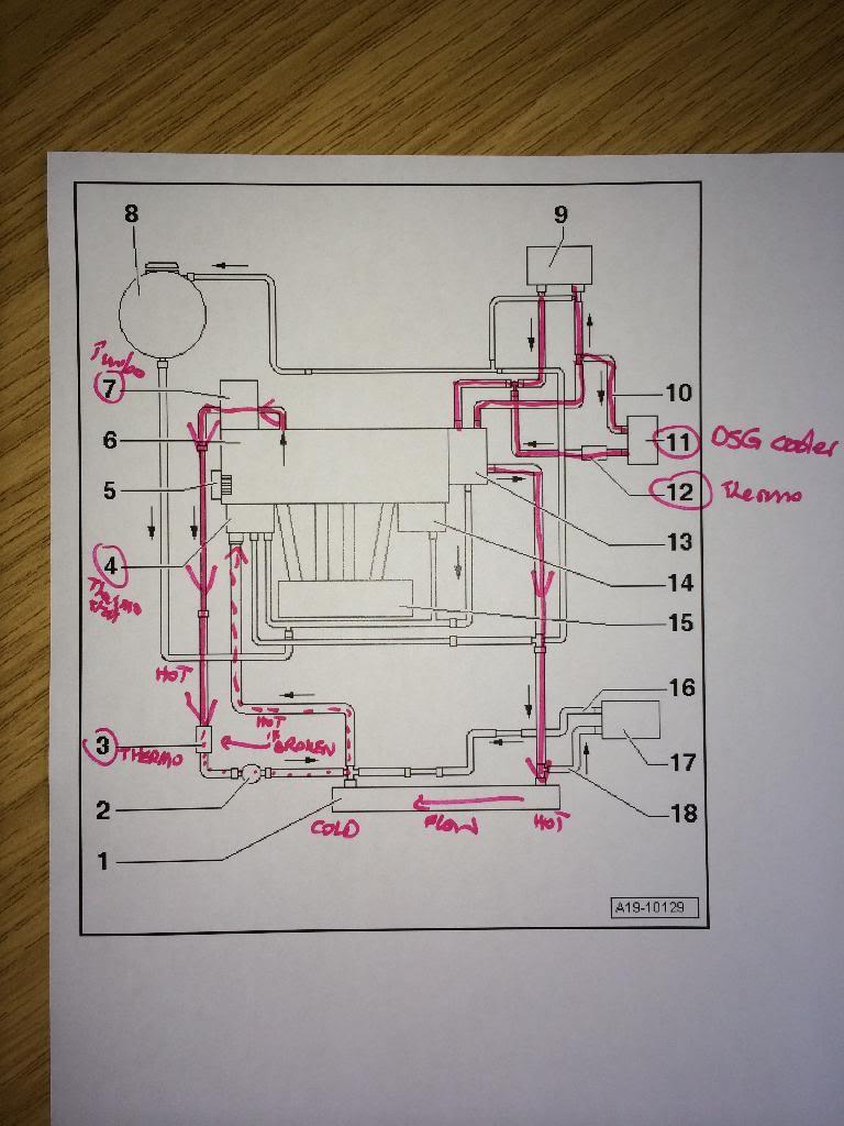

I have now worked through the theory of what is going on - see diagram below.
If (3) is faulty and just is open all the time, as the engine warms up it will pump warming coolant through the turbo and down that pipe, round to the junction at the bottom and directly into the main pipe towards the main thermostat (4). As this gets hotter and hotter it will make (4) open quicker than it should, rather than staying shut until the water from the engine is warm enough to open it.
I can also see how went sat in traffic my temperature would reach a nice 90c on the gauge (i.e. not much heat from turbo being produced and low water flow rate) but then when i pulled away a lot or drove where the turbo would be partially used it would drop down again to 80ish, because the water flowing around the turbo coolant line into the engine will be HOT, making the main thermostat fly wide open letting loads of cold water from the rad in.
