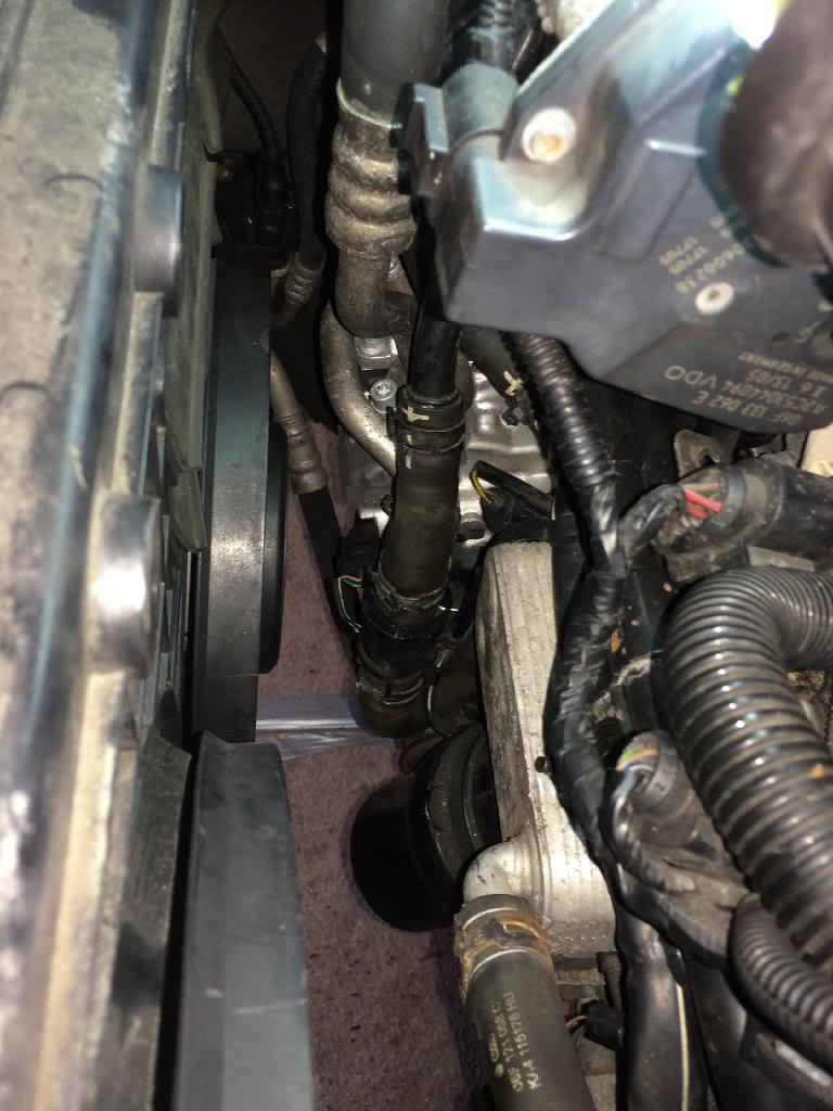

You need to take the main large pipe off the throttle body/intercooler to get at it.
Just to make sure you're looking in the right place...
It's right in the center of this photo, you can just see the top of the hose clip for it

I think we're talking about different parts.  The one I want to get at is no where near the throttle body. On you second photo, its just out of picture on the bottom left. To the left of the rad, about middle.

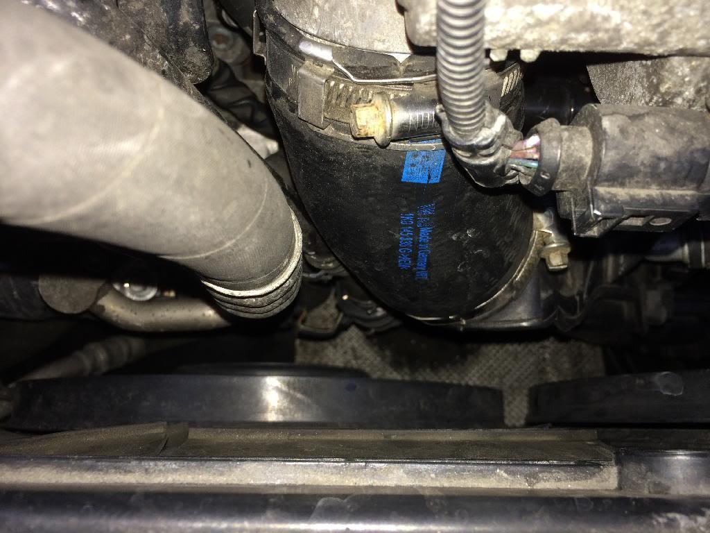

Ok I've no idea what the part is you're looking at then!
Which part do you think it is on here?
Can you see it on this photo?

« Reply #14 on: December 08, 2013, 04:36:43 pm »
