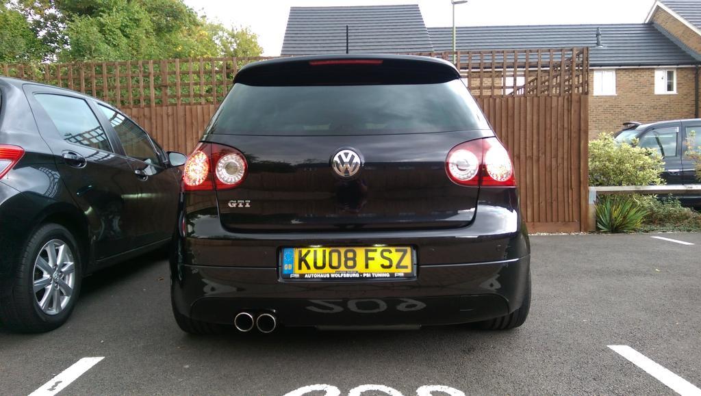

« Reply #136 on: September 17, 2014, 09:19:00 pm »
Looks well mate, what was done to your skirts, rear valance etc to prep them for painting? Did they have to smooth them?
Sorry for late reply. Yeah they had to be smoothed/prepped before they were painted.

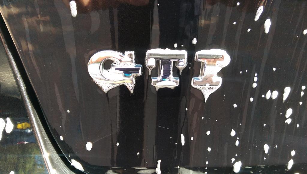

As the weather is starting to turn worse I thought I'd give the car a bit of a clean and a coat of wax.
Snow foamed with Auto Rae-chem Cherry snow foam
Washed with two bucket method and Britemax Cleanmax shampoo
Then gave a coat of Collinite 845
The finished result
